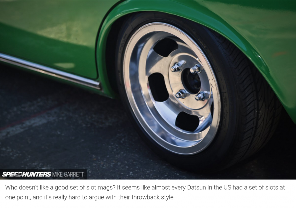

Slotted wheels may have been the most popular "mag wheel" in their day. 5 slots were most common, but every now and then you would see 6 slots. I don't know which company made the 6 slot version.
The caps might just be the hardest thing to find, if you go for a used set of wheels.
http://www.speedhunters.com/2014/10/cool-collectable-wheels-jccs/

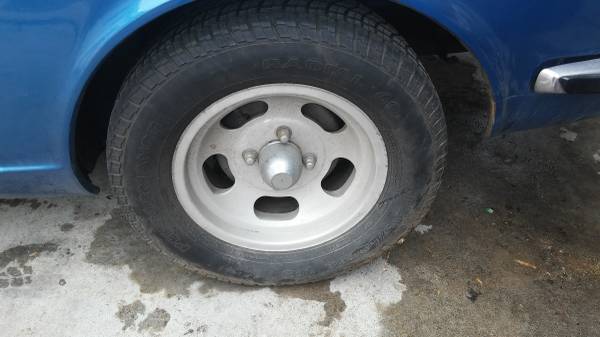

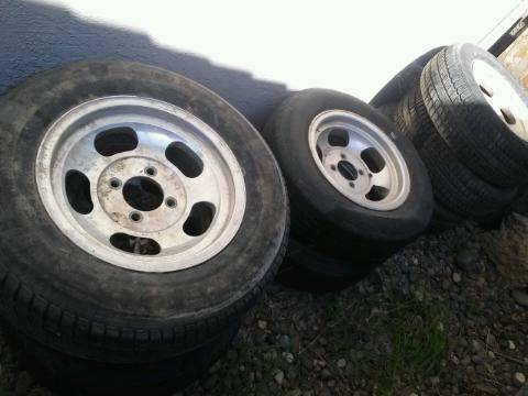

Here's a listing for a set of 4 slotted mag wheels located here in the Denver area for only $200.00 US: http://denver.craigslist.org/wto/5404271959.html
