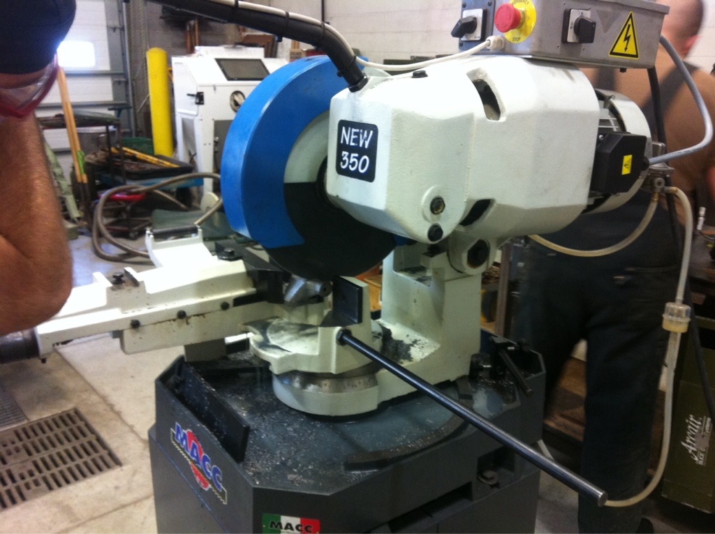

October 14, 20159 yr comment_479106 Success! Marked off at 1.78" for margin of error. On the cold cut saw... Ready for drilling out to 3/8ths... Finished after another quick sandblast and final measurements.... Sent from my iPizzle ringy dingy device.... Link to comment https://www.classiczcars.com/forums/topic/52538-whats-old-is-new-again-alternator-upgrade-options/?&page=3#findComment-479106 Share on other sites More sharing options...
October 14, 20159 yr comment_479107 Measurements... And a solid coat of Zinc Mate until it's ready for paint with the block.... Sent from my iPizzle ringy dingy device.... Link to comment https://www.classiczcars.com/forums/topic/52538-whats-old-is-new-again-alternator-upgrade-options/?&page=3#findComment-479107 Share on other sites More sharing options...

October 15, 20159 yr comment_479138 Wish it was mine... Work tools! I am very fortunate to get to use the shop! Thanks for the great tips. Looking forward to installing this in a year or two... Ps: the saw still cut fairly slow. Just being cautious. Sent from my iPizzle ringy dingy device.... Edited October 15, 20159 yr by wheee! Link to comment https://www.classiczcars.com/forums/topic/52538-whats-old-is-new-again-alternator-upgrade-options/?&page=3#findComment-479138 Share on other sites More sharing options...

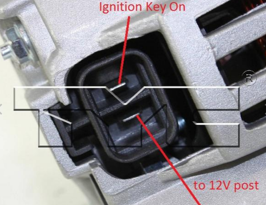

May 2, 20196 yr Author comment_574737 More updates While trouble shooting an alternator wiring problem on my 510 with yes, another similar GM alternator, wired as two wire, I have more to add on the subject.  First, I ran across another excellent reference web page that does an excellent job of describing the workings of all the GM alternator variants, and how to properly wire them. https://www.pirate4x4.com/tech/billavista/Wiring/Part2/#onewire My initial suggestion/recommendation about using the hotrod oriented 1 wire alternators from Mopac, has, shall we say, 'evolved' I've had consistent problems with them as they have a non-insignicant amount of current drain when the car is off. They kill the battery within about a week if you don't drive it. Hence I've moved on to the two wire style, where you supply a switched +12 wire to the alternator on the "F" or "I" terminal (right next to 'S') (see above link for very good explanation).  The above reference alternator has the same case style as the original nissan alternator, so you don't have to modify your mounting base. A little spacing is about all you need to do. All I have to do is remember which car it's for. I'm pretty sure its a CS130 from the 88-89 Eagle Premier. 100 amp, internal regulator of course. You have to put your pulley on it, they come with a serpintine belt pulley. These alternators have a four wire socket that accepts a plug. You can get a pico  5657-bp pigtail from your auto parts store or get one from the wrecker.   https://picocanada.com/en/view_product/5657-BP According the above link, the common practise of just jumpering the "I" (or F) terminal directly to the output terminal to excite the alternator is not the best idea. Read the details in the pirate4x4 link and you'll understand why. Edited May 2, 20196 yr by zKars Link to comment https://www.classiczcars.com/forums/topic/52538-whats-old-is-new-again-alternator-upgrade-options/?&page=3#findComment-574737 Share on other sites More sharing options...

May 15, 20196 yr comment_575525 I think that that is a Maxima or 300ZX alternator with a pulley swap. Or, Ithink that there is one or two specific years that still use a V pulley on a 60+ amp alternator. It's not a bad option. It would be good to know that actual brand of the alternator. If he is just buying OReilly Auto parts and swapping pulleys, that could cost a lot in return shipping until you get a good one. Lots of bad-from-the-box reman alts out there. Worth asking him via message. Looks like you have to do some wiring. His image shows TYC, which is probably where he got it. OR maybe he just borrows the image.  Looks like you might have to buy a plug also, maybe. Not clear. https://www.carid.com/tyc/alternator.html  Link to comment https://www.classiczcars.com/forums/topic/52538-whats-old-is-new-again-alternator-upgrade-options/?&page=3#findComment-575525 Share on other sites More sharing options...
