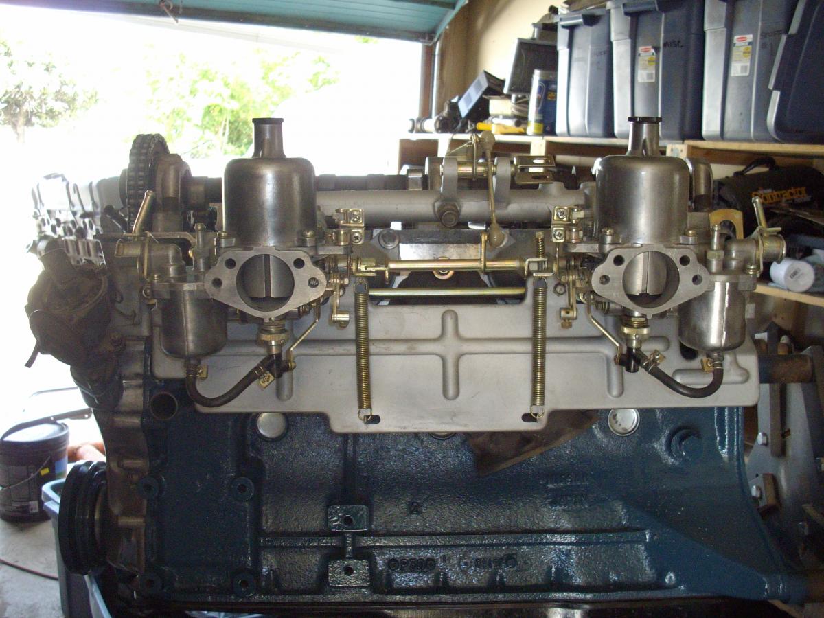

Thank you Namerow.  My car has its original engine as well.  Can you elabroate on the "spigot" you mentioned in your post?  I know there should not be any type of flex hose going from the air cleaner to the exhaust manifold as there are no provisions for it.  Below is a picture of my exhaust manifold with the carbs out of the way.

From what I have learned in the past, August of 1970 was the model changeover between the 1970 & 71 modl years.
Smog laws required the addition of carb pre-heat starting in 1971.  As you can see from your picture, there are
two bosses cast into your exhaust manifold just above the exhaust pipe mating flange.  Those bosses would have
threaded holes to accomodate the exhaust carb heat riser cover if your car had the air cleaner snorkel for a flex tube
connecting the air cleaner to the exhaust manifold heat riser cover.  Since there are no threaded holes in the exhaust
manifold hosses, your car did not have the air cleaner with snorkel for carb pre-heater.

What is that sensor looking thing in your photo located in the block next to the front of the transmission under the exhaust manifold?
My 7/70 build date 240Z has a block drain plug at that location.
Just curious if it is/was hooked up to anything, and if so what?
The temp gauge??
Mine has only the single wire from the thermostat sender----
Thanks for all the info guys!  Looks like mine was one of the last 2400 valve cover and non-heat riser cars before they switched over to the new pieces.  The switch in my block was in there when I bought the car.  My guess is that it was at one point an alternative location to a fan temp switch.  I have left it there as I may use it in the future.  You cannot see it once everything is back together so it is staying for now.

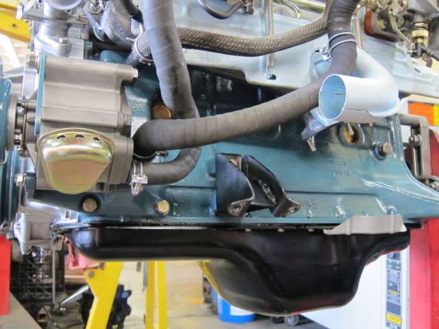

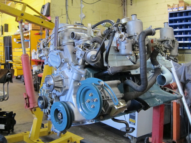

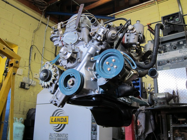

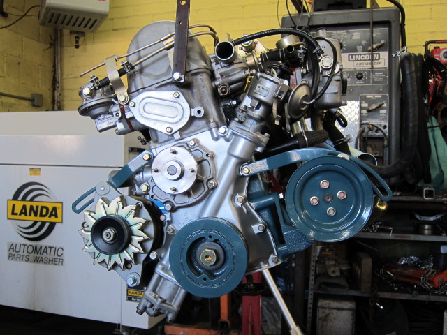

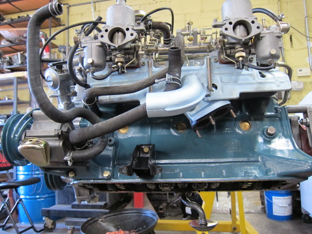

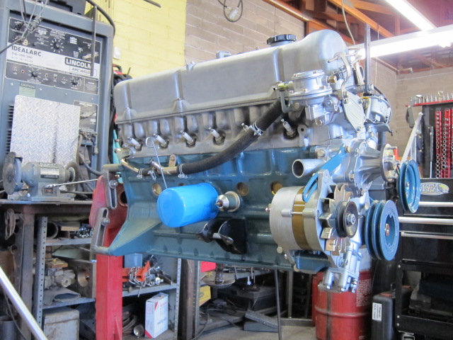

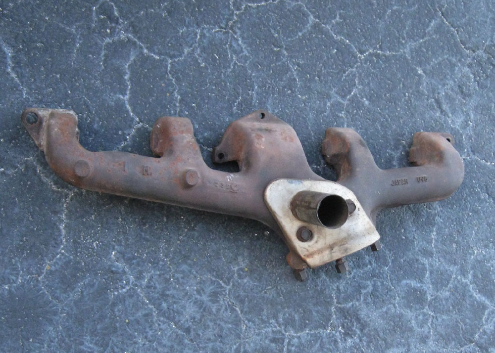

This is the exhaust heat riser Dan is talking about
Here are a few pictures of my engine while I was preparing it for the 2012 Convention
that shows the exhaust manifold heat riser.
post-1390-0-10206100-1435359313_thumb.jp
post-1390-0-78056400-1435359327_thumb.jp
post-1390-0-22687300-1435359337_thumb.jp
post-1390-0-03714500-1435359378_thumb.jp
post-1390-0-27278500-1435359390_thumb.jp
post-1390-0-15614300-1435359401_thumb.jp
