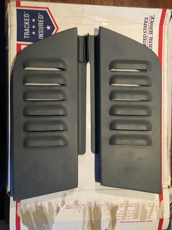

July 29, 20169 yr Author comment_499812 Look at what came in the mail: Link to comment https://www.classiczcars.com/forums/topic/51541-1973-rebuild/?&page=25#findComment-499812 Share on other sites More sharing options...

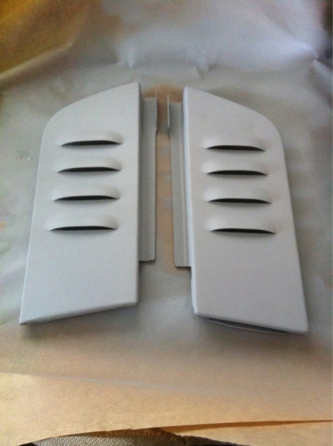

July 29, 20169 yr comment_499817 Looks like nice stuff! I like...Mine were done at Fergies Custom Louvers in Kelowna BC Link to comment https://www.classiczcars.com/forums/topic/51541-1973-rebuild/?&page=25#findComment-499817 Share on other sites More sharing options...
July 30, 20169 yr Author comment_499820 Nice! I like the mellow shape of yours.It was totally an impulse eBay buy and might not be that most effective of all the options, but I like this more than swapping on a 280z hood. Link to comment https://www.classiczcars.com/forums/topic/51541-1973-rebuild/?&page=25#findComment-499820 Share on other sites More sharing options...
July 30, 20169 yr comment_499872 I prefer the flat hood to the Louvered hood of the 78's etc. The vented inspection doors are a nice mod that isn't that common but not out of character.. Link to comment https://www.classiczcars.com/forums/topic/51541-1973-rebuild/?&page=25#findComment-499872 Share on other sites More sharing options...
July 31, 20169 yr comment_499908 I had Fergie do these for me, Link to comment https://www.classiczcars.com/forums/topic/51541-1973-rebuild/?&page=25#findComment-499908 Share on other sites More sharing options...
