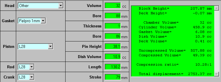

September 28, 20186 yr Author comment_558403 23 hours ago, Chickenman said: That picture should make people think about some of the published Data on some of the Flat Top pin. heights. I've always contested that the OZDat engine calculator has got the pin height wrong, as it calculates the piston crown as being below the deck surface. Same as the dished pistons. That is obviously incorrect. Very common for FT' to stick above the block deck approx 0.021" to 0.024" . And why you always check dimensions.... I didn’t make a specific statement - but I did say in this thread that the block had been shaved - .005 to be exact Link to comment https://www.classiczcars.com/forums/topic/51459-l28maxima47-build/?&page=11#findComment-558403 Share on other sites More sharing options...

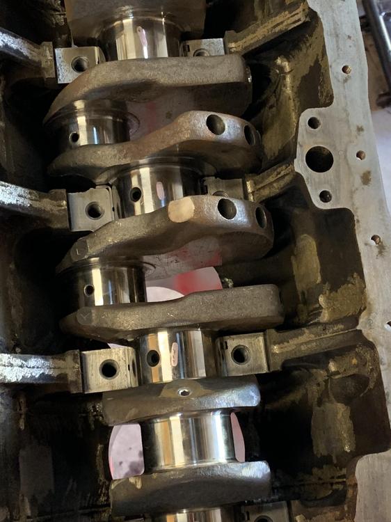

May 6, 20196 yr Author comment_574905 Can’t believe this thread is 4 years old. Man I’m slow. I did order a cam today for the build . Potter Racing cam! Once I have it in hand I can actually start the rest of the assembly. Need to work out lash pads once cam is here, then check PVC - hope that works out well -eek! Meanwhile the 3.2 block gets a bath so I can drop the crank in! Link to comment https://www.classiczcars.com/forums/topic/51459-l28maxima47-build/?&page=11#findComment-574905 Share on other sites More sharing options...

May 7, 20195 yr Author comment_574956 That part went well! Link to comment https://www.classiczcars.com/forums/topic/51459-l28maxima47-build/?&page=11#findComment-574956 Share on other sites More sharing options...
