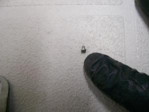

From my '70 Z...
Sorry the picture is a bit fuzzy, but you can just make out that it's a Phillips head screw.  Good luck.  Mine dropped down into the back of the IP after I unscrewed it, and I never found it again until I pulled the dash to start crack repairs.post-20221-0-17953700-1426331291_thumb.j
Two things that might help... First is that the screw LOOKS like a Phillips head, but in reality it's not. It's a JIS (Japanese Industrial Standard) screw that's very similar to Phillips, but slightly different. Most of the time they're close enough that you can use typical Phillips screwdrivers on them without incident, but there are times when a Phillips screwdriver will smear out the JIS screw head.

So one more detail about the JIS screws vs Phillips. I've not reviewed the mechanical specs for both, but I've found that it often helps to take a small amount of material off the very tip of your typical Phillips screwdriver in order to get a better bite on a JIS screw head. In other words... I've found that Phillips screwdrivers bottom out in JIS screws before they are fully engaged because the tips are "too pointy".
With something that small, a couple passes of the screwdriver point across some sandpaper ought to take off enough material to allow deeper engagement. Couple strikes straight across some 320 grit?
