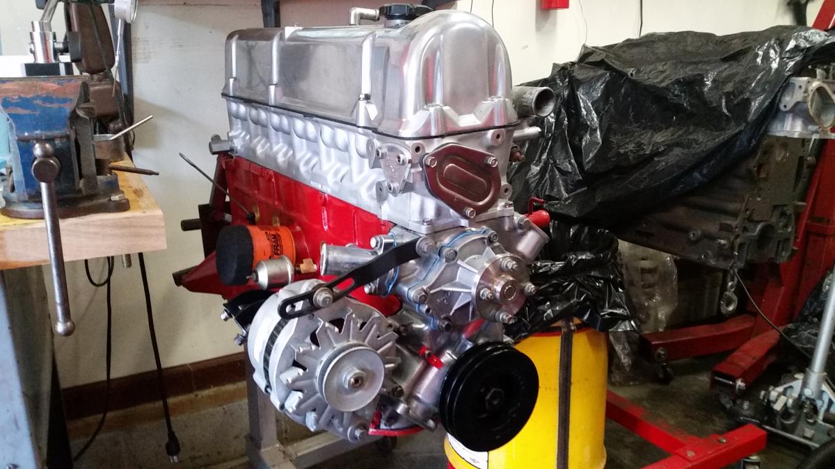

looks shockingly familiar from the outside ;}
it will be a great feeling to get it going, well worth the wait.
i'm running a stock cam for now and will switch out to a hotter one in a few months when i feel the need for a little more poke. i'll be watching your thread carefully to see how it all shakes out.

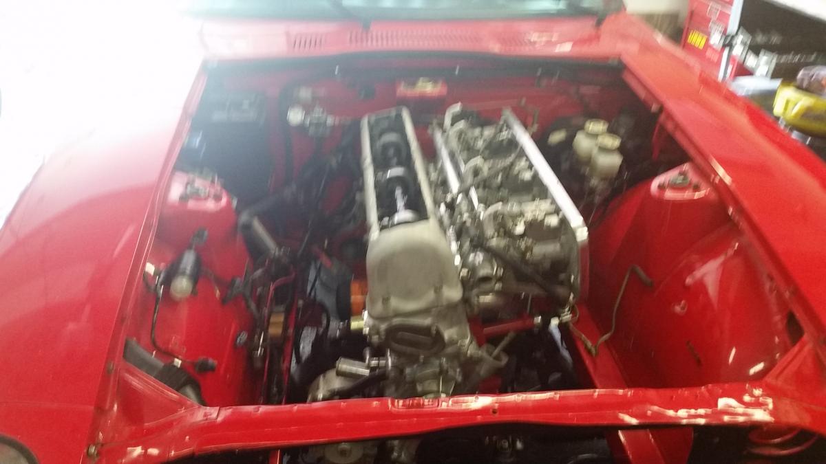

....moving right along like a freight train on the build
Looks good Steve!  Did you use the MN47 head?  Just noticed the block off plate is why I ask.
Ready to see and hear some video of 3rd gear chirps.  :)
