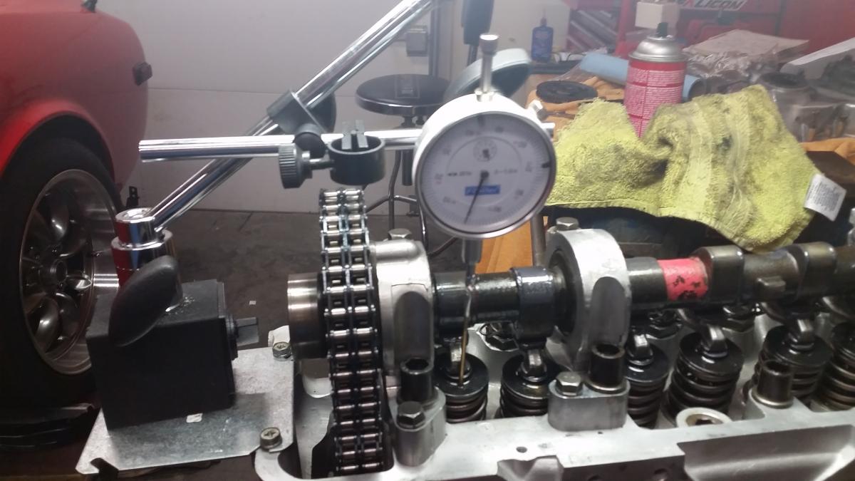

And no specific Datsun instructions, but I do have a cam card.
Waiting to call Isky
post-6833-0-99503800-1436216230_thumb.jp
Edited by madkaw
Hmm... how stiff is that mounting plate bolted to the front of the head? Some sort of Tin Plate? Looks a bit flimsy.... Edit: Looks like a backing plate for an electrical junction box.
Any slightest movement there is going to be multiplied by the lever action of your Dial Indicator mounting arm.
I prefer to make a metal rail out of flat 24" x 2" x .125" mild steel and bolt it down the side of the Valve cover rail.  Drill holes in it to match Valve cover holes and bolt her down with 3 short 6mm bolts. That way you can attach the Dial Indicator Arm with the shortest length possible and a have a very stiff mounting plate. Stiff is always good !!! Just my .02c.. beermug.gif
Edited by Chickenman

I believe that is a cover plate for a 4x4 metal electrical box. They are pretty stiff. You could bend it if you tried but they aren't overly flimsy. Not as stiff a 1/8" plate though.
waiting on Ron to call me back, but he said the cam card is WRONG!
Richard,
good call on the box cover. It actually fits the bolt spacing perfectly-no drilling. Yes it's not very thick, but there isn't much pressure being exerted pushing a dial indicator rod in. Hell, the engine stand bounces around more-LOL.
I looked at my Schneider card from my 480 lift cam and I realize now how far off the isky numbers are and how close mine probably are to being right. At least I can put this puppy together if Ron ever calls back
