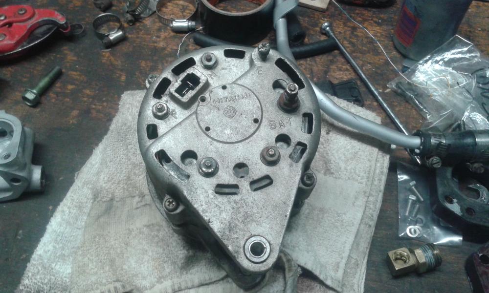

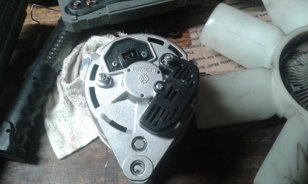

May 1, 20169 yr comment_493954 Cool. Another crisis averted. I have so little faith in the rebuilt stuff these days. How does something like you had get out of the rebuilder's shop? Should never happen. Link to comment https://www.classiczcars.com/forums/topic/50909-72-240z-rebuild/?&page=33#findComment-493954 Share on other sites More sharing options...
May 1, 20169 yr comment_493962 Lifetime warranty, endless exchanges! All I need is my name and phone number at OReilly and they can tell me if I get free exchanges. No receipt necessary. My "brand new" replacement reman alternator has been sitting on the shelf in my garage for about 4 years. Link to comment https://www.classiczcars.com/forums/topic/50909-72-240z-rebuild/?&page=33#findComment-493962 Share on other sites More sharing options...
May 1, 20169 yr comment_493963 Just ground the black wire to the case, "E" is suggested but what ever works is fine. Captain Obvious beat me to the punch. Dave Link to comment https://www.classiczcars.com/forums/topic/50909-72-240z-rebuild/?&page=33#findComment-493963 Share on other sites More sharing options...

May 1, 20169 yr Author comment_493982 What threw me was that black plastic cage on back. I assume when they rebuild one they have to tear into the rear to replace parts and put that on there to keep the wires from falling out? I thought that was what made it an "internal regulator". Thanks for the all the help, I'm cranking it this morning when all my "good neighbors" go to church. Hoping that I can run it for 20 minutes this time. Link to comment https://www.classiczcars.com/forums/topic/50909-72-240z-rebuild/?&page=33#findComment-493982 Share on other sites More sharing options...
May 1, 20169 yr Author comment_494010 14 hours ago, Zed Head said: Lifetime warranty, endless exchanges! All I need is my name and phone number at OReilly and they can tell me if I get free exchanges. No receipt necessary. My "brand new" replacement reman alternator has been sitting on the shelf in my garage for about 4 years. Quick update, FAILED. Another one is on the way. 8^) Link to comment https://www.classiczcars.com/forums/topic/50909-72-240z-rebuild/?&page=33#findComment-494010 Share on other sites More sharing options...
