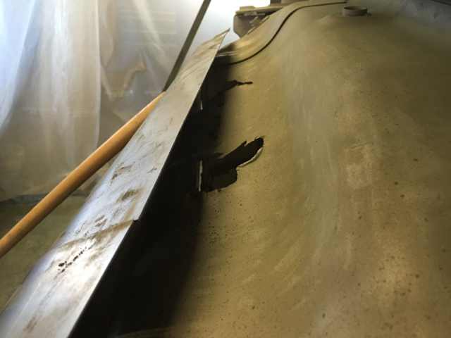

On 3/15/2016 at 2:12 PM, wheee! said:
Found this pic in my files of the floor pan and tunnel area differences. The 280 has a noticeably smaller seat mount set on the driver side to accommodate the bulge in the trans tunnel.
Charlie Osborne was unaware of it and is requesting a paper template to correct the metal forms for his floor pans.
Racers are all too aware of the 260/280 floorpan hump on the driver's side.  We have to cut the hump out to fit a race seat lower than the stock seat.
So i wonder, should I bother replicating it or remove it and merely extend the seat brackets?
Basically extend the sheet metal up the tunnel. I assume it is there to accommodate a resonation pipe/cat in the exhaust.
It depends how original you want it and which is easier to form.  You can either shape the replacement floor pan to fit the 280 tunnel or shape the tunnel like the 240 to better fit the floor pan.
26 minutes ago, wheee! said:
Shaping the tunnel would be easier at this point. I don't think it would be hard to extend the seat rails.
ImageUploadedByTapatalk1458176448.555513
 Easier yes. The tunnel is thinner material than Charley's floors but are you going to lose needed clearance for the exhaust? Just a thought.
Shape the floor pan. It's easy to do. Make a series of cuts in to the floor pan about every 2", closer where a tight radius is needed. Take a heel dolly and round the floor pan to it turn up where needed. Zip screw it in place. Take a body saw or cut off tool and cut the tunnel and floor pan in one pass. Tack it in place and form some more with a heel dolly. weld it all up...
