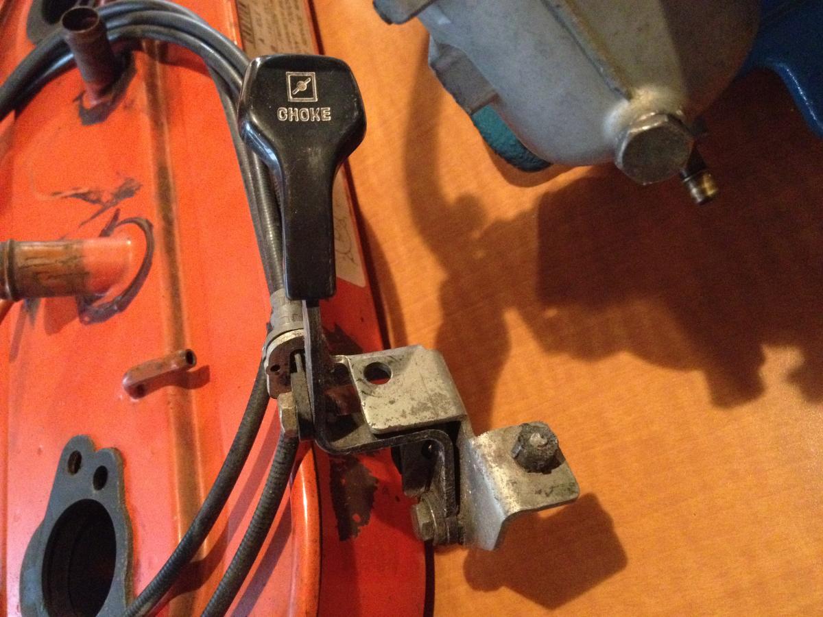

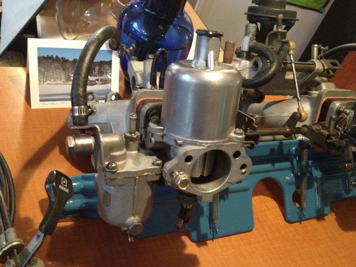

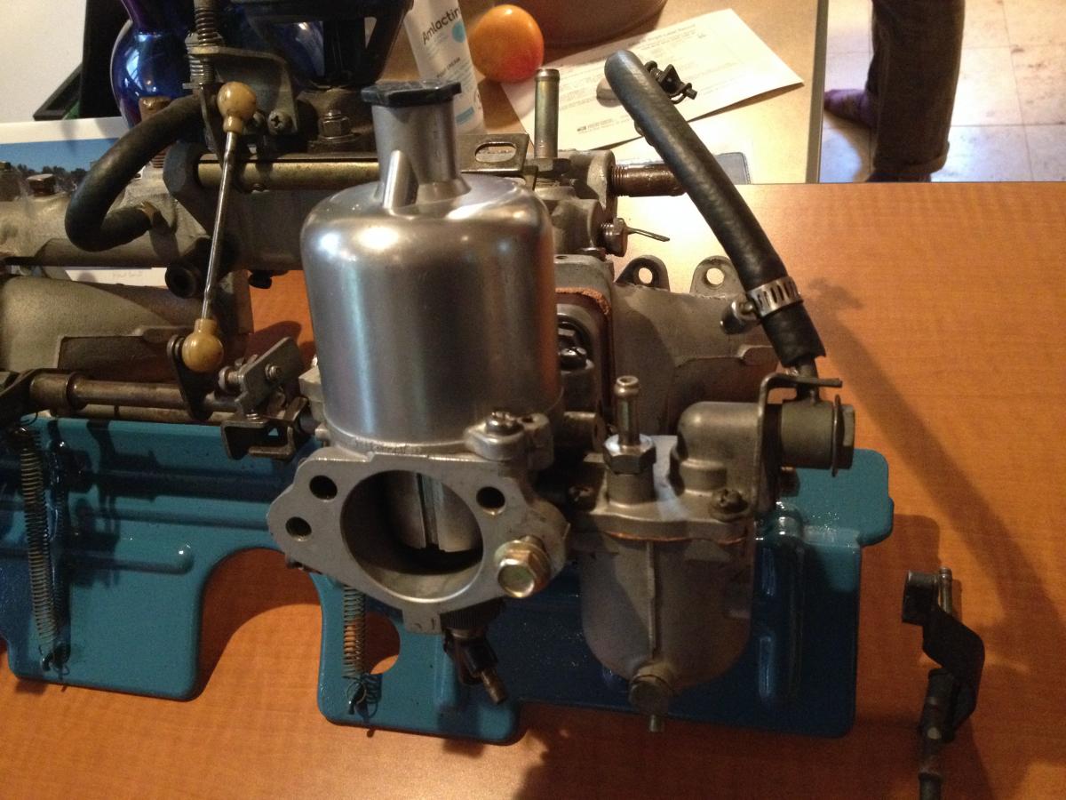

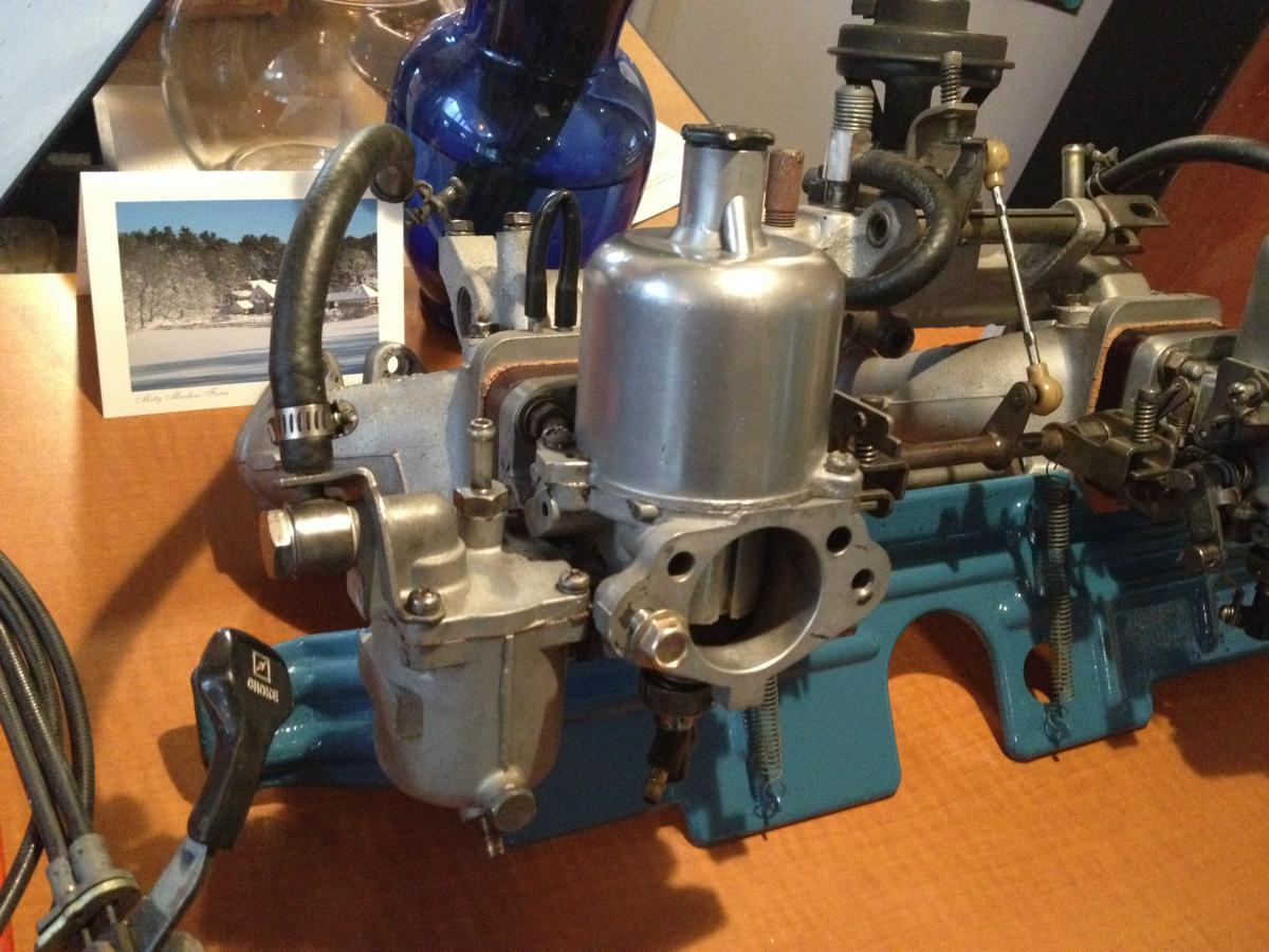

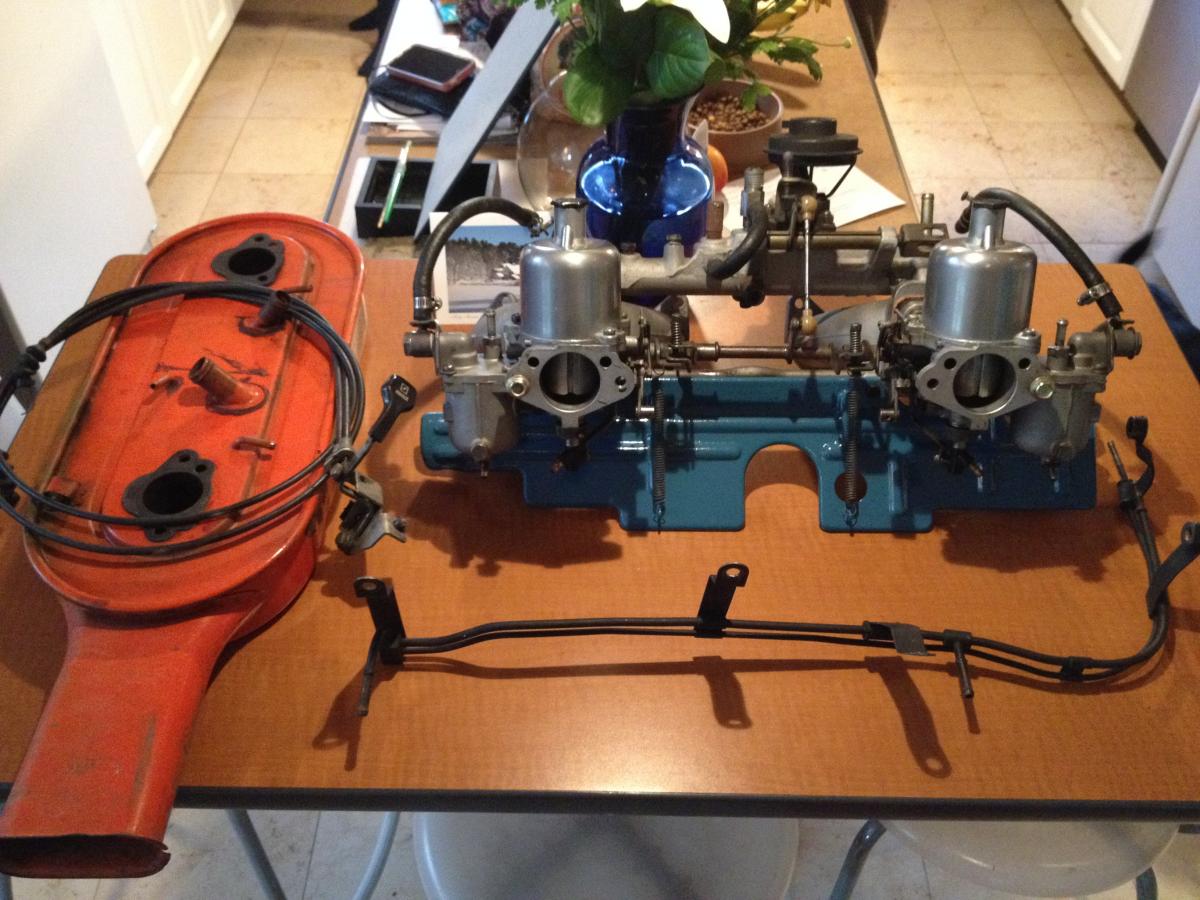

April 3, 201510 yr Author comment_466990 goodies just arrived - almost done amassing bits to start the build... Â Link to comment https://www.classiczcars.com/forums/topic/50727-a-project-is-brewing/?&page=3#findComment-466990 Share on other sites More sharing options...
April 3, 201510 yr comment_466992 So you're switching to carbs for this next engine build? Did you mention that before, or is this a new revelation? I've considered the same... I find beauty in the simplicity of operation. Link to comment https://www.classiczcars.com/forums/topic/50727-a-project-is-brewing/?&page=3#findComment-466992 Share on other sites More sharing options...
April 3, 201510 yr comment_466997  You're going to love them. As the Captain says, the simplicity of operation is a thing of beauty. Having sorted out your own fuel injection issues, it will be interesting to hear your comparison of the two fuel systems in the future. Should you find you are missing anything in the new set-up, let me know. Congrats on the great find.Mark Link to comment https://www.classiczcars.com/forums/topic/50727-a-project-is-brewing/?&page=3#findComment-466997 Share on other sites More sharing options...
April 3, 201510 yr Author comment_467006 yes - since our efi systems are not very adjustable, and the new build will a platform for more performance, i'm going carbie.in addition to this, my goal is to rip out every possible wire and sensor and strip things down to the absolute bare essentials. i know some of you folks are very comfortable with electronics (Captain, SuperLen & FW for starters) and i mean no disrespect here, but the more grass i can see when i look down into my engine bay, the better! in absolute contrast to the above, i do plan to weld a bung into the exhaust and install a wideband o2 sensor to assist w/tuning. that sensor doesn't bother me, as it is a diagnostic tool and if it were to crap out for some reason it wouldn't leave me stranded (again!). i'm very happy with the condition of the su's i found and will be ordering the ZT DVD to start the learning process... Link to comment https://www.classiczcars.com/forums/topic/50727-a-project-is-brewing/?&page=3#findComment-467006 Share on other sites More sharing options...
