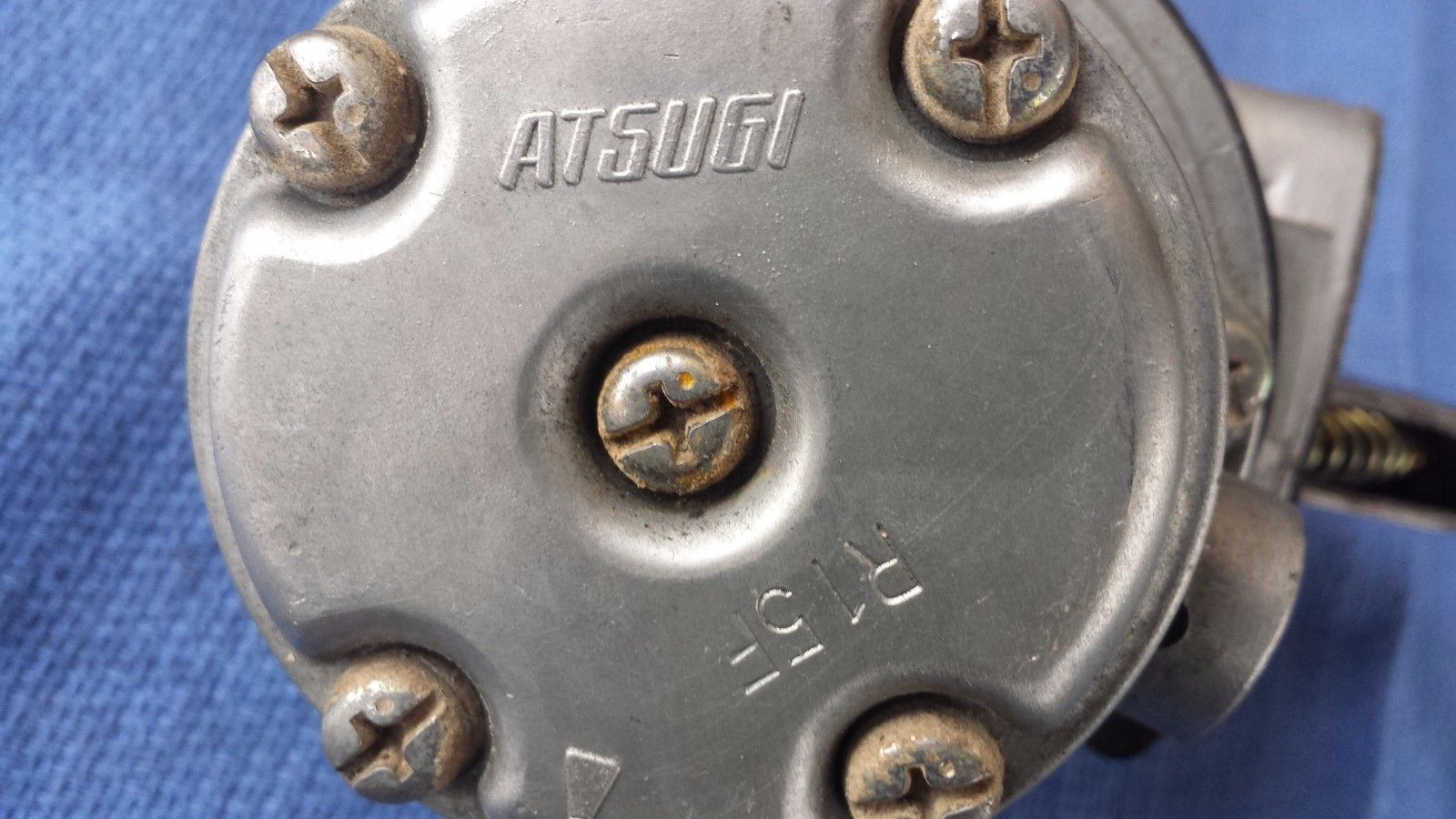

Hey Guys,
I just went and looked at the fuel pump on my 72 240z (Australian Delivered). It looks exactly the same as the "Nikki" unit, but instead the casting has "Atsugi" written on it. I've attached a photo (not mine but 1 on eBay at the minute).
Is Atsugi the same as Nikki in that the company name changed later on? Or a completely different manufacturer?
