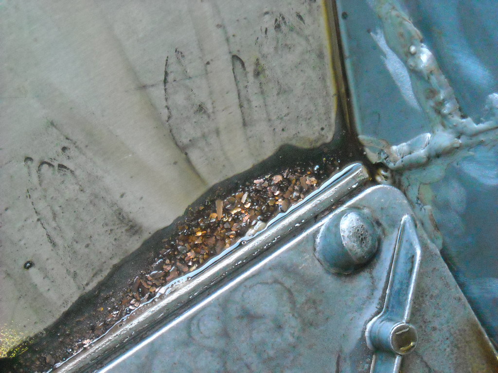

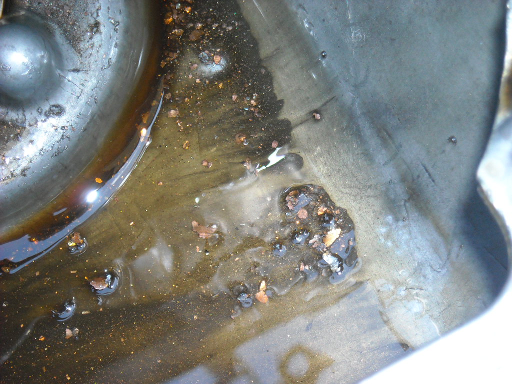

Soon to find out, I hope it is just a bearing. I'm thinking I might get the oil in the pan analyzed in case it holds any clues... other than shards of metal of course:rolleyes:
Yeah, I'm hoping for some interesting forensic discovery... I'm just hoping it's not too gruesome.

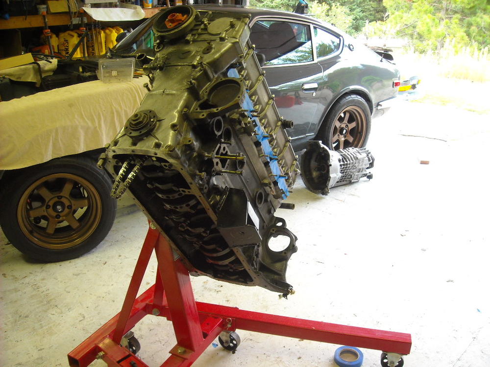

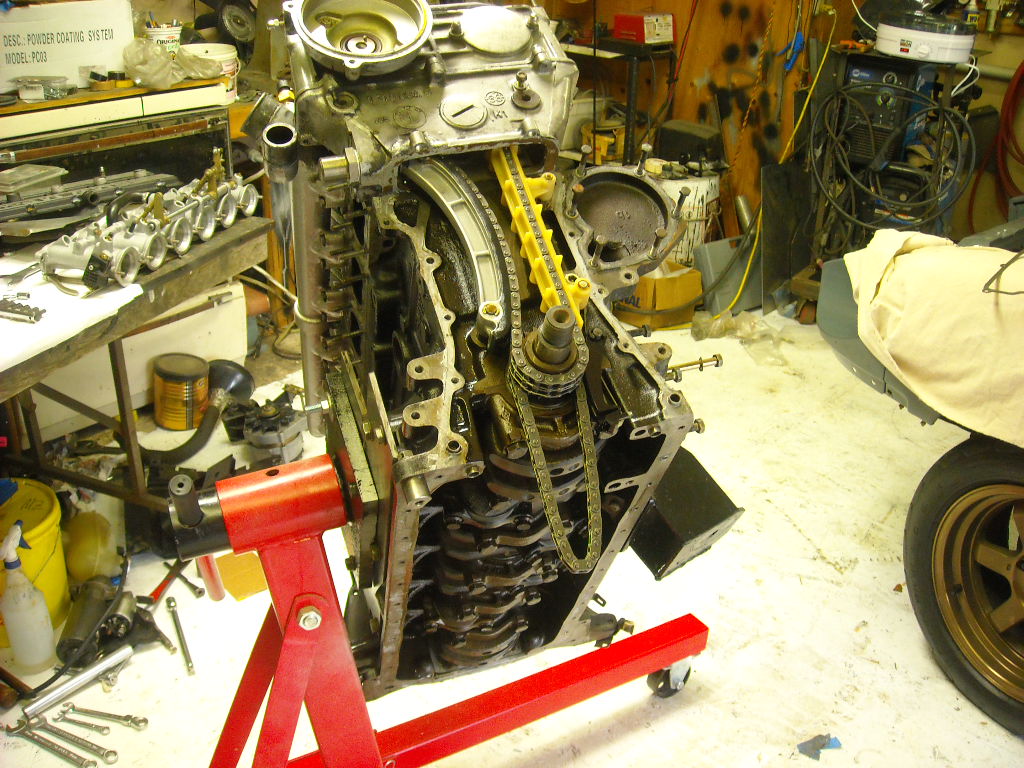

Built an adapter plate so I could mount it on the engine stand, there is no bearing material up near the cams so that is a good sign, I have all fall and winter to fix it so I'll go slowly.

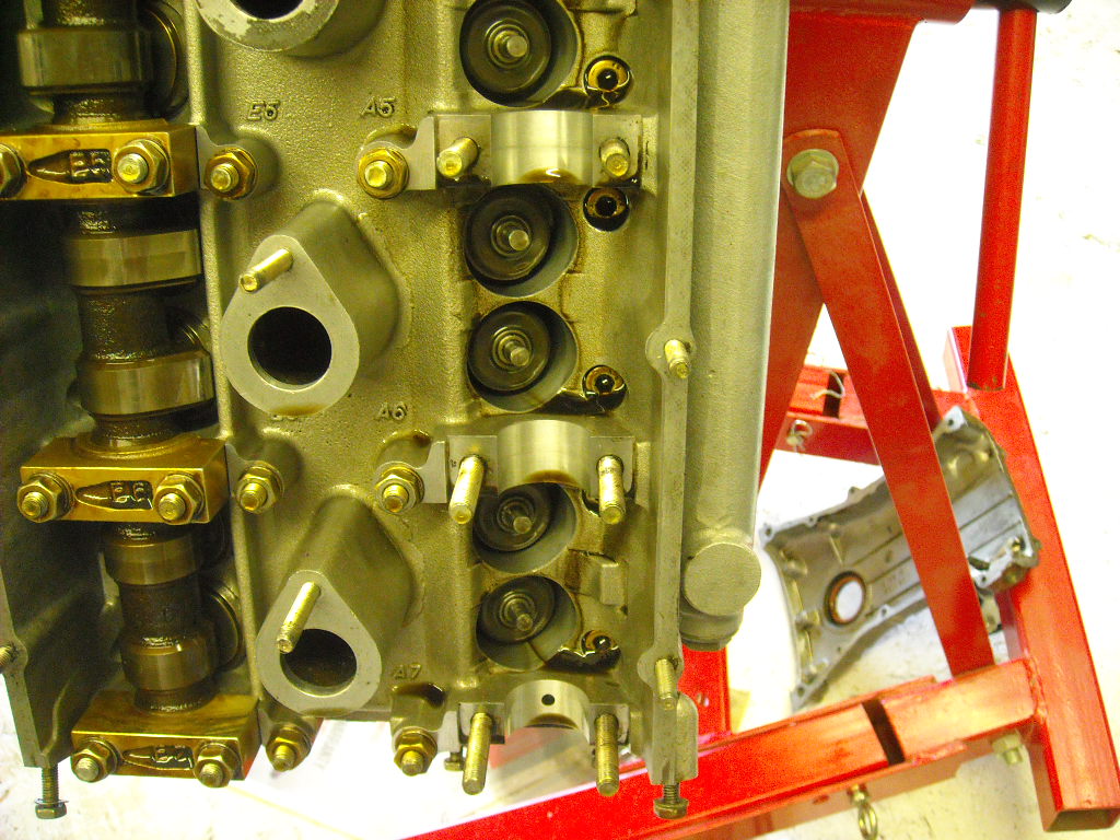

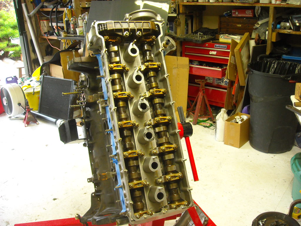

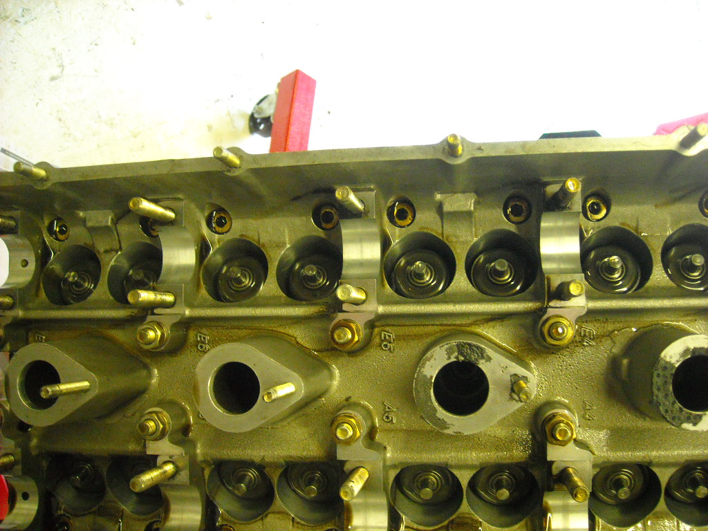

Removed both cams today and the journals and bearing surfaces are perfect, no damage and the cams are farther away from the oil pump than the conrod bearings. There has to be an obstruction in the oil line going to the crank.

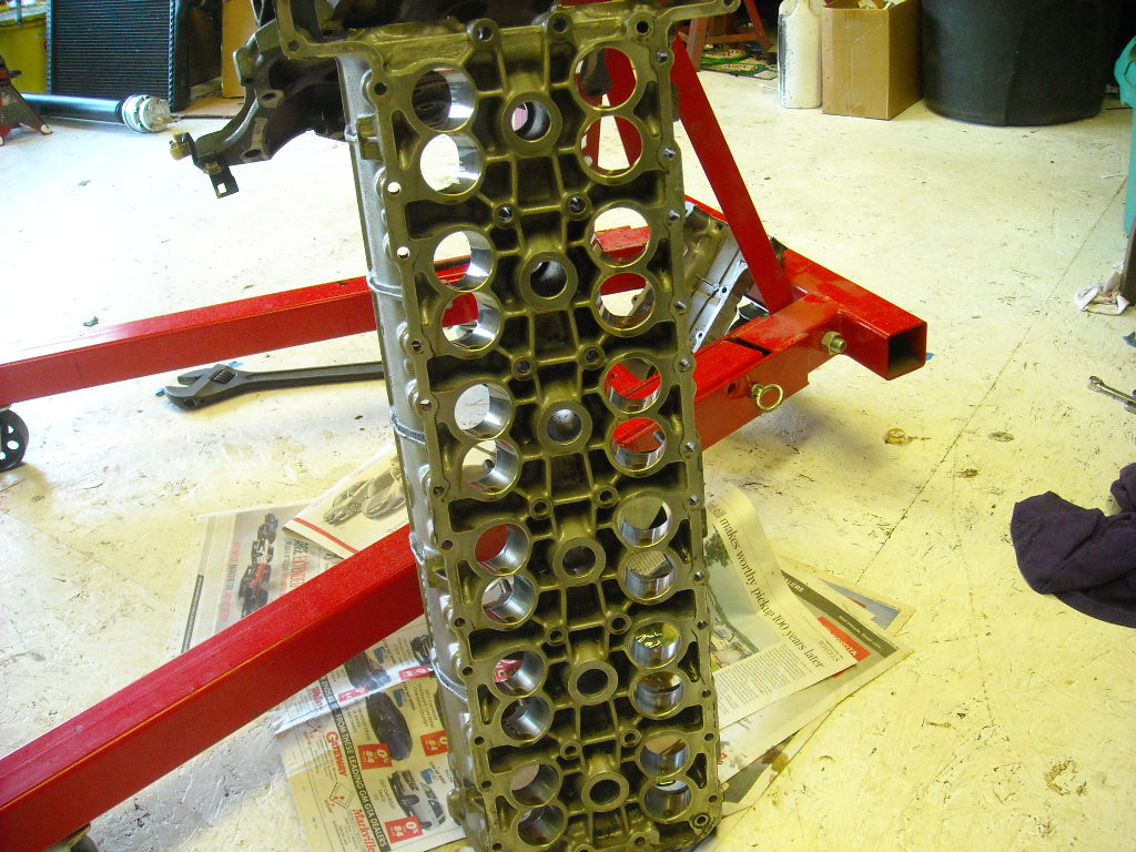

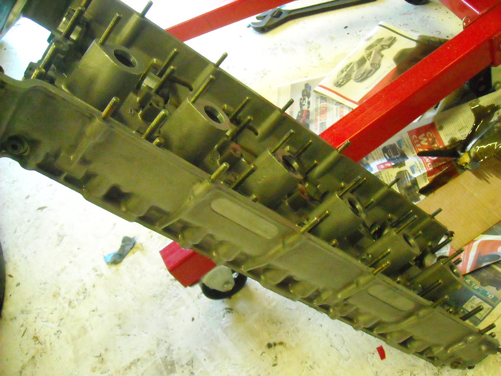

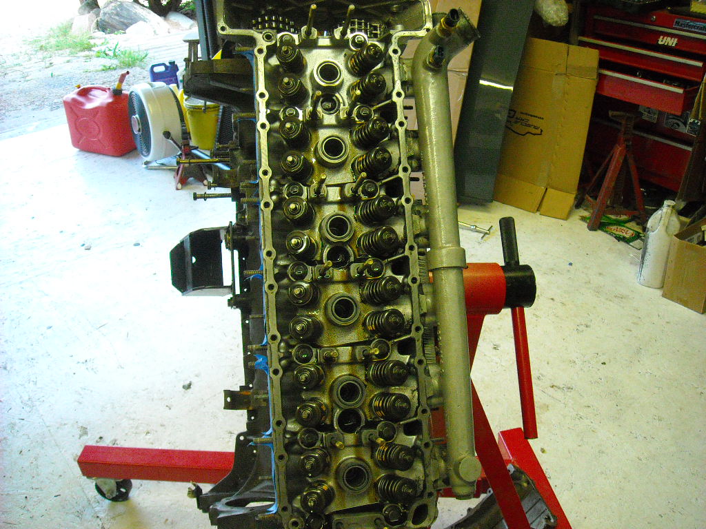

On these engines the head consists of to two pieces, the top piece is the timing or cam box and the lower piece holds the the valves and spark plugs, I'll have the lower head off tomorrow.

I hope you replace the oil pump while you're in there. there is too much of that bearing in the pan for it to not have gone through the pump at least once (how many times it went through would depend on where the oil filter is in the priority oiling system as well)

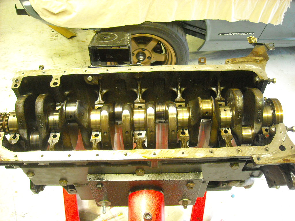

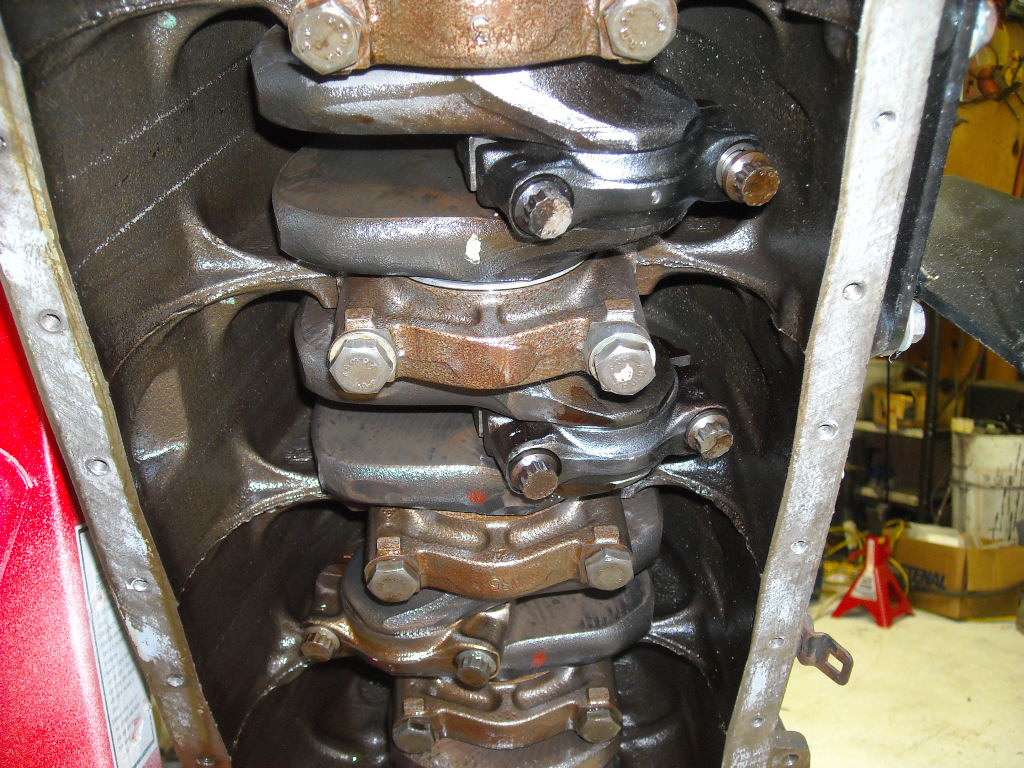

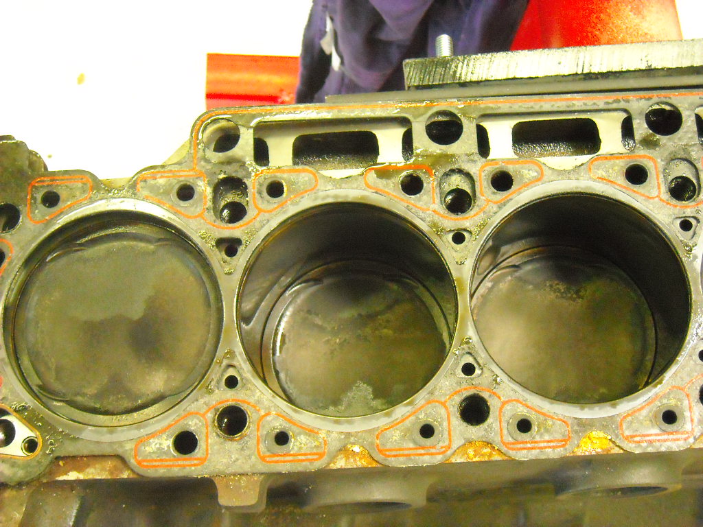

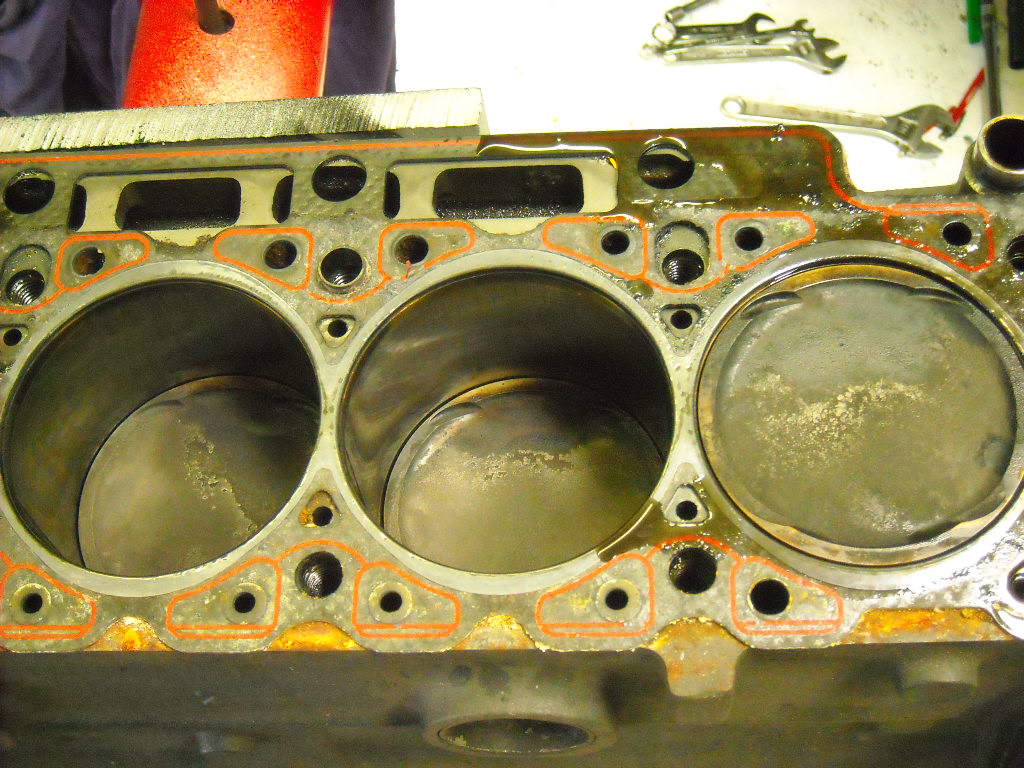

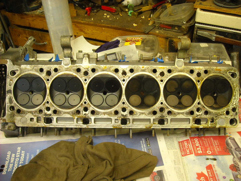

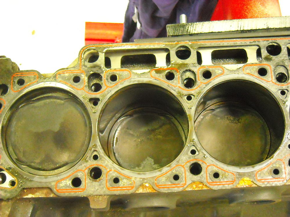

Finished the tear down, the head looks good, can't explain why cyl #1,2 and 3 appear oily compared to #4,5 and 6, there is no scoring of the cylinder walls and all the rings are in good shape and the pistons all look dry.

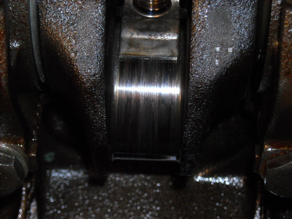

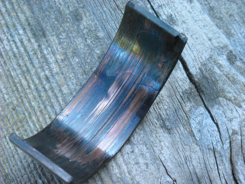

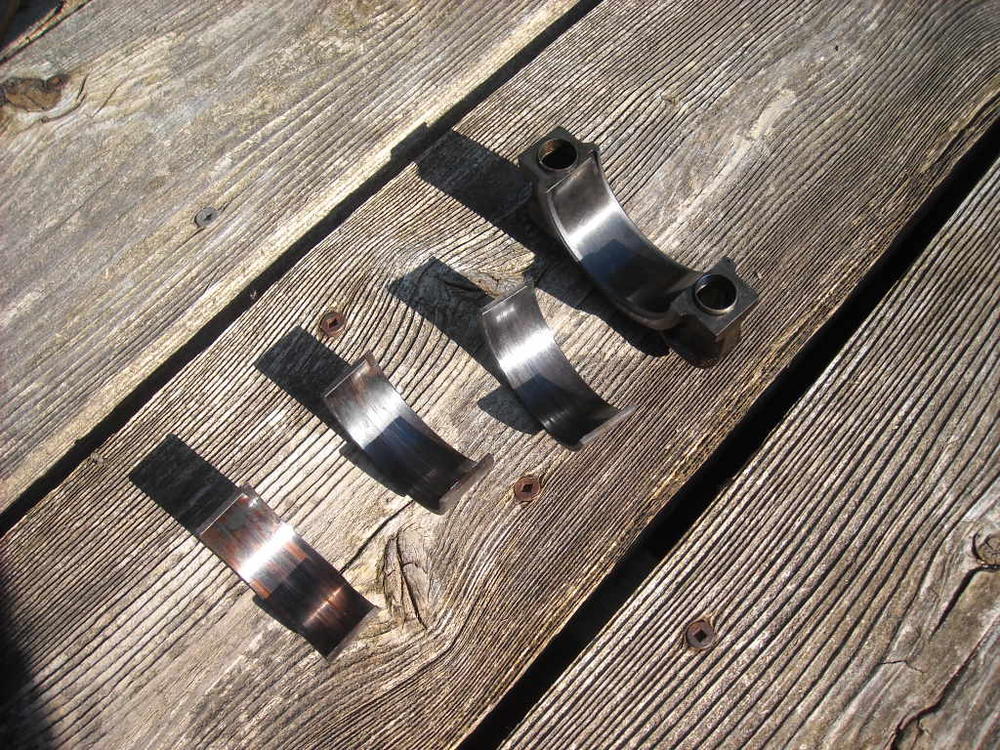

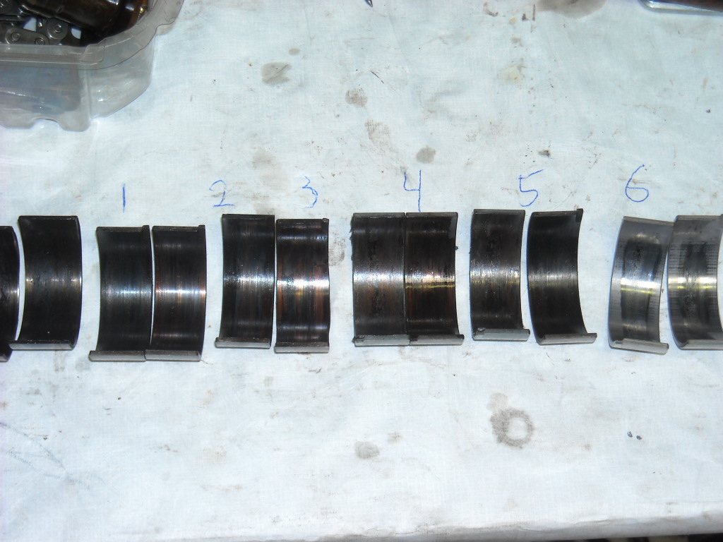

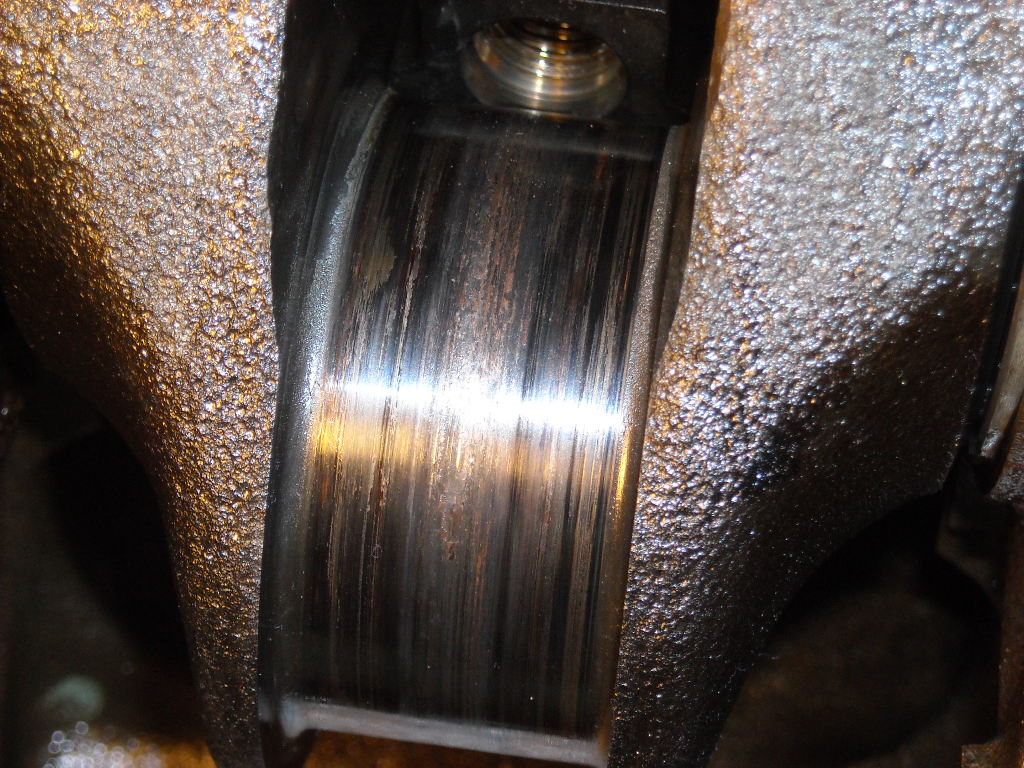

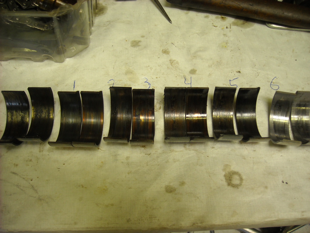

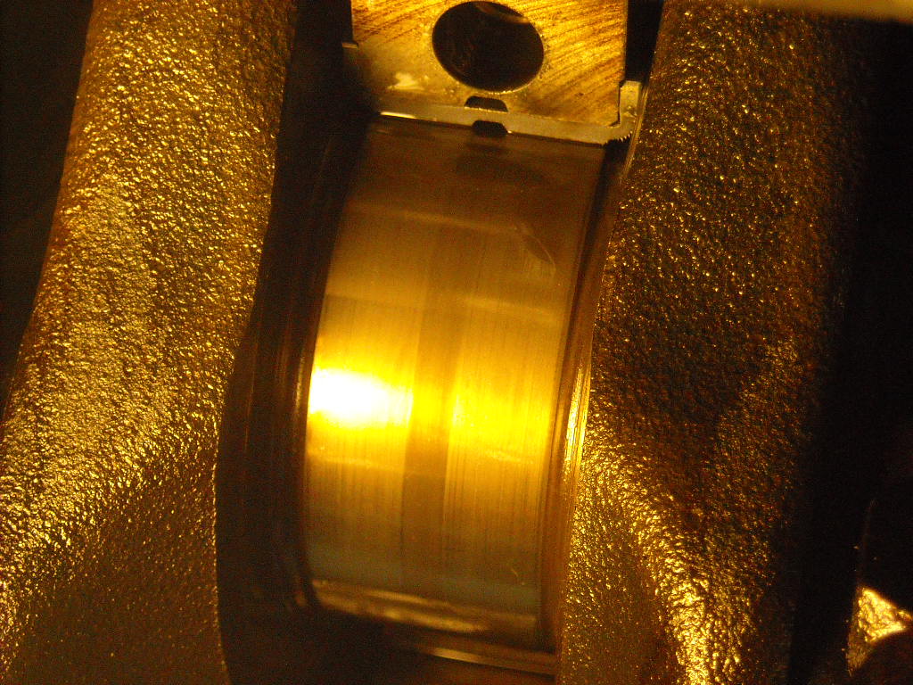

DSCN1822.JPGDSCN1826.JPGDSCN1827.JPGSo conrod bearing #1 spun, 2,3,4,5 did not spin but are trashed, 1-5 bearing shells are a copper based bearings. #6, the shiny silver coloured bearing on the far right shows normal wear for 5000 miles. In fact to my eye it looks like #6 are the only bearing shells that were replaced during the rebuild. I'm going to take the block back to the builder and ask him to explain it to me.

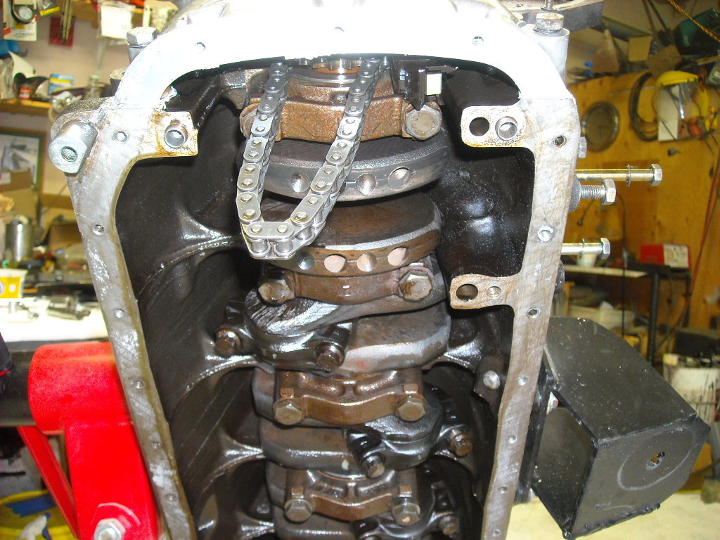

All the main bearings are perfect except #2 which is badly worn, I ran a wire through every oil feed line in the block and the crank and there were no obstructions, all clear passage ways.
