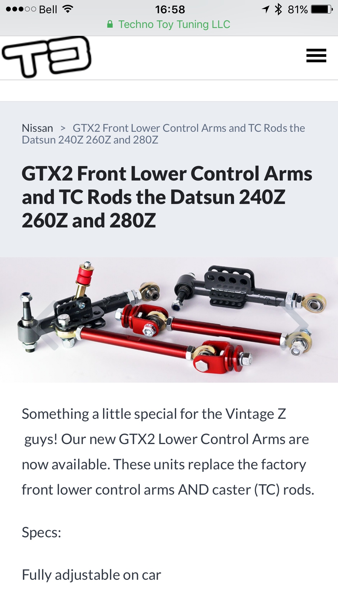

Captain, I will need after market adjustable T/C rods to get to 4-5* caster but I'm just trying to tweak it enough to get through a track day on the 20th of Aug. using the stock T/C rods,  so .3" of washers on the D/S will at least equal them out. True it is 18" from the shock nut to the wheel center but the T/C rod is attached to the top of the ball joint that 5-6" South of the wheel center line, that might mean I'll need a bit more than .3", what do you think?
Yes, I agree. Estimating the total length at 24" (the 6 from ball joint to wheel center plus 18 from wheel center to top of strut), you would need about .42 inches added to the T/C rod length to add one degree to the driver's side and even things up. Thanks for checking my work!
