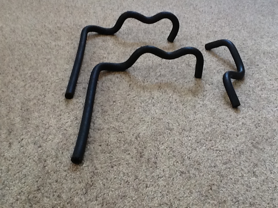

Did he heat form the hoses in the oven or something similar?
He used a piece of copper pipe slightly smaller in diameter that the hose.  I believe he either bent the copper pipe first and pushed the hose over it or inserted the copper pipe and shaped it to the final product.  I can see the copper pipe in the hose and do not believe it would ever hurt anything as it still allows vacuum to go through it and obviously won't collapse.

The process I used to create this master vac hose section is something I learned from Kats.  Kats used braided fuel hose which is the exact correct size, but
much softer than rubber vacuum tubing, and brass rod to give the hose perminent shape.
I used 11/32" ID brake vacuum hose from NAPA AUTO PARTS which is an exact match in size and texture to the Nissan hose, and 1/4" copper refrigerant
tubing from Home Depot.  Using a length of the copper tubing, I shaped it first and then slid the rubber hose over the tubing.  A little sil-glyde on the tubing
made the process fairly smooth but guard against using excessive pressure that might kink the copper tubing.
Before inserting the copper tubing, you must cut enough off of each end of the copper tubing,  one to one and a half inches, to allow room for the master vac,
check valve, or engine mounting fitting in the rubber tubing.  I, also, leave an extra 1/2" or so on the rubber tubing that can later be trimmed for a perfect fit.
I plan to make a compete set of these master vac hoses and will take all the measurments for those who might want to try this for there own project.

Let me know if there are any questions as to how I made this hose.
And, yes, the copper tubing remains in the vacuum hose to maintain the shape.

Just to add to my last post, and I thought that this would be the most logical place for this, I wanted to see how difficult it would be to make a full
set of these hoses using my technique.
I did make a pretty nice set with the correct 11/32" ID brake vacuum hose and 1/4" copper tubing.  I first formed the copper tubing, and then, with
some sil-glide lube, threaded to hose over the tubing.  In retrospect, I probably wouldn't compete the copper tubing bends, just start them so as
to make getting the hose on a little easier.
I have attached an image of the hoses with the ones I made in the foreground and to the right.  The vac side hose in the back of the image is an
NOS rubber vac hose I used to replicate.  I trial fitted both hoses to my car and the fit was perfect, as far as I could tell.
My experiment successfully completed, I am offering these to anyone in need of a set of early mastervac hoses for the cost of mailing.
Please PM me with your response, and I hope that this may help others on this forum.
Dan
