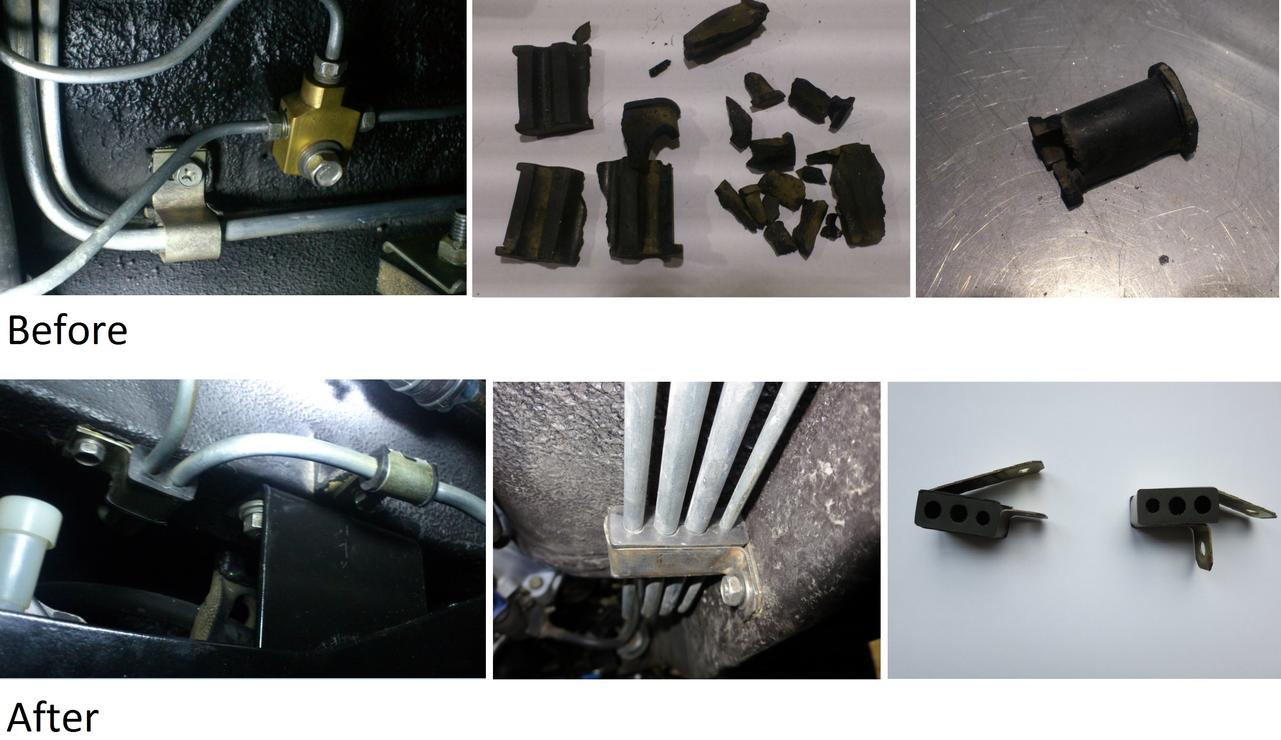

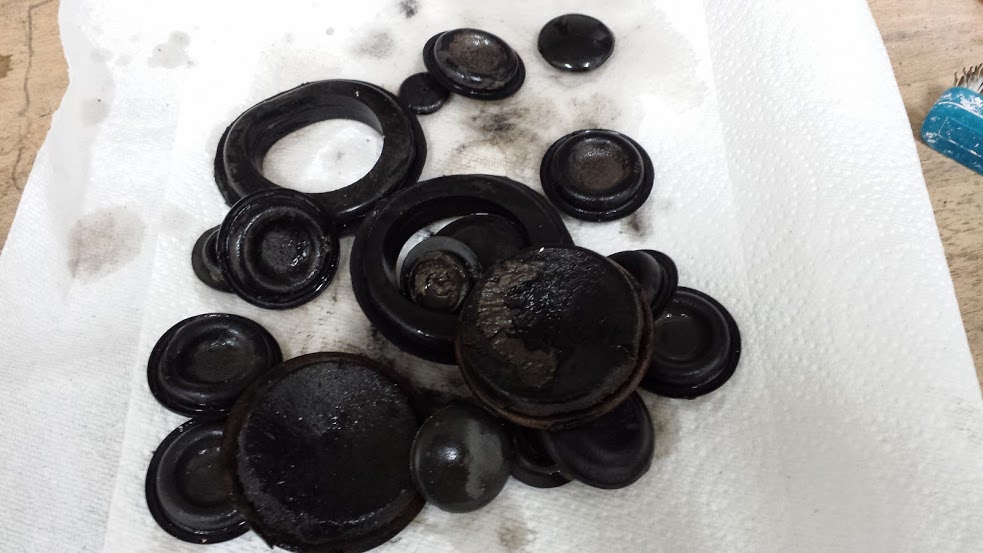

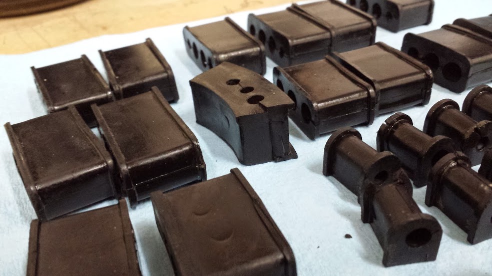

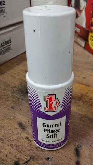

HaZmatt Posted May 18, 2014 Author Share #65 Posted May 18, 2014 Rejuvenating my rubber! Most of my rubber insulators and grommets were salvageable but some I had to toss and i'll replace. I dont really have any before pics but they were pretty nasty. Here was my process; 1. Soak overnight in jar of degreaser 2. Remove and scrub with stiff bristle brush 3. Then soak in Dawn dish soap 4. Rinse with hot water 5. Soak in jar with rubber rejuvinater overnight 6. Wipe down and coat with rubber protectant. I know this may seem a little much for just some rubber pieces but it beats the hell out of paying to replace all of them. Degreased: The rubber rejuvinater I used. Made to clean and soften rubber. Good as new (almost) My Fuel / brake line insulators Link to comment Share on other sites More sharing options...
CG240Z Posted May 20, 2014 Share #66 Posted May 20, 2014 The insulators came out great. Mine were looking a little rough, with a little black spray paint they came out good enough for me to stick under the car and hopefully never see again. Link to comment Share on other sites More sharing options...

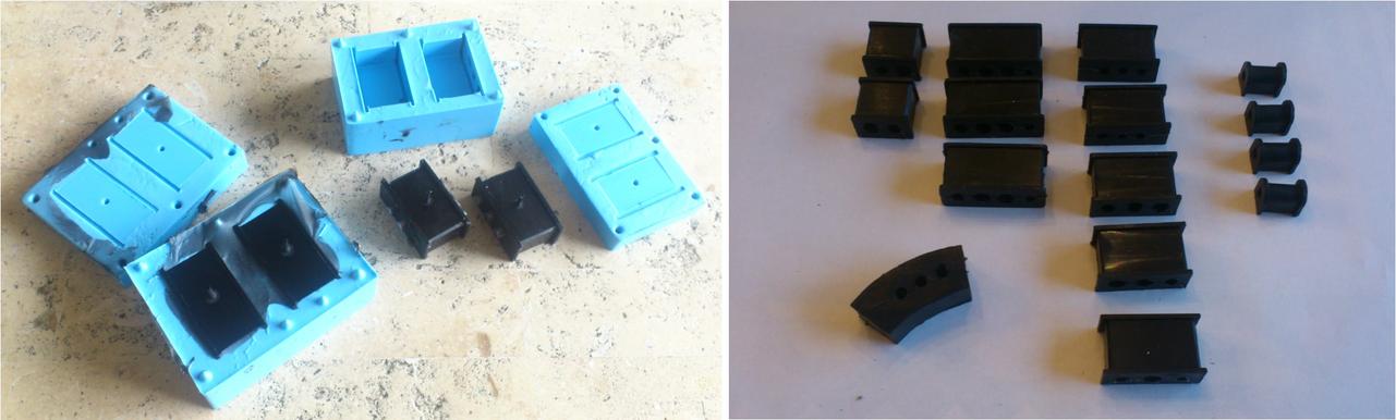

EuroDat Posted May 20, 2014 Share #67 Posted May 20, 2014 That stuff certainly cleans up the insulators well. Impressive results. Love the neat yellow zinc:love: Mine were too far gone to do anything but replace. Since they are NLA, I ended up making them. With a little bit of trial an error the results look great. First trail runs: Chas Link to comment Share on other sites More sharing options...
Mikes Z car Posted May 20, 2014 Share #68 Posted May 20, 2014 Chas, What trash can did you throw your rejects in? Just kidding. What did you make them out of?Mike Link to comment Share on other sites More sharing options...
HaZmatt Posted May 20, 2014 Author Share #69 Posted May 20, 2014 Chas, those look great! I was planning on buying a set from you if these didnt clean up. Link to comment Share on other sites More sharing options...
