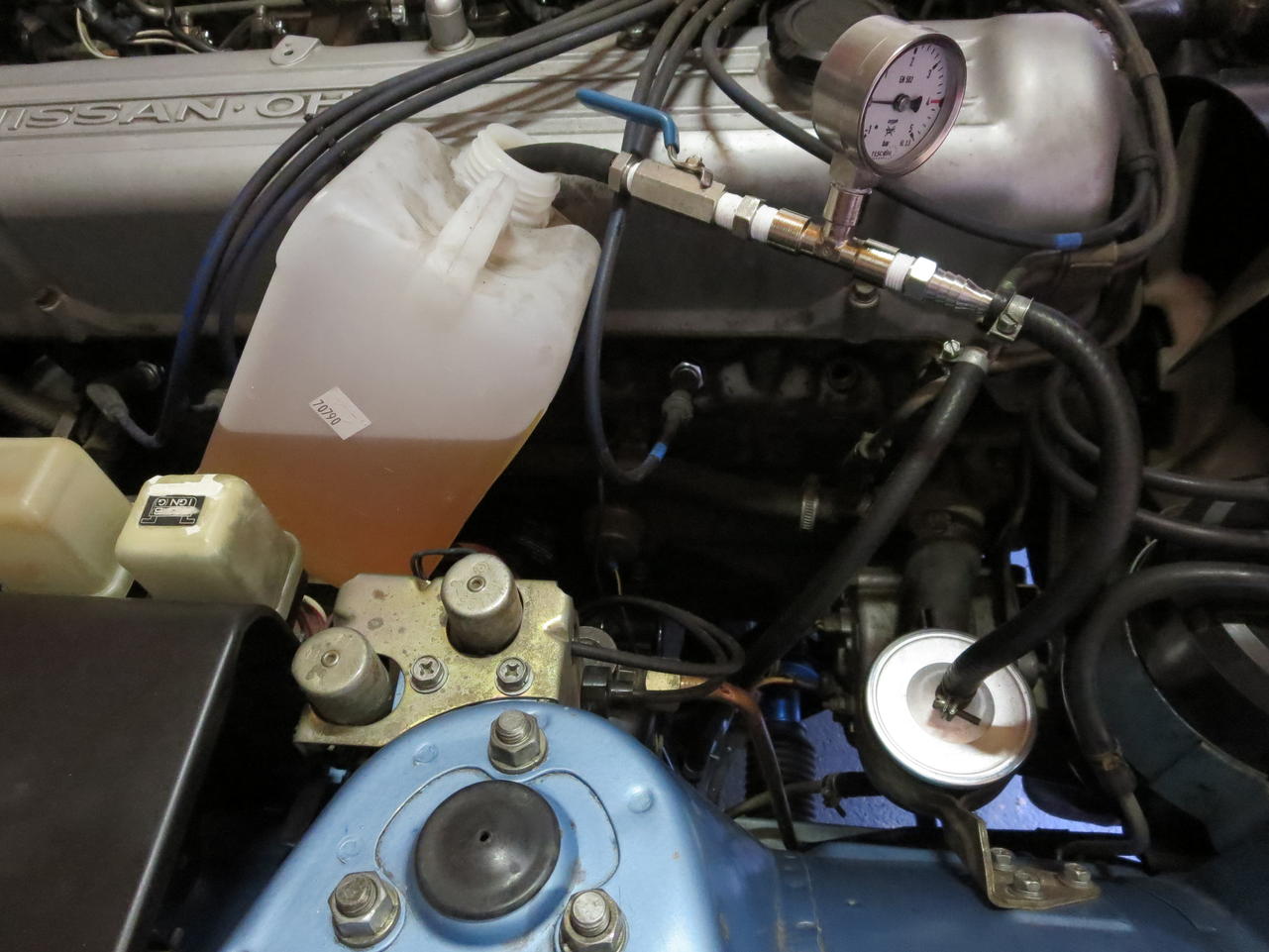

Today I started checking things in the fuel system. I couldn't smeel any fuel when it stopped, so I expected maybe something with the pump. The pump had good pressure at 3.8Barg (55psig) and flowed into a container at about 2 litres per minute.
Dam that wasn't it. Now I was starting to worry about things like ECU and thinking, I hope superlen hurries up with the hellfire ECU. If its that Im stuffed.:paranoid:

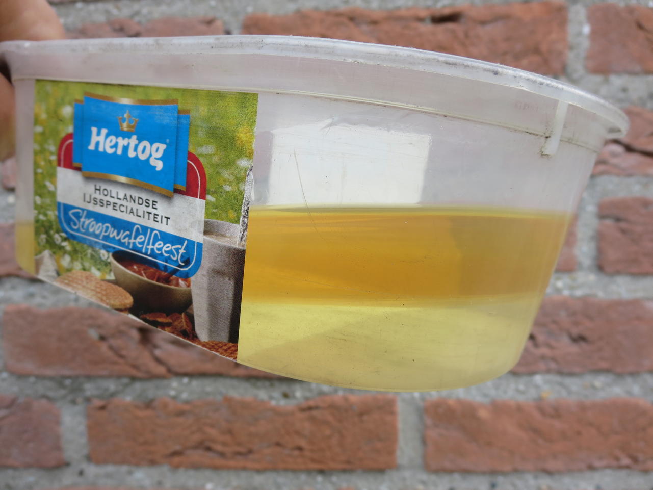

Just then I looked at the container, I noticed something in the bottom. Water. A bit less than a 1/2 litre in the 2 litres that I pumped out.
I then turned my attention to the fuel tank. I drained about 3 litres of water out the drain plug before clean fuel started coming out. There was no gunk or particles in the water so I flushed the fuel lines through to the FPR using the pump.

Here are some photo's of the pressure test and water in the fuel.
