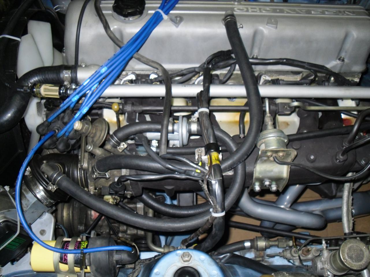

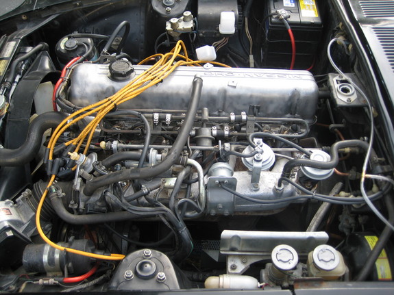

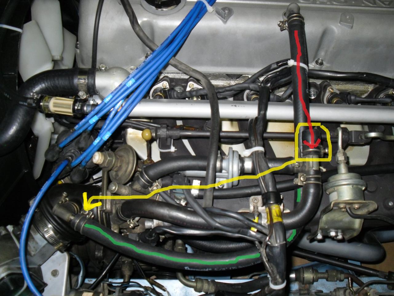

'77 to '78 hose changes from valve cover to AAR. It keeps the AAR cleaner.
I never thought of it before, but that explains why my intake manifold is all black inside, with burned-on oil residue. There ought to be an inline filter that you can change.
On my '78, the air that goes through the AAR comes from the air filter, so will also explain why my AAR was very clean inside.

I have both problems "removed." I put a small cone filter on the cam cover vent, plugged its connection on the throttle body, and removed the AAR (and covered the hole on the throttle.) You have to change the small cone filter occasionally, but the rest of the things stay clean.
So you bailed on the AAR completely? I considered this as well but haven't pulled the trigger...
Correct' I don't use the AAR at all. I only use the car in the warmer months, so I don't really need a high idle for warmup. I still have it bolted on, but only for show, because it's highly polished and the associated metal piping is part of the fuel inject harness support/clamp.
