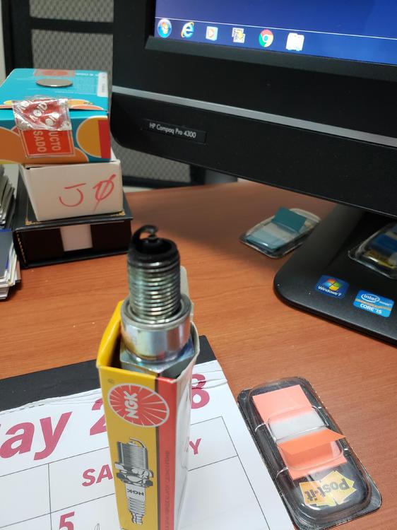

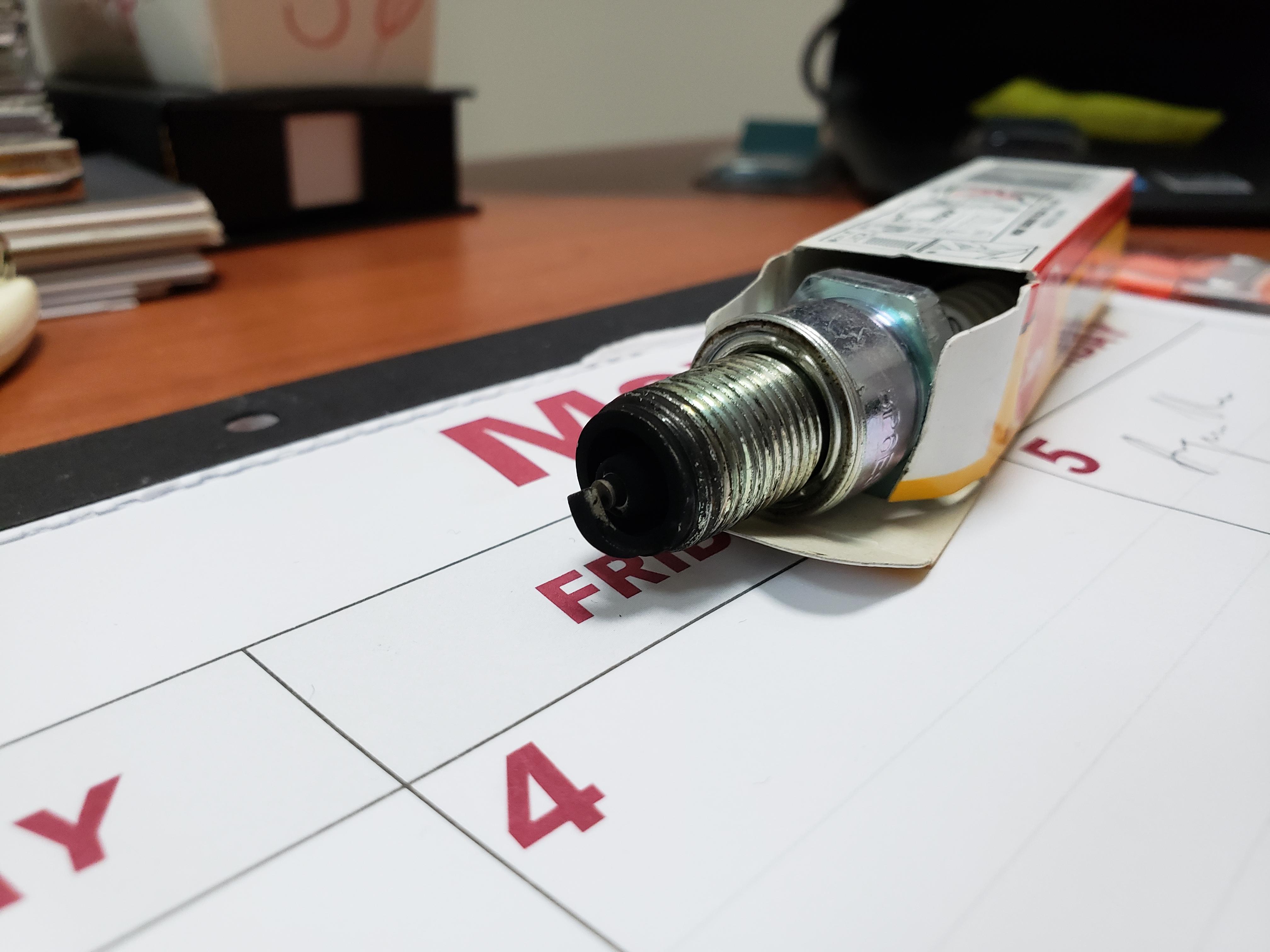

Well last night i pulled the choke 3/4 and crank the engine. Left the choke on for a minute, drove the car slowly until it warmed up and after that started accelerating but started noticing some hesitation. Got home and pulled plug number 4 which came out dark and i suspect it is clearly the cause of the hesitation. Now that i got a new cap and rotor should i clean the distributor with contact cleaner or should i just simply replace the old rotor and cap with the new bosch set? Im also replacing that plug as i guess it is already damaged.
 @jalexquijano Did you look at any of the other plugs? It would be a good idea just to confirm the rest look OK. If they look good I'd just replace the cap, rotor and # 4 plug. I don't think I'd spray anything just yet. If five of the six plugs look good the problem is narrowed down to the cap, rotor or plug wire, assuming the compression is still good. Do you have access to an ohm meter?
