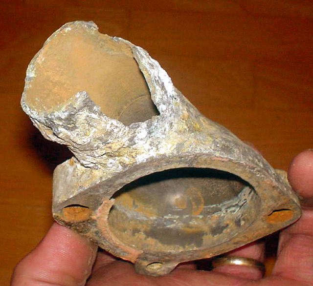

Mine's leaking too, on the other side (only, I hope). Fairly sure it's corrosion on the big hose barb that takes the lower radiator hose. Saw how bad it was when I changed radiator hoses -should have installed a new inlet at that time. Figured it would be too much of a chore to get the old corroded inlet out of there. Never do that. Guess it only leaks when it's hot. My engine usually runs on the cool side, except stop and go on the freeway on a hot day - when you can't pull over and check it. Felt a little moisture there though.
Wonder what's the best radiator hose without going silicon? Those braided OEM imitations are expensive and look a little thin.
Blue,
awesome photo.
Well replacing the gasket did not help. I will double check, but I think the hose is fine. The neck on the housing had some very minor corrosion, but I believe the hose seals up. It looks like the fluis is below that. So now I guess I get a pressure tester and see if I can get it to leak with the dizzy out so I can see where it originates????????
