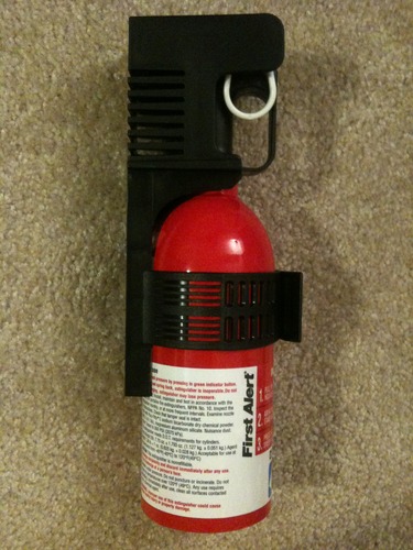

I just purchased two First Alert Auto Fire Extinguishers found on Amazon: First Alert Auto Fire Extinguisher - Amazon.com
4 1/2 Stars through 37 reviews, compact, and has a bracket to mount to.
I received them yesterday and they are great build quality. I place it conveniently in a side pocket in the 911 and behind the passenger chair on the Z car.

Speaking as a retired firefighter, be very careful with the mounting brackets. Most household brackets are not designed for cars and will become a dangerous missile in an accident. I have a 2 1/2# ABC extinguisher by Kidde that is 13 3/4" long and fits in the storage locker behind the pasenger. It is not that easy to get to, but in a wreck or roll-over it won't come loose and become a dangerous flying object either. And guys, take your dry powder extinguishers out once a year and shake them up to prevent the powder from caking and being a big disappointment when you squeeze the trigger. Also check the pressure gauge at the same time. It's easy to ignore the extinguisher until you need it. CO2 extinguishers would be less messy, but are hard to find in a small enough package, and they displace O2 so setting them off inside the car could be problematical.

That little thing doesn't look all that bad, though I prefer fire extinguishers which don't use any powder at all. FireAide has one, but it is small- the kind you'd use for a cooking fire. Tundra is another, but isn't UL approved (which some event promoters require.)
Most automotive fire extinguishers currently available use a powder agent, which I really don't care to use in or on a car or inside the car with passengers onboard.
Also, if a fire extinguisher is required, such as for a car show, some just recommend a working unit, others specify a working 5 B:C unit. This one looks fine, but in an emergency "just enough" usually isn't, so a 5A, 10 B:C is better.
