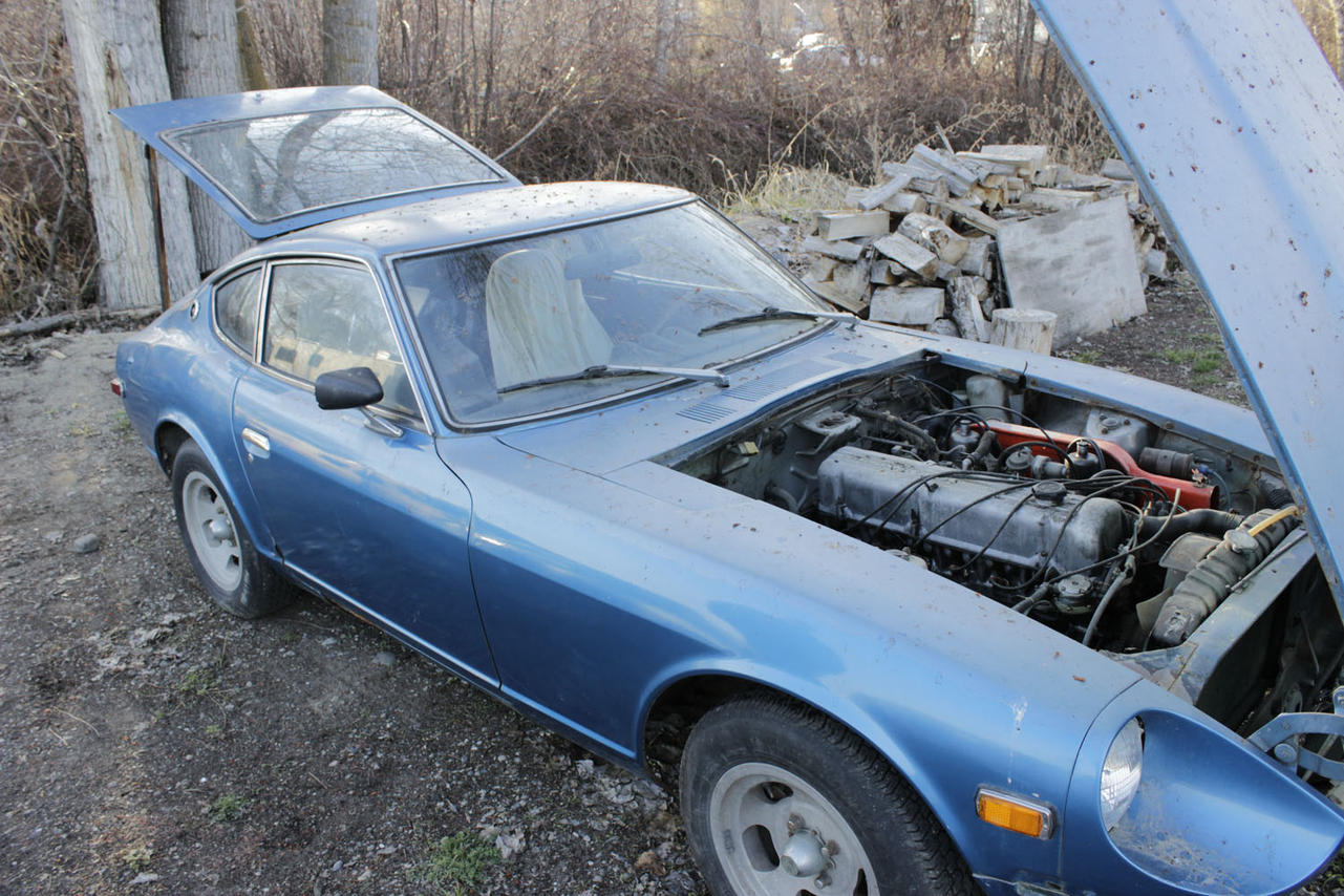

Hey guys,
I've been looking at building a nice 240z for a long time now, been hunting for a while for one in decent shape. Not looking to do a full showcar resto (although it would be nice), just want it to get it back to driveable and rust free, no engine swaps, maybe a few minor engine mod's to enhance the sound/feel of the base car.
A guy local to me is selling a '71 240z, and claims the car has 34k miles on the chassis, but was sitting in storage for 30 years (open air storage apparently.) He originally bought it off the first owner's son, and then let it sit in his yard for 2 years of rain and snow allowing the rust to build further, while waiting for a local shop to take on the car for a full resto.

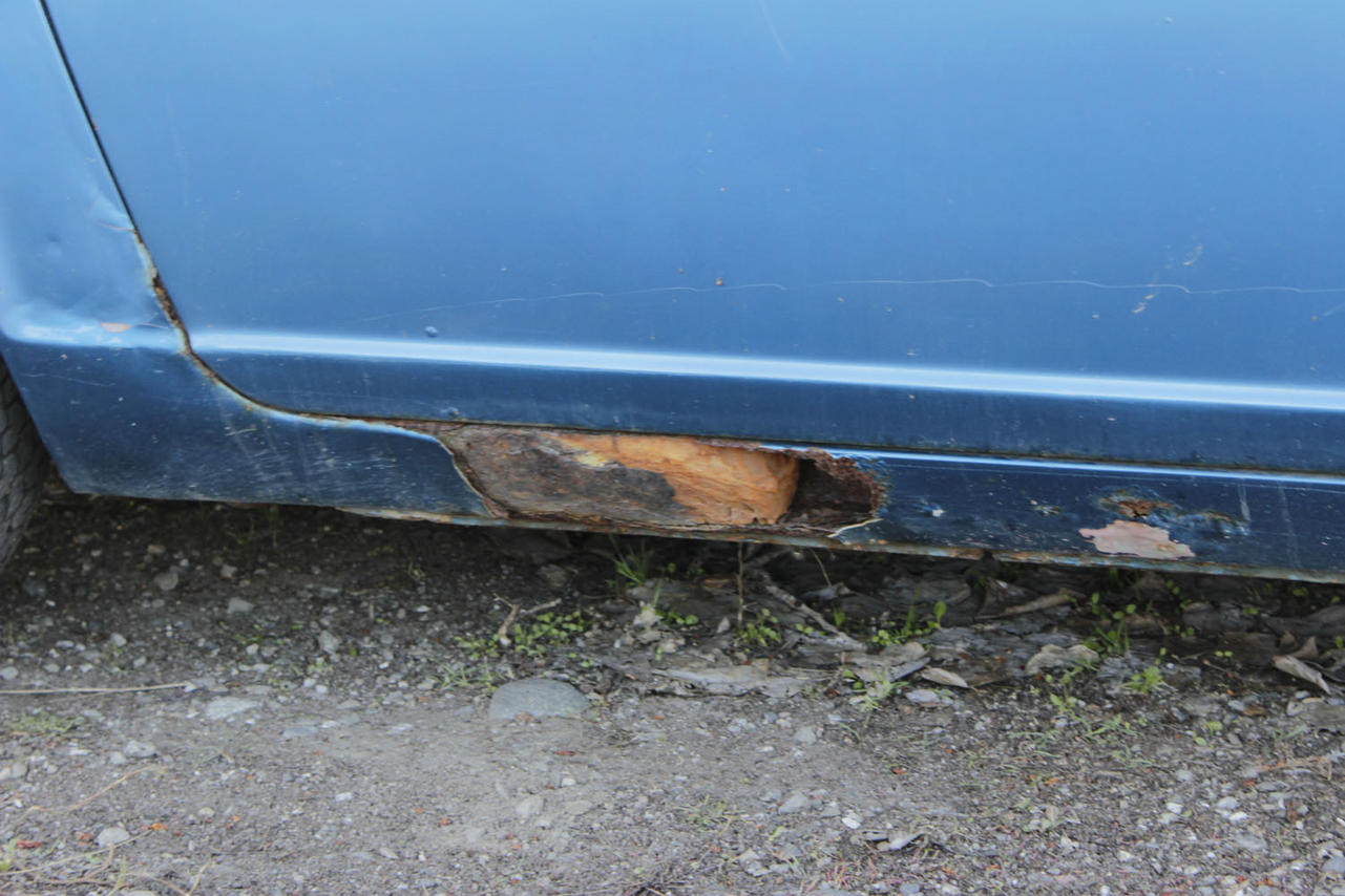

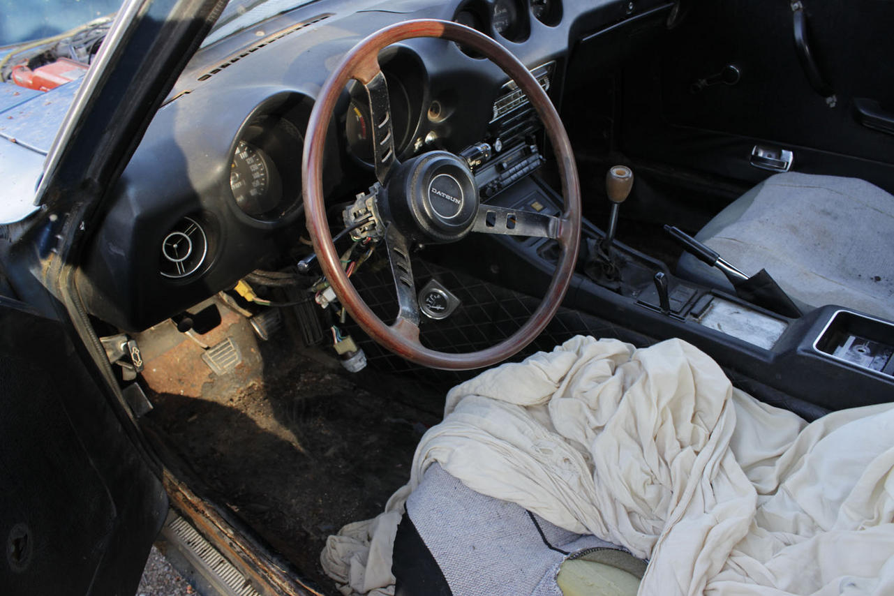

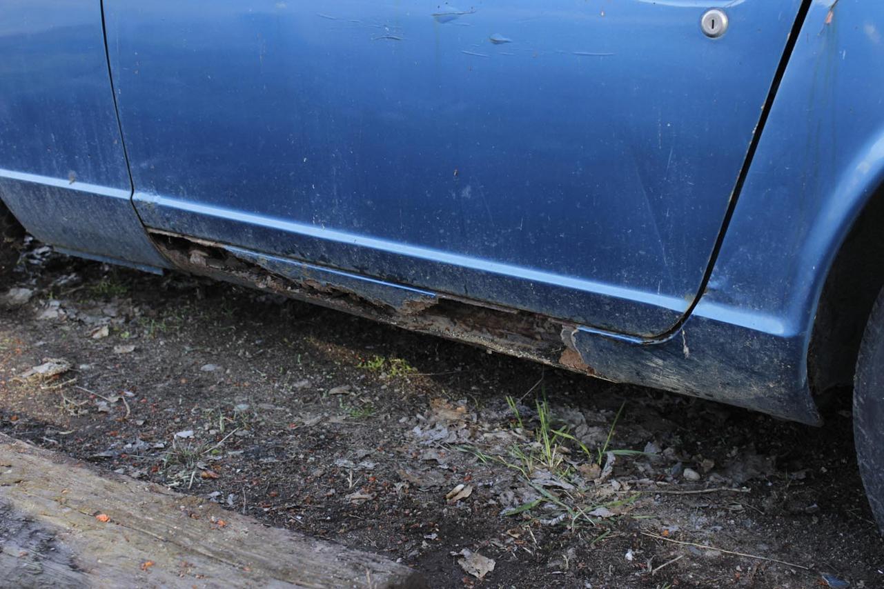

Said local is looking for 1500, im thinking of offering 1000$. Mechanically it seems to check out, all 4 + reverse gears pull, engine sounds fine at idle and during rev, needs full new suspension and brakes though. Some rust in the rear hatch, rear 3/4 part of the body. Rocker panels look completely gone. Engine bay seems largely intact. Wheel wells seemed ok. Haven't had a chance to look at the frame rails, but based on both the driver/passenger floor pans I'm assuming they're rusted too.
Should I turn tail and run? or pick it up and take on a long difficult but possibly extremely satisfying challenge? Mechanically speaking, any and all engine/transmissions/suspension etc maintenance and work I can handle, but in terms of body work, my experience is very limited. Like sanding away and filling paintchips limited. I'm definitely looking to learn (a LOT of learning) to do this kind of restoration? Should I turn tail and run and hope to find something less rusted?
Thank you for any advice or thoughts!

Being a body and paint guy by trade, I would pass...on this Z. You have a serious can of worms here...usually rust is TWICE as bad as it looks or more..if it has lived its whole life in British Columbia im sure under that repaint you will find LOTS more rust to deal with..I can see a lot behind the paint
in the few pics you posted.
If it were me, take the thousand or two you are going to have to spend on sheet metal, tools, body materials, and labor ( yours ) and find yourself a decent $3000-4000 Z that looks less rusted..they are out there..

Pretty hard to believe it only has 34k miles on it...I would be skeptical right off the bat...

It's the looks and excitement that make your forget the rest of the work that is to come on this 71 ! I'd go with what jackboxxx is saying... look for one with a better body.

Walk away, look for a better car, the rust issues that you see are only half the problems you'll find. A car thats running when you get there tells me there are other issues that may be hidden. Just my 2 cents.
Offer him $500.00.......part it out and use the money you make on parts to buy a car with a less issues......."jack up the radiator cap and put another car under it" .........this car is toast! IMO
