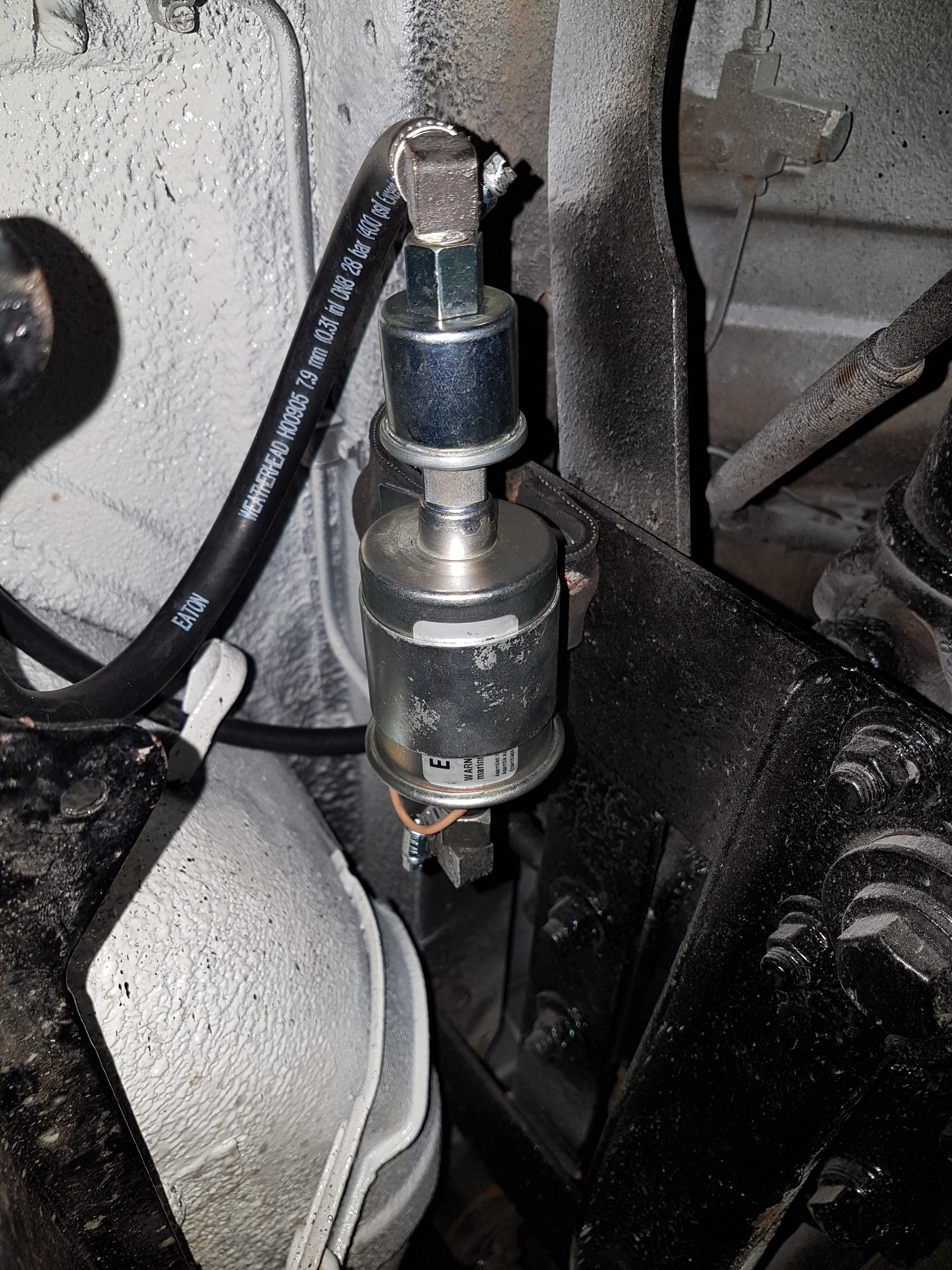

Mine probably won't get started for another few weeks due to other priorities. I'm hopeful that with the rubber pad I used between the pump and the mounting plate I have a similar outcome to Jeff's!

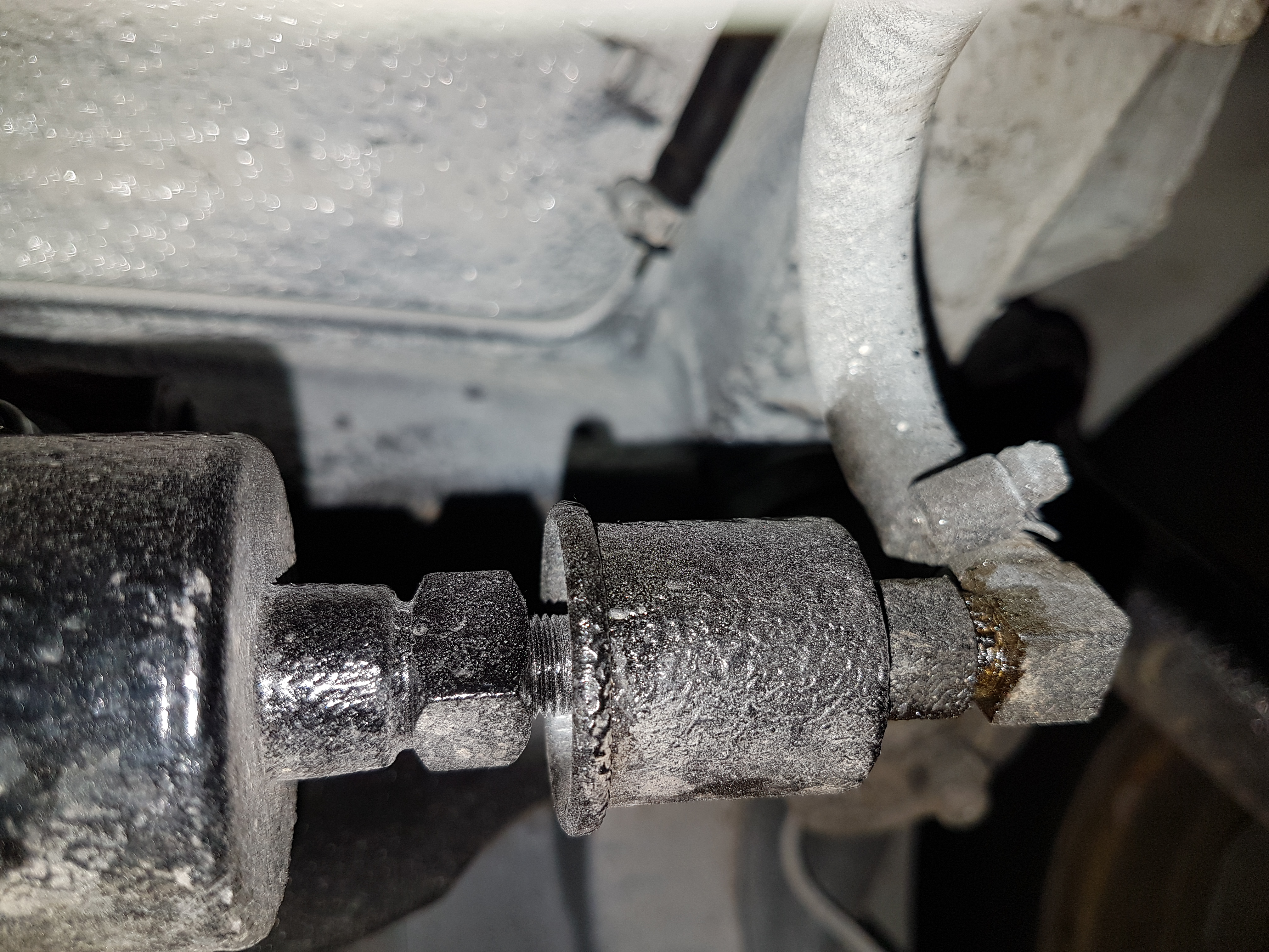

What is that clogged line from?
It was on the small section of hose just before the fuel filter. My hypothesis is the filter was catching some gunk and then it was sinking (gravity) while the car sat and eventually accumulated. I haven't seen this anywhere else. Clean fuel flowed out wherever else I've detached fuel line. Though it's been years since I did my tank, I don't see any other signs. Also, once I replaced this hose the car ran fine.

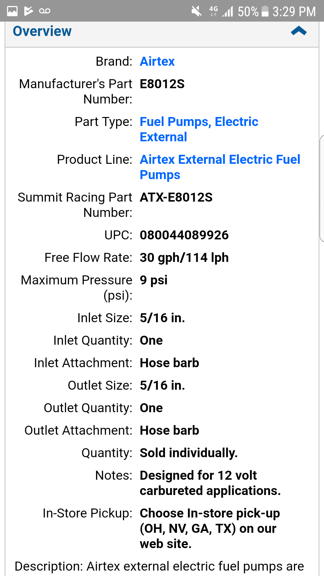

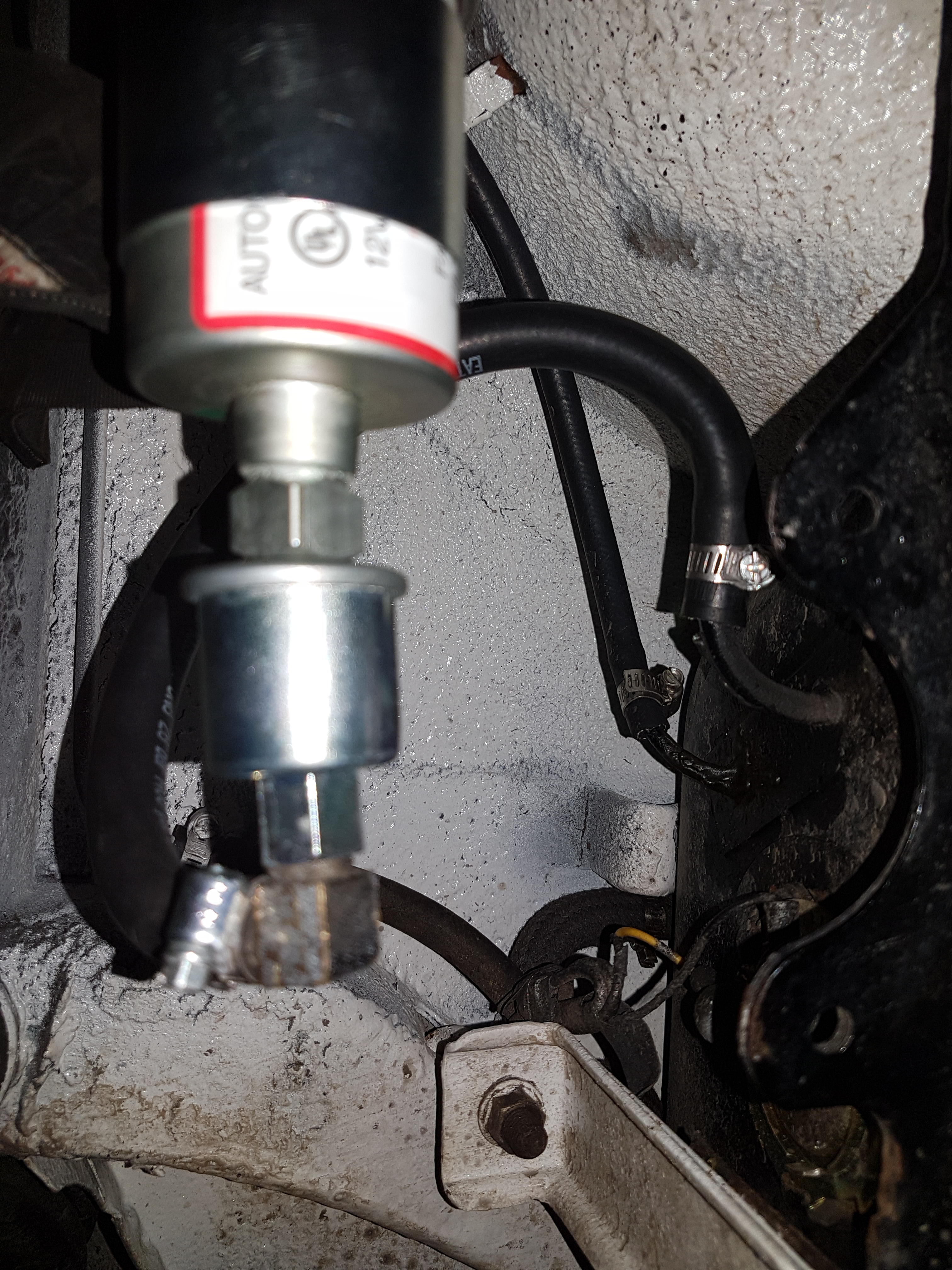

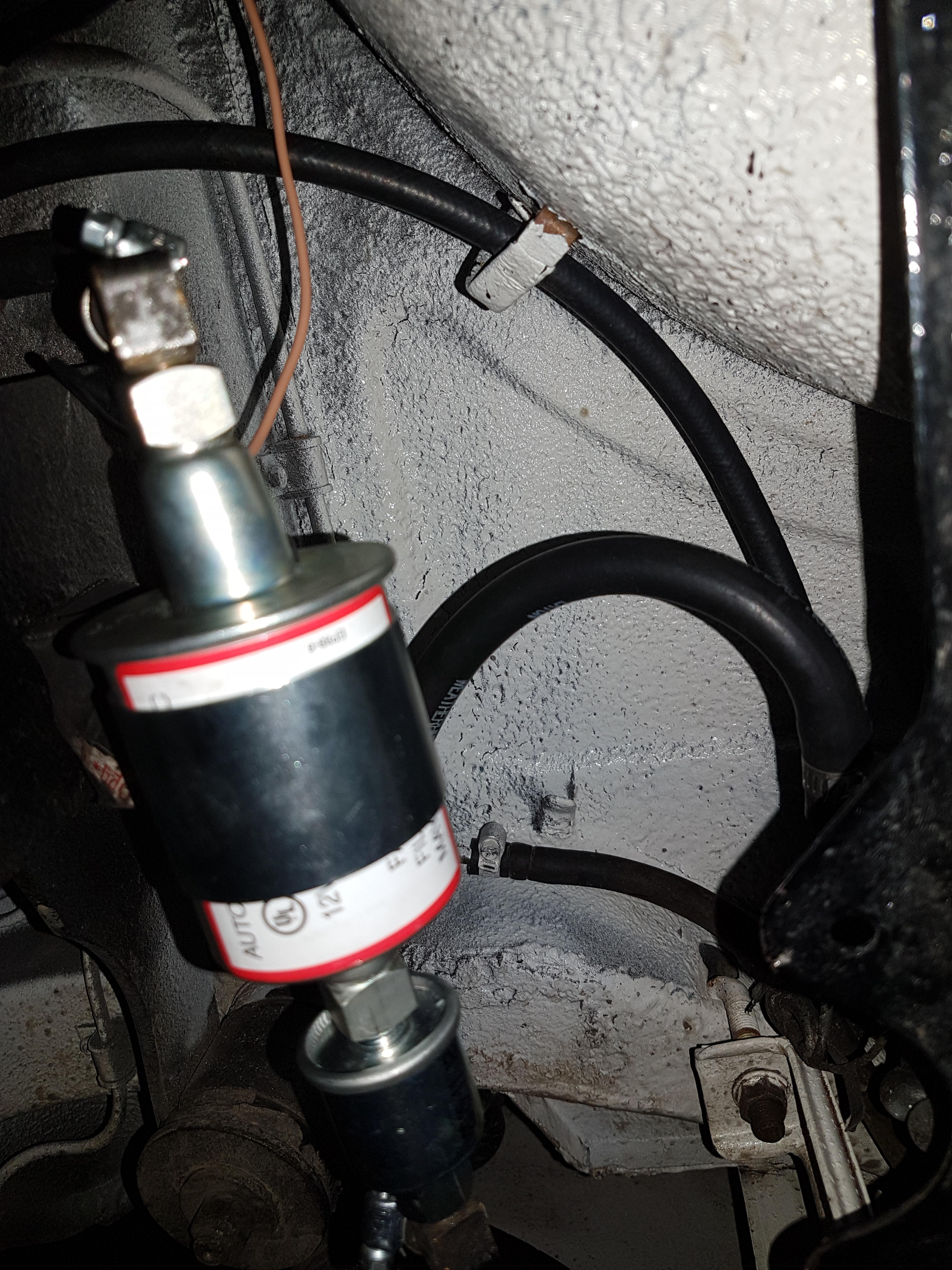

Well i am replacing mine with another airtex 8012s electric pump, as the actual one i just supplying 2.9 psi and my car is starving at idle. Whenever i go up a hill i need to open the choke. The pump was accidentally painted black when the car was restored last year. I am also considering to replace both 5/16 in and out of pump rubber hoses and clamps with new ones. Anyway, is it really recommendable to add and additional fram g3 fuel filter isnt the metal one that comes with the pump enough? I already have dorman glass fuel filter at the engine bay.

Do you think the hoses are correctly connected and routed allowing free pressure and volume flow?
If you have doubts about fuel flow to your carbs, do a capacity check using the figures I provided you in one of your other carb threads earlier this week..  You've already done a pressure check according to earlier posts.  Those are two quick ways to eliminate worries about pump based carb starvation.  Let me know what results you get after running the tests.
Dennis
If the pump is oriented in the proper direction and the clamps are tight, turn it on and check for leaks. No leaks, fire it up. You'll probably take it for a spin but if it doesn't run well, remember, we still need to verify the fuel height in the nozzles at 2 1/2 turns down. Then we can move on to fine tuning.
