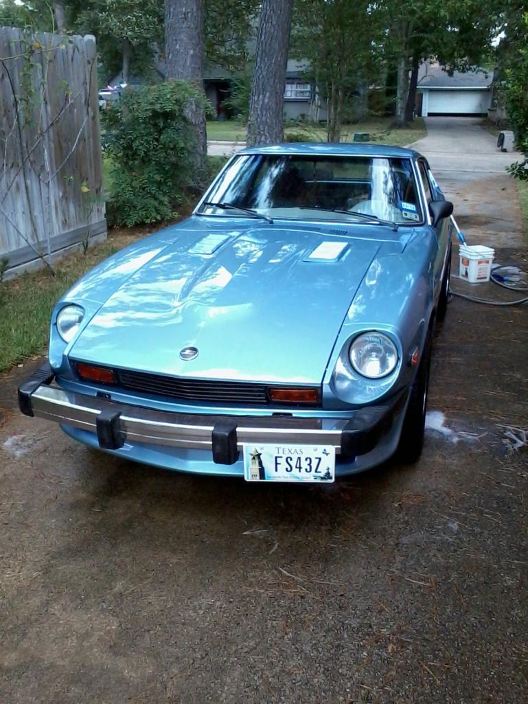

So, as I ponder the EFI Bible to debug what I think is an ignition problem, I am open to your suggestions. I am hoping that some of you have already encountered this problem and can lend a hand. Below is a picture of the misbehaving wench after her bath.;)
