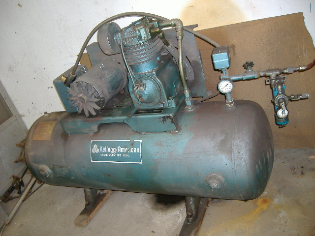

If you can wait a few weeks I am going to purchase a "barrel blaster" in Austin and bring it back to Houston with me. www.barrelblaster.com I am going to use it on my Turbo valve cover and all the brackets, pulleys, etc. You would be welcome to use it.

man, that thing is awesome Ben, I just looked at it. 12cfm of air at 80 psi, you would need a HAUS of a compressor to run that thing.
