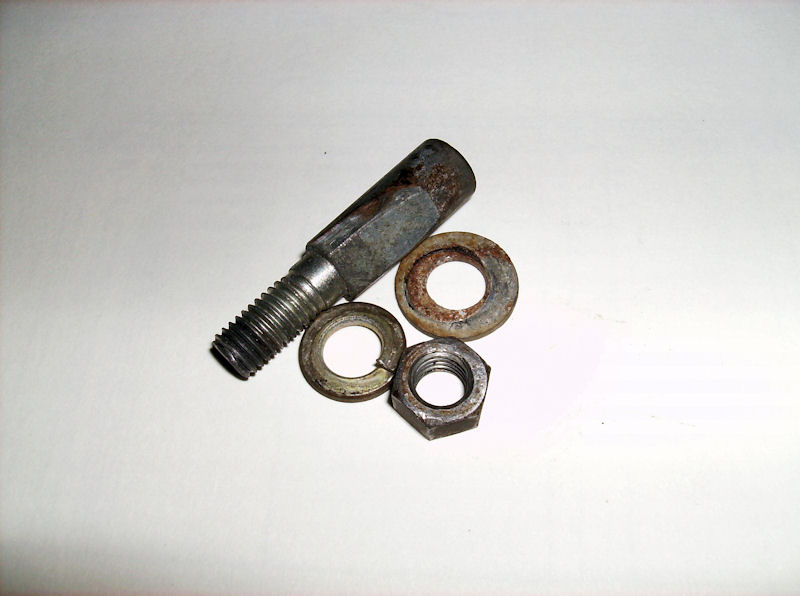

The stud you mention is a small tapered shaft with a flat on it. The flat matches a similar flat on the spindle and is intended to keep the spindle from rotating. It usually takes a liberal application of rust blaster allowed to soak in at least overnight to get the stud/shaft to release. A little heat may help, as might a very light tap with a small hammer to un-sieze the shaft. Hope this helps.

Here is a pic of the "stud" i.e. tapered shaft so you have a feel for what you are dealing with. The nut draws it tight against the spindle - if you tap on it, be sure to have the nut in place to not foul the threads.
Jim
Small tap? Bah! Put the nut on the end of it, make sure the nut is fully engaged, but NOT down tight, leave room for it to move, then HIT IT, square, with a 2 lb sledge. It will pop right out. You can also use a 5/16 pin punch to hit it (from the threaded end). There is just nothing subtle about dealing with these nasty notorius parts.

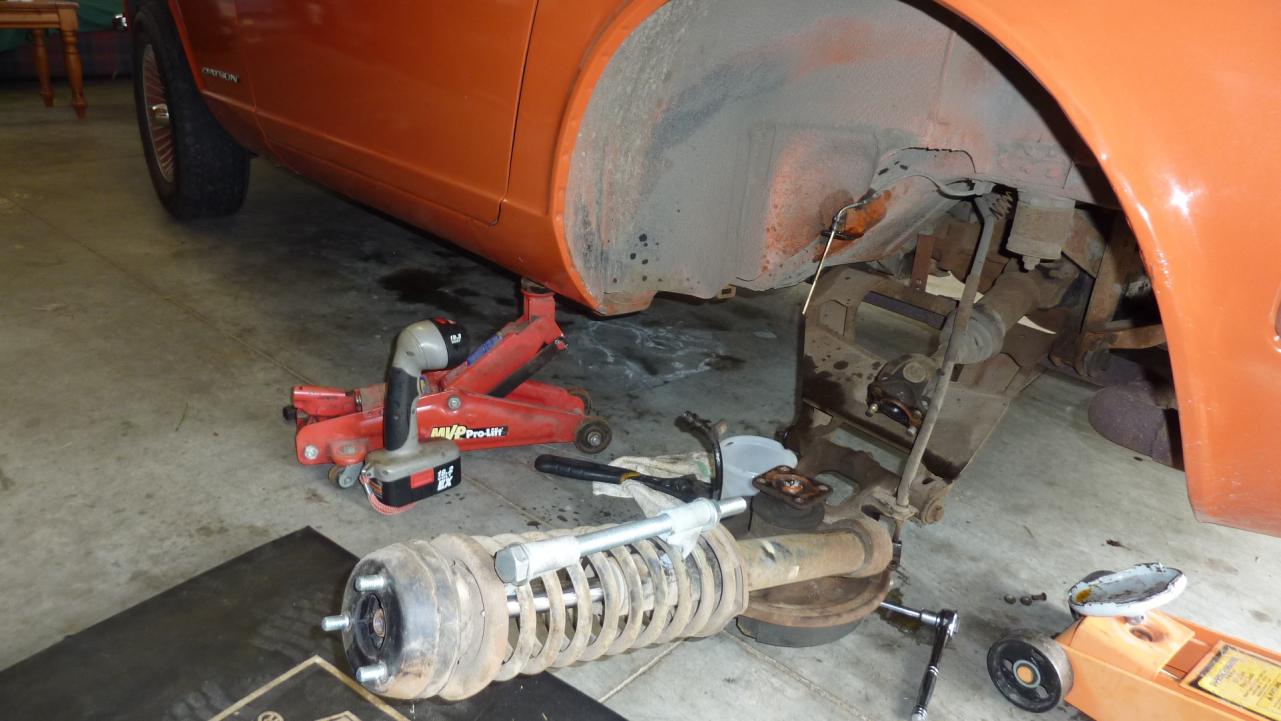

post-22283-14150819030541_thumb.jpgI did end up going this route. The strut rotated out with little effort. I did it on my parts car first. The good news is the 260z parts car has kyb carts and a factory sway bar on it. The old strut came out of my car with oil all over it. I cleaned out the assembly where the cart goes and put it all back together. I'm going to try and do the other side tommorrow and then the front end. I can really feel the difference between the side with the "new" gas cart vs the other side with an old hydraulic cart. I'm going to put the sway bar in when I get some urethane bushings. Between the sway bar and the gas strut carts I know my car will handle much better. Thanks for the help everyone.
Looks like how the pros do it (leave spindle alone until you do the bushings).
Even with a gas strut, I put oil into the assembly to keep rust out of the strut tube. They will rust inside...
On a side note, only one of your jacks match your Z's paint color...

Where are your jack stands???
Chuck
+1 on the jackstands. NEVER rely on a jack. They tip over and they are notorious for bleeding height. You don't want to get crushed by your Z. Otherwise, nice job. Be sure to add oil to the tubes. It is needed to cool the cartridge. Dampers generate a lot of heat and air makes a lousy conductor. Oil will carry the heat away from the cartridge to the outer tube where the air can cool it.
