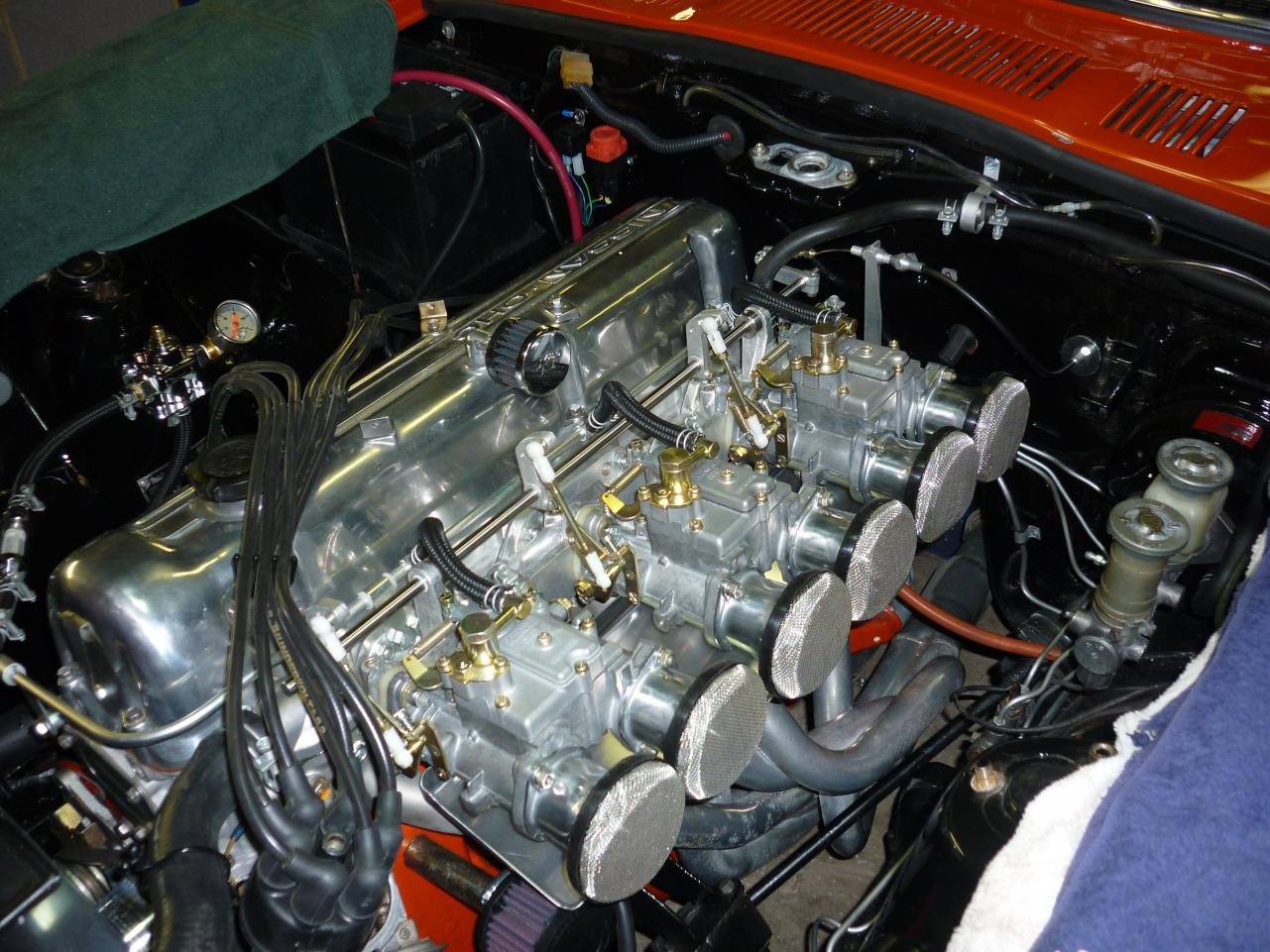

Why do I have to run an electronic fuel pump and then run a regulator to get the same output as my old mechanical fuel pump. When I pull out the mechanical pump, do I just use the L28 EFI plug that sat where the stock mechanical fuel pump would be? Do I want to put the electronic one by the fuel tank or will it matter? Will the filter go after the pump or before it? Do i need to get a different one aside from the OE style?
Put the low pressure fuel pump near the tank so that it primes by gravity and so that it pushes the fuel.
You can put a filter between the tank and pump to protect the pump and carbs.
The carbs have built-in filters that should catch bits if your pump starts shedding impeller metal/coatings.
A regulator near the carbs and feeding them ~3.5 to 4 psi (measured at the carb) is required.
Cap off and seal the head where the mechanical pump was removed.
Do not use a high pressure fuel injection pump unless you have a good fuel pressure regulator with a bypass outlet for feeding the return line.
An unused power lead in the harness runs from the fuse box area to the fuel sender area.
You can use a 78 280z oil pressure switch and a relay to control the pump operation safely.
