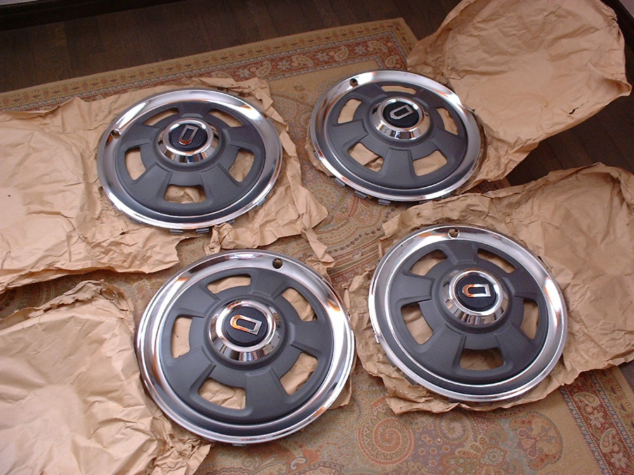

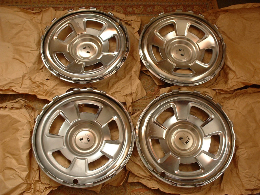

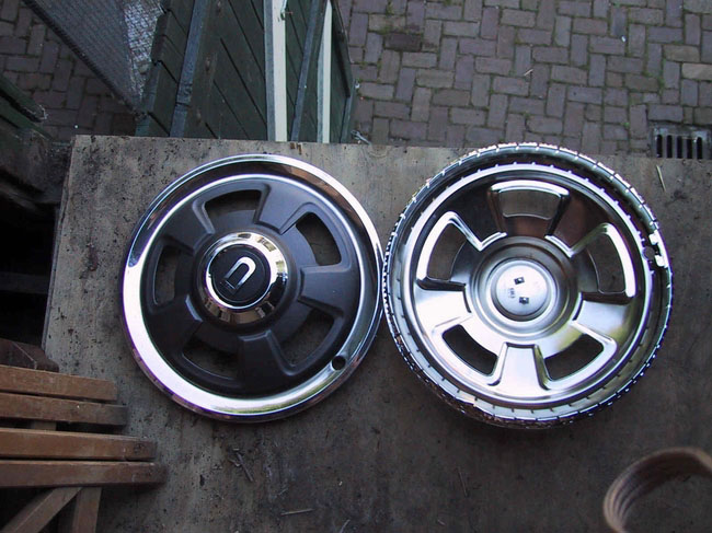

April 28, 201114 yr comment_354362 Boy, has this topic been thrashed over the years. An archive search is suggested from Her Majesty. In the mean time the attached pictures should help. 'D' hubcaps, or wheel covers, came in two styles. The early style had fewer spring clips to mount the wheel than the later style. The location of the air valve hole is different between the two styles. You are reading correct information here. They were chromed with the grey (anthricite), metallic, matchstick finish that matches the grill and the tail light valance. I know we have argued about this but I'm in the matching color camp. The actual center caps with the 'D' are chromed plastic with a black matt finish paint. There are other center cap designs like the chorme hexagonal center nut you see on early domestic market cars. Enjoy the pictures. Link to comment https://www.classiczcars.com/forums/topic/39405-original-d-wheel-caps/#findComment-354362 Share on other sites More sharing options...

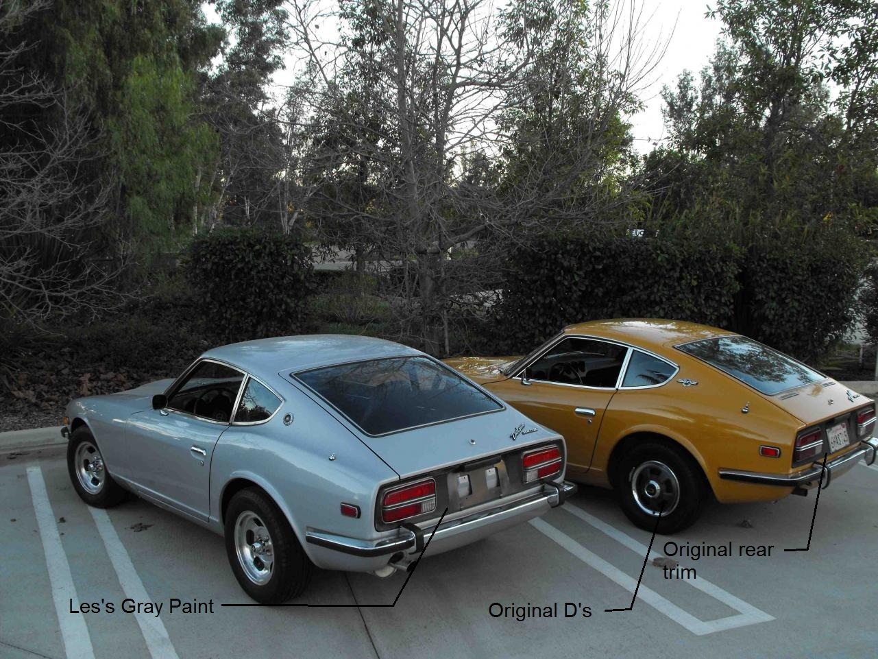

April 28, 201114 yr comment_354375 From the pics, The original hubcaps and rear trim color do look fairly close. Les' paint is lighter but also 41 years younger. A shameless excuse to show off my babies. Link to comment https://www.classiczcars.com/forums/topic/39405-original-d-wheel-caps/#findComment-354375 Share on other sites More sharing options...
