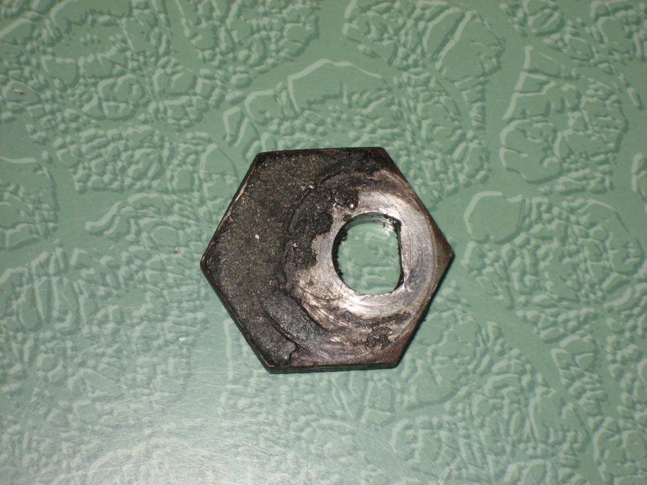

woytovich Posted June 21, 2010 Author Share #13 Posted June 21, 2010 So... can anyone tell me the purpose of the cut bolt and this matching "washer"? It appears to facilitate some adjustment of the transverse link but I cannot find reference to it in the workshop manual.... Link to comment Share on other sites More sharing options...
zKars Posted June 21, 2010 Share #14 Posted June 21, 2010 Mark:See the other post. Those bolts are not stock. This is a "clever" (other may have a different word for it...) attempt at camber adjusting me thinks. Link to comment Share on other sites More sharing options...
geezer Posted June 21, 2010 Share #15 Posted June 21, 2010 (edited) I have the same or similar that I have been unable to remove without damage. The washers are made of aluminum and are galled tightly onto the bolts. I think you will be able to substitute the bolt & nut with an aftermarket alternative if they are NLA.Edit: Here is a better view of the stock bolt, nut, washer and bushing (15, 16, 17, 14). Edited June 21, 2010 by geezer Link to comment Share on other sites More sharing options...
Terrapin Z Posted June 22, 2010 Share #16 Posted June 22, 2010 What you have in you car is a camber adjustment kit from Specialty Productshttp://www.spcalignment.com/PROD_DIR/SPC_PROD_SEARCH_DYN.cfm?cmd=Cam&cmd2=83115&cmd3=When I took my car in to get it aligned at Les Schwab. the guy pulled that exact kit out saying it was the oldest parts he had and was shocked that he had it at all in the first place.Check out the installation instructions, what they do with that is cut a larger hole in your front cross brace 54401-E4100. install the eccentric and adjust your camber. You can never go back, once the hole is cut the stock bolt will no longer fit. To be stock again you would need to get a new cross brace. Link to comment Share on other sites More sharing options...
woytovich Posted June 22, 2010 Author Share #17 Posted June 22, 2010 YIKES... so what was installed was the stock bushing and this kit - that means the "insides" were not correct for the "outsides". I THINK this is really not good, dangerous even. Link to comment Share on other sites More sharing options...
