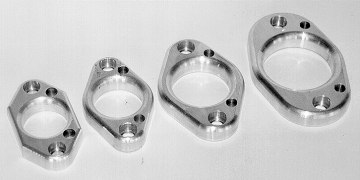

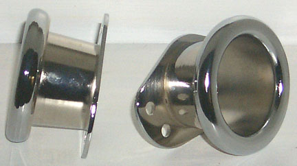

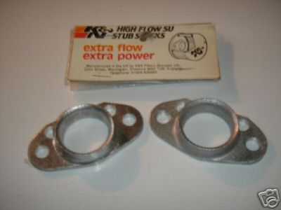

I've been looking at various stub stacks for SU's and I'm wondernig if anyone here understands the function of these things enough to know which design is best. I've attached a few representative pictures of the various designs I've seen (including a longer ram jet but I'm not really too concerned about that because it's difficult to use with an aftermarket filter such as a Ramflo or K&N). But anyway I'm wondering if the circular one is best because of the overall symmetry, or if the smaller thin cast ones have some advantage because of the smaller size and shallower mounting area. Or does nothing but the curvature and length really matter?
The first one is a cast stub stack made by K&N. A similar part is available from aptfast.com for 1.75" "HS6" style Z SU's. The Billet stub stacks are also from aptfast.com as well as the ram jet (4th picture). The round one (3rd pic) is from a Mini and won't fit a Z but there maybe some out there with 1.75" bore. The are all for use with aftermarket filters of course.

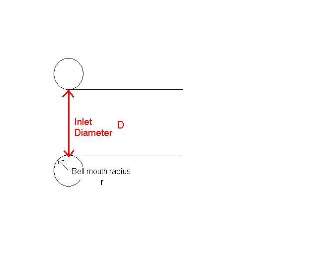

I was pretty unclear on what's what, sorry! See the attached pic. You want to maximise the radius on the bell mouth, r compared to the inlet diameter D. An r/D of 0.1 is OK but you wouldn't want to go much smaller, an r/D of 0.2 is twice as good again but the effect tapers off after about r/D of 0.25.

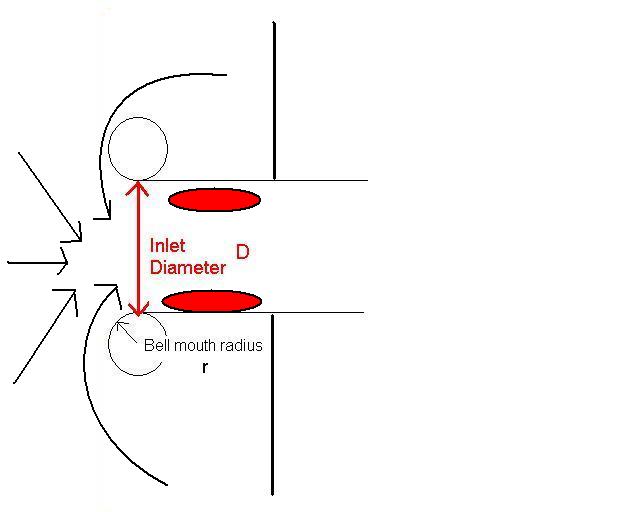

It is also worth noting that if the stub stacks stick out (as most of them do) the flow becomes what is called re-entrant, which can create more losses. This is due to the big sweep that the incoming air does, causing vorticies (swirling, energy eating air) depicted by the red ovals on the third picture in the inlet. The negative effect that this has is almost exactly equal to the positive effect of a good bellmouth, which is possibly why many people experience no gains from installing them. Just me guessing on this though.

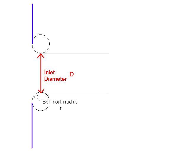

The blue lines on the second pic show how it should be done, the red ovals on the third pic show the vorticies cause by the flow coming from the sides.
