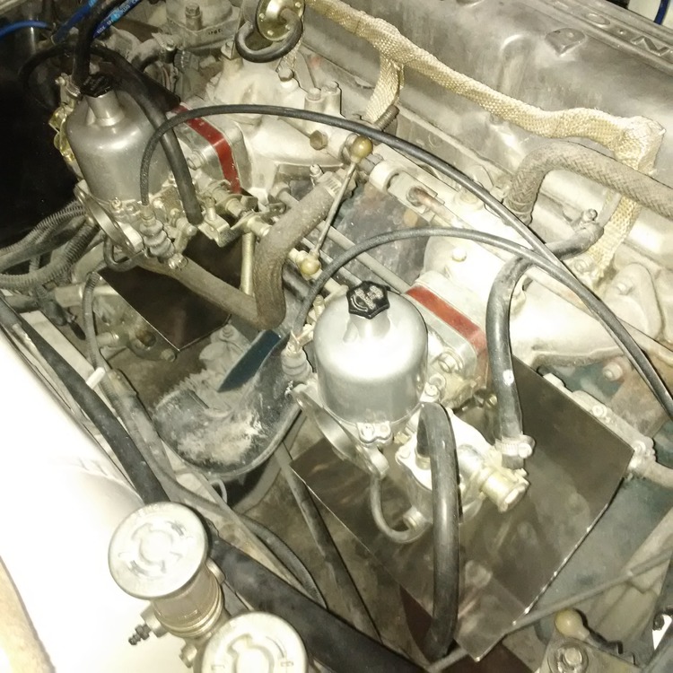

Improvement?? Im still stucked and trying to tackle this heat soak hesitation or whatever it is during traffic jams even after installing an aluminum heat shield extensión as in the picture attached and swapping the spark plugs with NGK BP5ES (hotter) to keep them from fouling during short stops and traffic lights. As the cam i have is a Schneider 274F and has an RPM range from 1800 to 6000, he recommeded to raise my idle to 1100 instead of the 1000 i have it set at.
We checked the PSI pushed by the Airtex 8012S electric fuel pump yesterday and it showed 2.5 to 3 psi.
Still clueless on how to solve this!! Will test the car again at 1100 RPM idle tonight.
I left the fuel lines as is. When I was testing today, I could see they were being subjected to a fair amount of heat, and I could feel it on acceleration. It makes me wonder if it would be better to make a new fuel line that would go closer to the carburetors.
Try putting fuel pressure regulators between the metal fuel rail and each carb (2 regulators) and run. Stronger psi through the main fuel line (bigger pump). I would not for for a fuel injector pump as 60-90psi will blow out the fuel lines, but a steady 10psi should prevent percolation
