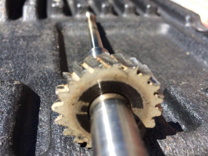

Posted April 17, 20178 yr comment_518313 Last year during an 8 hour endurance race, my 260Z started missing and running like crap before it dies completely. We tried to diagnose the issue at the track and finally had to throw in the towel that race. We could not get the car to start no matter what we tried. Everything looked normal with the timing, valve springs, plugs, etc, but it wouldn't start even on starter fluid. We parked the car in the garage and until today, we had no idea what was wrong or how much damage was done to the engine. Today, we pulled the plugs and looked in the cylinders with a borescope. Everything looked great. We then looked down the front cover and all looked normal. The chain, tensioner, and crank gear looked good, but I couldn't quite see the drive gear on the distributor shaft. We then pulled the oil pump and all became clear. The drive gear on the shaft was a mess. The teeth were stripped. We then drained the engine oil into a paper towel and found no debris. Next, the oil pump came apart and looked okay, but there were signs of small debris going through it. Hopefully, when we pull the engine and tear it down, we won't find any damage to the journals. I think we'll be okay, but it's a shame to pull it apart again. What causes the shaft gear to strip? I have never had this failure before. The shaft gear looked great when we built the engine which now has about 20 race hours on it. The oil pressure was always good right up to when the engine quit, so it was clearly still spinning, it just couldn't keep timing correct. Link to comment https://www.classiczcars.com/forums/topic/57517-distributor-shaft-gear/ Share on other sites More sharing options...
April 17, 20178 yr comment_518320 I think that the gear is just a press fit on the shaft. Yours look like it might have moved, there's a colored spot on the shaft. Also looks like it might be bronze or some other non-iron based metal alloy. I don't know what the stock gears are made from but maybe yours is aftermarket? And not as durable as Nissan stock. I always wonder when people worry about debris making it to the bearings. That oil is supposed to be filtered, so only material smaller than the filter limit would make it, or if the filter clogged and the bypass opened up. Just saying. Cut open the filter and you might find the rest of the gear, in oily dust form. Link to comment https://www.classiczcars.com/forums/topic/57517-distributor-shaft-gear/#findComment-518320 Share on other sites More sharing options...

April 17, 20178 yr Author comment_518324 Zed Head, the shaft came from the donor ZX engine which appeared to be all original with unknown mileage. The cylinders were in perfect shape as were all of the journals. I'm sure you are right about the filter collecting any gear debris, but I'd hate to blow up in my next race because of stray shavings. Thanks Guy, I will look around. The engine is all 1982 ZX stuff and since I rebuilt it, has about 20 race hours on it. Previously, my L26 engine had about 60 race hours on it and the gears looked like new. Oddly, the gear on the crank has no damage at all, at least when viewed via borescope. I will replace the pump, shaft an crank gear. Link to comment https://www.classiczcars.com/forums/topic/57517-distributor-shaft-gear/#findComment-518324 Share on other sites More sharing options...
