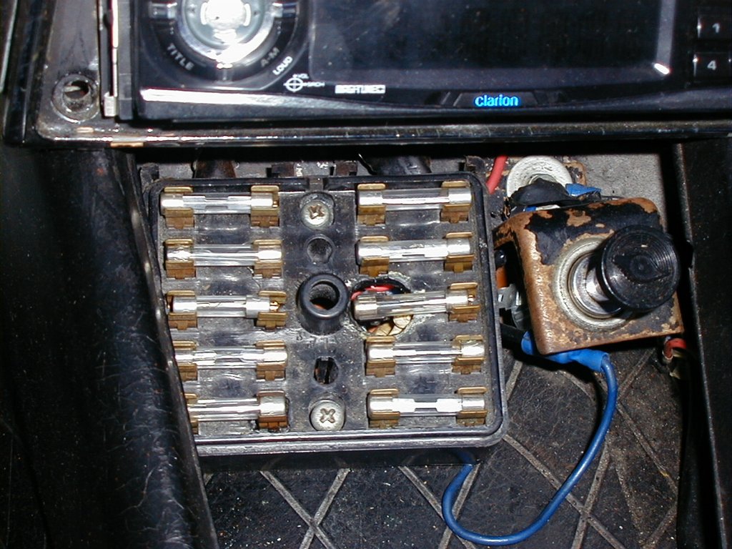

Here's a pic of mine that melted sometime before I bought the car. It is the third one down on the right side that melted (not sure what that is for).
The easiest thing would be for me to replace it with the one from my '73 parts car if I could then I could worry about rebuilding it later and not be rushed to complete it and take the chance of doing something wrong.
HEY!!! That looks like you took a picture of my fuse block before I fixed it! Same big gaping hole! The JB Weld will work , but there is a trick to keeping it in place while it sets up:
Mix the stuff up and then let it sit for a bit before you put it in place. Let it get a little like a paste. Otherwise, you'll end up rolling the fuse block over from side to side to keep the stuff in place (it will want to flow out due to gravity) for the next few hours.

I had a really hard time trying to solder the contacts on the back of my fuse block. There is a layer of some dielectric film over the metal that just made the solder bead up on the surface. I sanded it pretty well, but it seemed to be more trouble than it was worth (especially when another member gave me a good deal on a clean used fuse block) to clean out/flatten the back head on that rivet so it would hold on. My box was the short pigtail version.
I don't have a picture of my original block, but you can see what i'm talking about in the picture of the good one.
http://www.classiczcars.com/photopost/showphoto.php?photo=3997&size=big&password=&sort=7&thecat=500
My original block looked just like the picture TexasZ linked of his. I actually failed an inspection because of it! The parking lights wouldn't come on after I drove it to the inspection station (on the last day that the registration was still good!). Didn't figure out until I got home what the issue was. Seemed the combination of some corrosion and the loose joint (not held in tension by the plastic) caused the connection to be intermittent.
