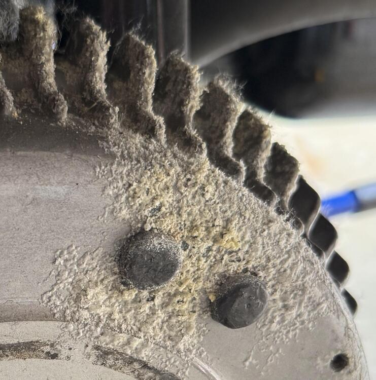

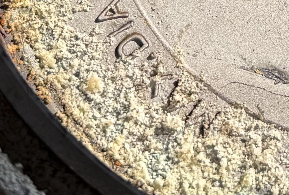

I’m curious just looking at the pics, Crazy as it sounds it looks like saw dust material is on the inside and outside of the drum.

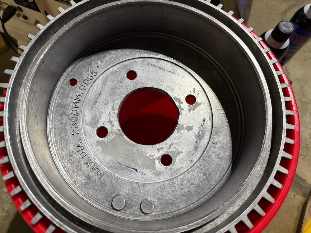

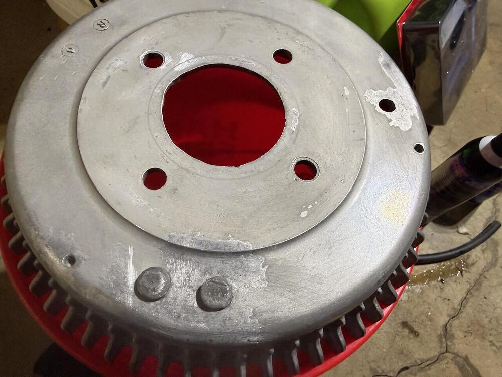

I cleaned up the driver side drum. It turns out some PO painted it in a silver color. Must have been good paint... don't these things get super hot? Those radiator fins aren't there for looks. Anyway, the brake fluid got to it a bit. Did Brakleen and then steel wool and then sanding. Doesn't seem in bad shape really. But anybody see any red flags? (I don't really know).

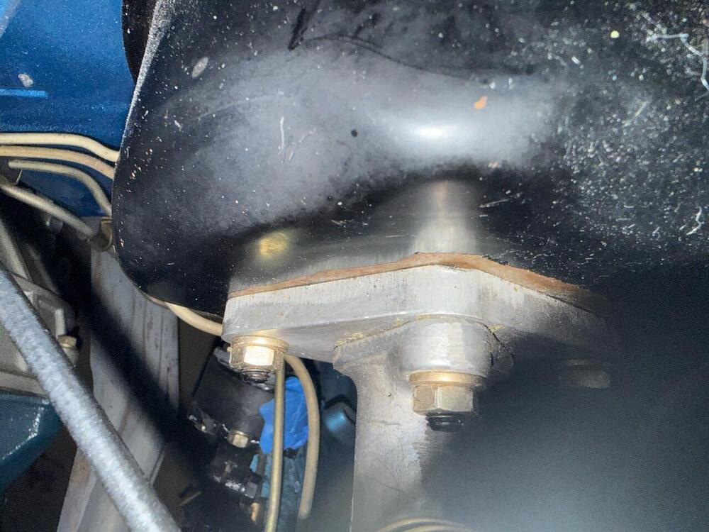

I haven't had a chance to pull it forward, but I will later today. Is this the kind of paint peeling you were thinking of?

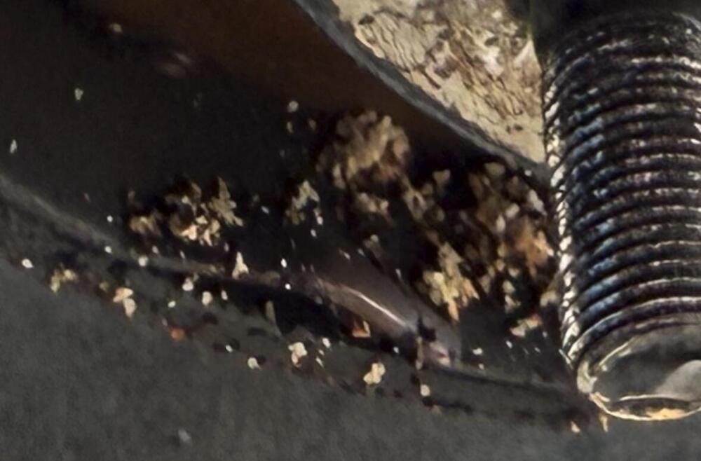

I think that's just a photo resolution thing. I looked again at the photos I posted, and yeah, it does kind of look like sawdust. weird. but up close, it's crystalline. I think it reacted with the paint on the drum to create that effect? Other places it's just separate crystals of whatever is left after evaporation.
outside where it interacted with the silver paint it's weird and hairy and like something from an Alien movie. other places it looks like bread crumbs.
