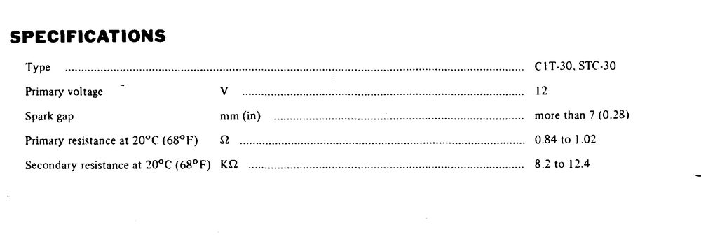

Interesting discussion. I'd like to find a coil that actually makes a claim as to what it's primary and secondary resistance is. I can find 1.5 ohm coils all over the place, but anything less than that is almost non-existent. I messaged a few people on ebay and asked if they could report back their readings. We'll see. I'm sure 1.5 ohms would be fine, but if I'm gunna pull the trigger and buy something, I'd rather get something that matches the FSM:
I hate to say it but I don't think that you can trust most aftermarket parts today. Everybody is buying from Asia and they probably don't want to get tied to a specification. The primary spec. on the only part that had a spec. was huge. It was 1978 when Nissan created their 0.84 - 1.02 spec. About a 17% range.
The Wells coil today, above, is 0.7 - 1.4. 50%. Not even close to the Nissan spec but they're selling it as a replacement.
