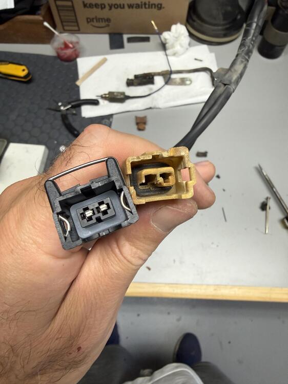

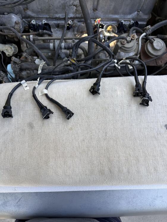

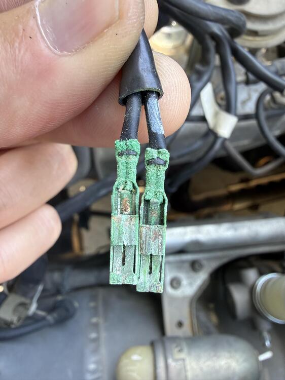

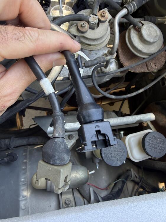

One more thing checked off the list, new EV1 connectors for the injectors, cold start, AAC valve, and thermostat housing sensors...

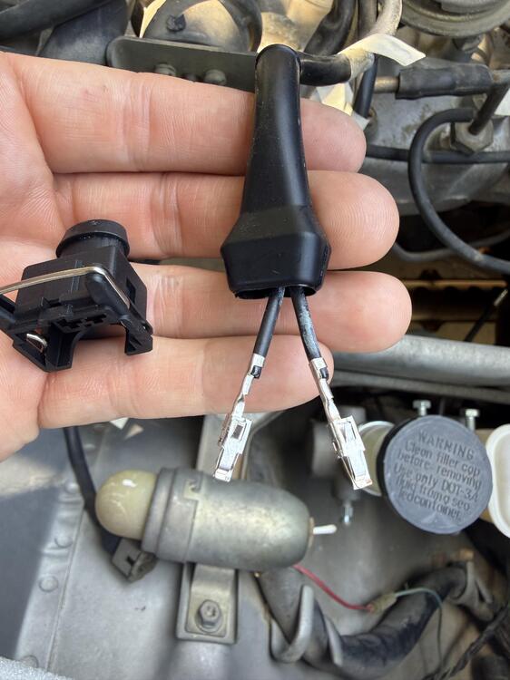

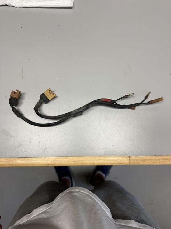

Thermostat housing connector harness...

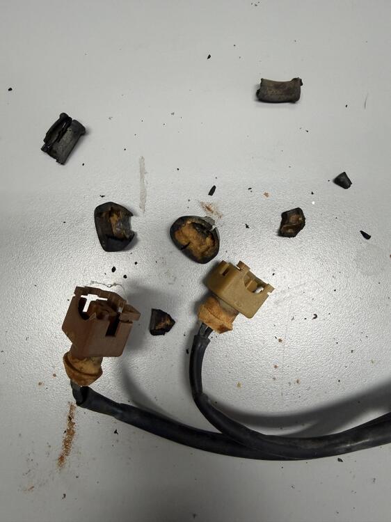

Extra crispy!
Old vs new...
Green means good, right?;)
New connectors going together...
I'm just as excited about the new rubber boots being pliable again...
All 6 injector connections done...

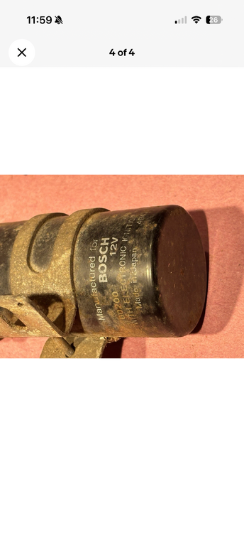

Still waiting on the injectors to come back from the refurb shop. Also bought a used and hopefully original Bosch 280zx coil off eBay. Seller couldn't be bothered to put a multimeter on it, so we'll see when it gets here.🤞

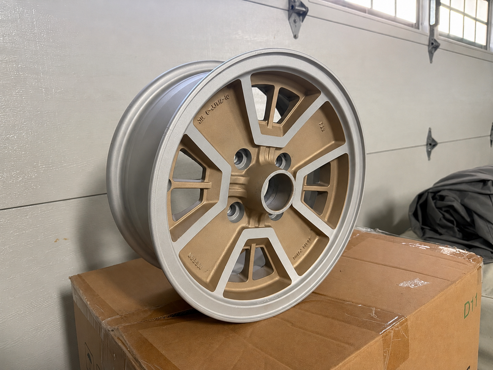

Also still working on my wheels side quest. My research leads me to believe the original gold color on the 280zx 10th anniversary wheels is golden mist metallic (690). Ordered up some custom 1K spray cans from R&E Paint and will topcoat everything with their matte 2K clear. I'd like to maintain the dull "not shiny" look that the freshly blasted aluminum already has. Really not looking forward to masking them off, but oh well. Here's the end goal, thanks ChatGpt...

Cool, used 280zx coil arrived today. Primary measures 1.0, secondary 10700, both nicely within the FSM spec. And cheaper than anything new at $25. Appears OEM, made in Japan, Bosch 00200, “use with electronic ignition” markings.
Not the prettiest on the outside, but correct on the inside👍🏼
