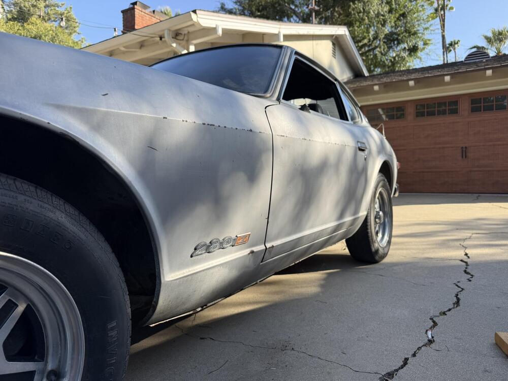

Some of you saw my post a couple days ago asking about swapping an auto to a manual on a 78 280z. Welp, I got to see the car in person today, and I decided to roll the dice on it. I've been on the hunt for a couple years and this one checked almost all the boxes. Time will tell if it was the right call...
PROS:
  1. It runs and drives and stops. The gas is definitely varnished, I could smell it bad. But it still ran, with a little miss here and there. Moved around just fine and went through all the gears.
  2. The price was fair. I knew getting an AUTO car would help keep the price down.
  3. Car appears to be a lifelong California desert car. Rough on the paint, but great for rust prevention. Doglegs and lower fenders are in great shape. Floorboards and subframe all appear very dry. Battery tray has surface rust, but I've certainly seen worse. Rear hatch area has a few bubbles, but not rotted. The cowl has a pinhole and bubbles located right above that foam block that sits underneath it. As you all know, it's not a matter of IF a Z has rust, but rather how MUCH rust it has. Pretty pleased in the rust department.
  4. No side molding! No holes in the sheet metal. I like that.
  5. Could it be a 70K mile car!? No way! I'm probably dreaming. I'd be shocked, but maybe. Pedals don't appear worn down. It appears largely stock and un-modified, apart from the wheels. Take it with a grain of salt, but the owner said they bought it from a neighbor whose wife passed away, and it was her car. Who knows, but I would be thrilled if this were the case. Let me know if you have any ideas how I might know.
  6. The engine sounds quiet. The usual tick tick of the EFI, but I was pleasantly surprised, even with junk gas. With the cats and the muffler, I can barely hear the exhaust note. Very quiet overall.
  7. POSSIBLY 90% original paint. Radiator paint code is present (code 306) which matches the exterior. And I don't see any tell-tale signs of a repaint (overspray onto rubber molding, gas tank, door jamb placard, etc. This makes me happy because I know you can hide a lot of bondo with a respray. I can visibly see all the right "seams" and joints where body panels come together (rear valance, dog legs), telling me they haven't been smoothed over with filler. I say 90% because the drivers rear quarter definitely had some work done at some point. I see evidence of bondo on the bottom lip of the rear quarter. Can't have it all, I suppose.
CONS
  1. No smog certificate. Seller wasn't willing to hassle with it. Having met the husband/wife sellers, I don't suspect any mal-intent, they just didn't want to hassle with it, and knew it likely wouldn't pass. They've had it on non-op for 5 years, never actually drove it, other than around the block. They had several other people lined up willing to buy it as-is, no questions asked, so I knew it'd be a dealbreaker if I put up a fight. I knew if I didn't buy it, it'd be gone within hours. So I'm rolling the dice here, because I'm in CA and it's a 78, which means I'm going to have to smog it. I know, dumb.
  2. It's an automatic. Positive spin, the autos weren't as abused as the manuals:) I'm planning on converting to a 5-speed eventually, so this isn't too big of a deal.
  3. Paint is clearly shot, but I'll be leaning into the "patina" look anyways.
  4. Drivers door hinge lost its detent stopper, overextended the door, and bent the corner. I think I can work it back into place.
    Anyways, here's a few pics! I'll keep y'all posted on progress, I'm sure I'll have questions...😄

Thanks everyone for the input👍
Yes, as much as I want to dive into other things on this car, first order of business has to be getting it tuned up enough to pass smog.
I'll research how to check injector flows and clean up the electrical connections as mentioned on Atlantic Z. The gas is clearly varnished so I'm going to start by draining that, then maybe dropping the tank and taking a peek inside.
Small victory though, I couldn't resist doing something about that bent door corner. Massaged it back into place. Much better.
Edited by kcpope
