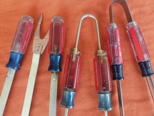

Wonder why some Craftsman's are red and blue and some are clear and blue? I've got a lot of both, even a set a of barbeque tools made with the red and blue handles.
5pcs Vintage Craftsman BBQ Grilling Kitchen Utensil Set Spatula Tongs Fork - Picture 3 of 4
