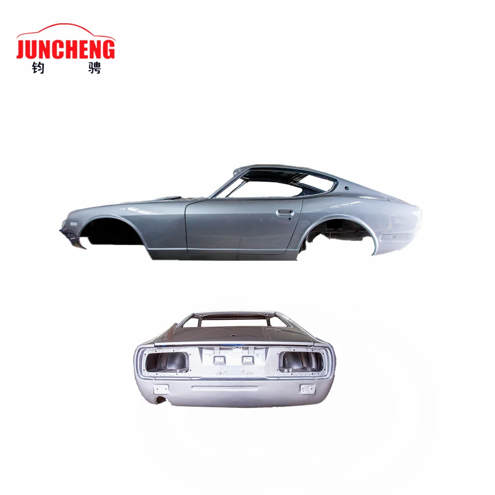

Or you could go this way and order a complete repo body assembly. Lol
www.alibaba.com
No image preview
Aftermarket 1970-1974-1978 Ni-ssan Datsun 240z 260z 280z...
Aftermarket 1970-1974-1978 Ni-ssan Datsun 240z 260z 280z Car Body Shell Cab Car Body Parts,Datsun 240z Car Body Shell - Buy Nissan 240z Car Body Shell nissan 240z Shell nissan 240z Body nissan 240z...

Can you only imagine how jacked up that would be trying to align the drive train.

I don't think you are supposed to put them on a car. I think they are intended to be wall art. 😂
