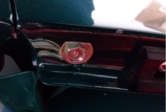

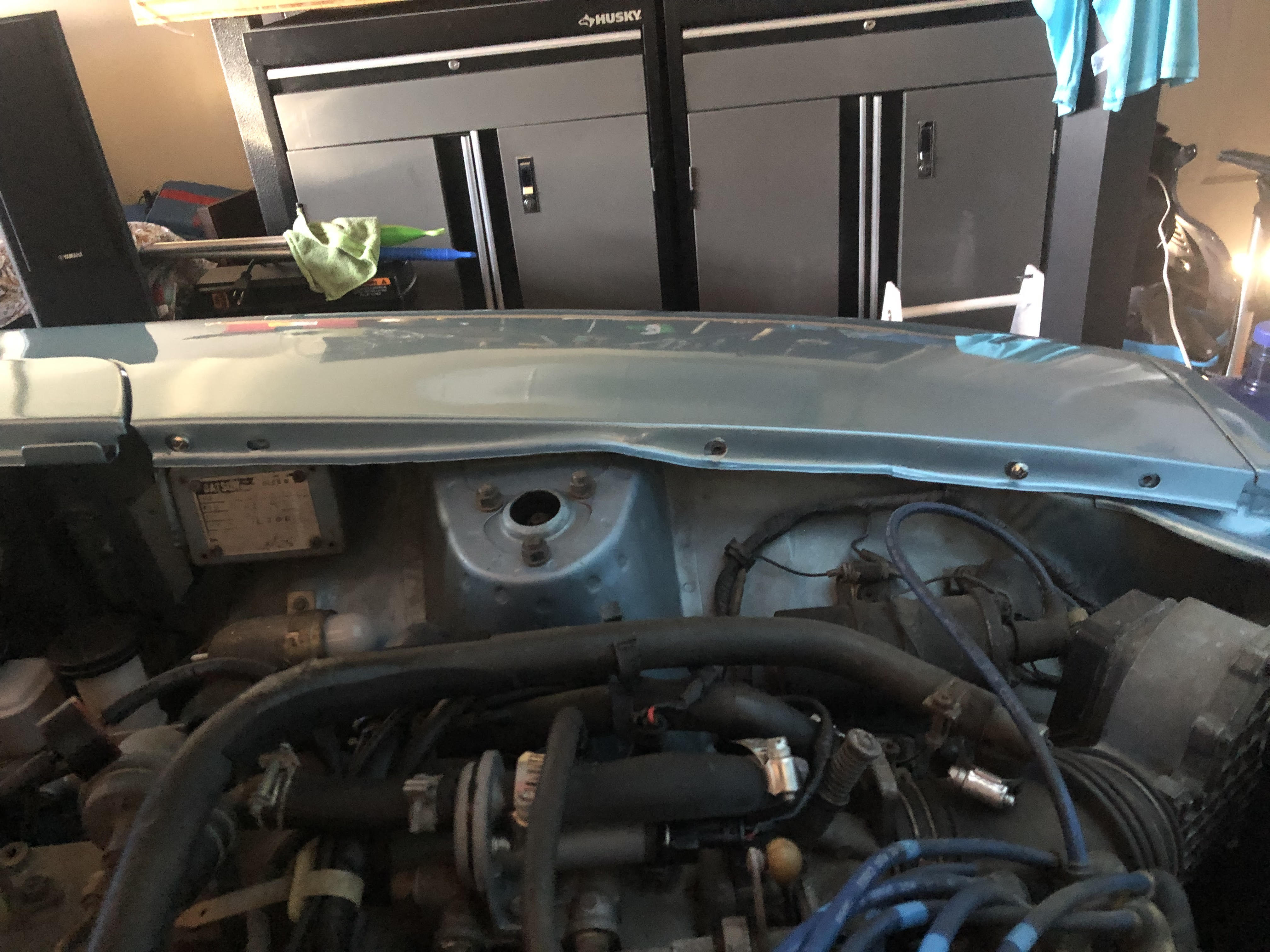

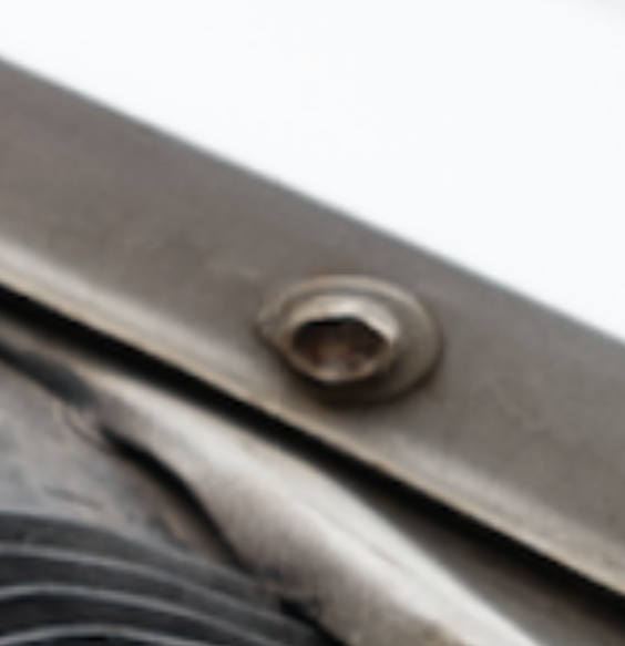

They are the one that look like this. As you go down the bolt row on the fender under the hood section there are these D washers.
The flat part is on the bottom and provides the depth needed so the washers don't stick up above the fenders.
Note Zedsaver shows them with the flat part up. I have always seen them with the flat part down. Now I am not sure of the orientation.

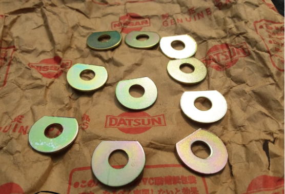

You need D washers here on 3 of the holes each side. 2 per side has those rubber bumpers. I am planning to just use all 5 D washers for now. Also flat side goes on the bottom as there is no space, that's the point for having the D washer here. I have few original ones but they are rusted. These new ones are great quality.

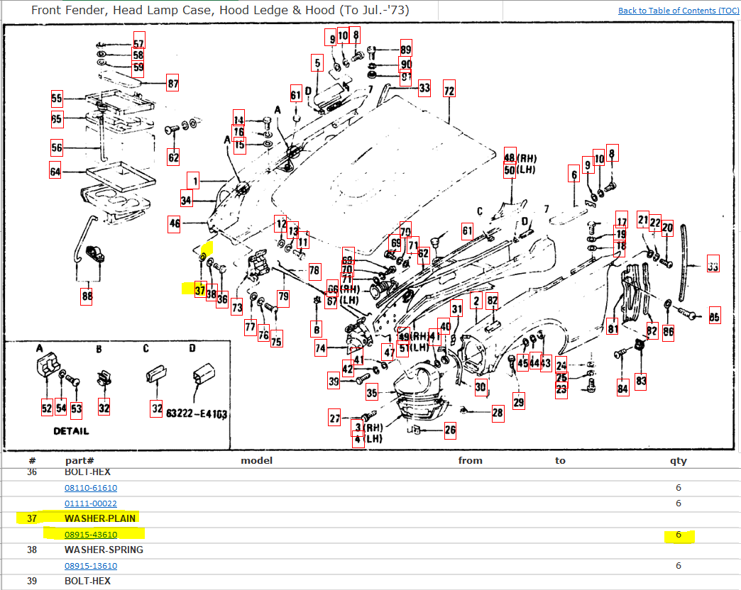

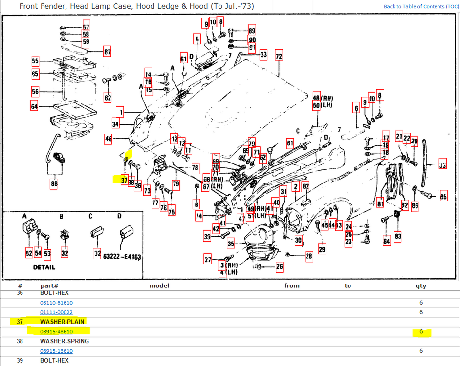

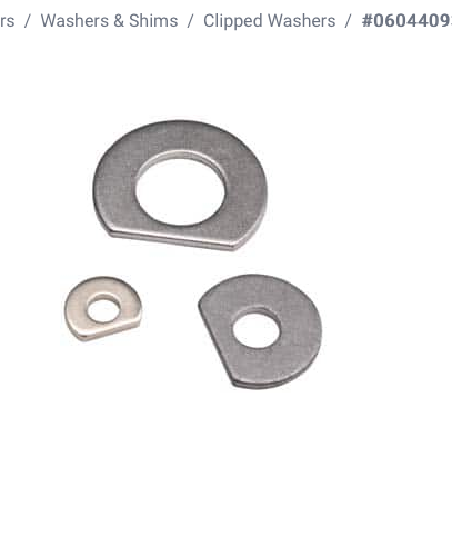

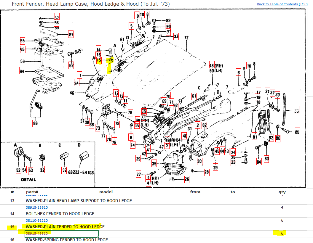

AKA "clipped washers". I don't see them called for in the parts book for fender installation, my guess is that if you find them, they were likely just cut to suit when required.

37 seems to point to the two you need on the inside to attach the headlight housing. Those dont need D washers.
Sorry  I did point to the wrong ones, but the fender to hood ledge uses the same regular flat washer.

Some regular washers might fit. My 77 has all 6 of them flat rusted and I dont have space to fit the regular ones. The McMaster ones work. These ones also fit a bit cheaper. Check your fit: https://www.mscdirect.com/product/details/06772388

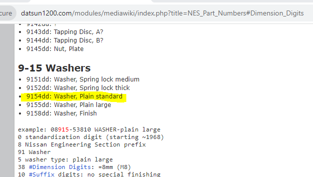

On my car there are some clipped and some not. Just for reference here is how the part number 08915-43610 decodes, the digits defining the washer type are "915-4" which equals "Washer , Plain Standard".

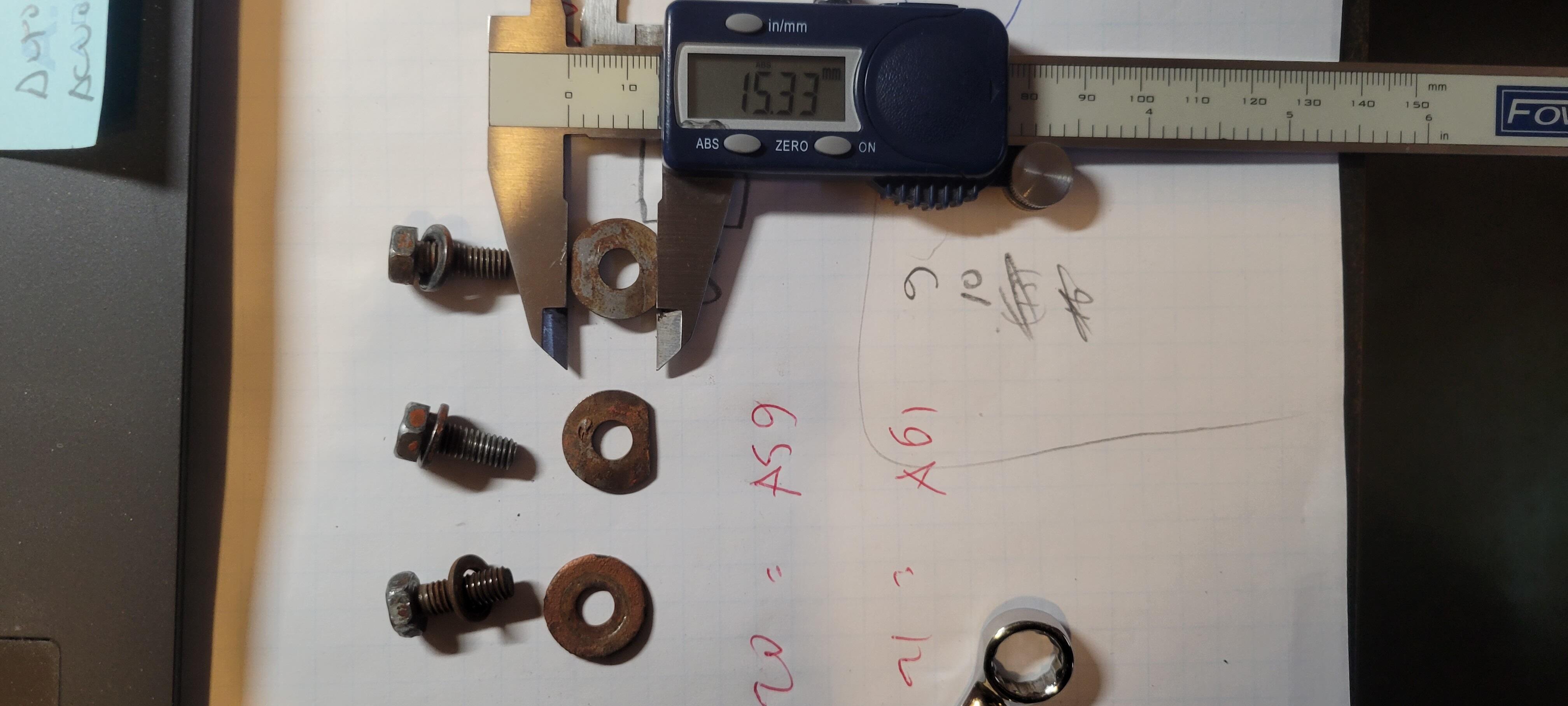

Just for comparison, the ones on my 7/70 measure 17.8mm OD x 6.7mm ID for both the round and D washers. The D measurement is 15.3mm.
