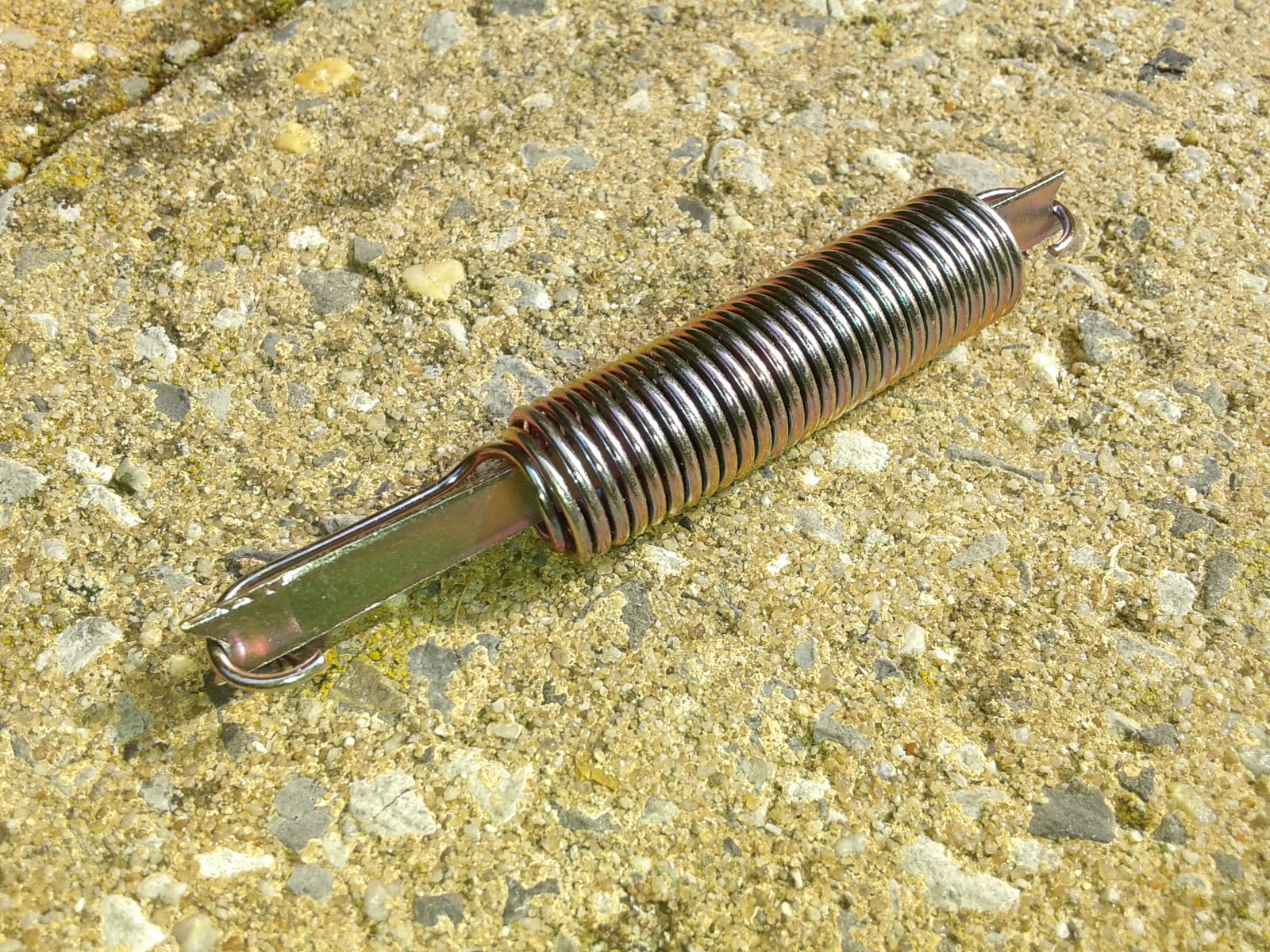

Thanks AK, When i got something rusty that needs a restore i try that trick.. Thanks!  In the past i had trouble with parts that had some old paint on them and when they came back from passifying they where not perfect as they don't take off the paint first .. they just throw it in the tanks to clean and passify them. That ment i had to clean them myself and bring them back again..
And..
Don't forget to put a strip of metal in the springs to get them perfect..
And..
Oooh really love the expanding the spring idea !!!

Thanks for the nice reaction on the spring exspanding idea!  it was my own!! If you don't do that you end up in a year or so with a spring that starts to rust because of the bad passification.
