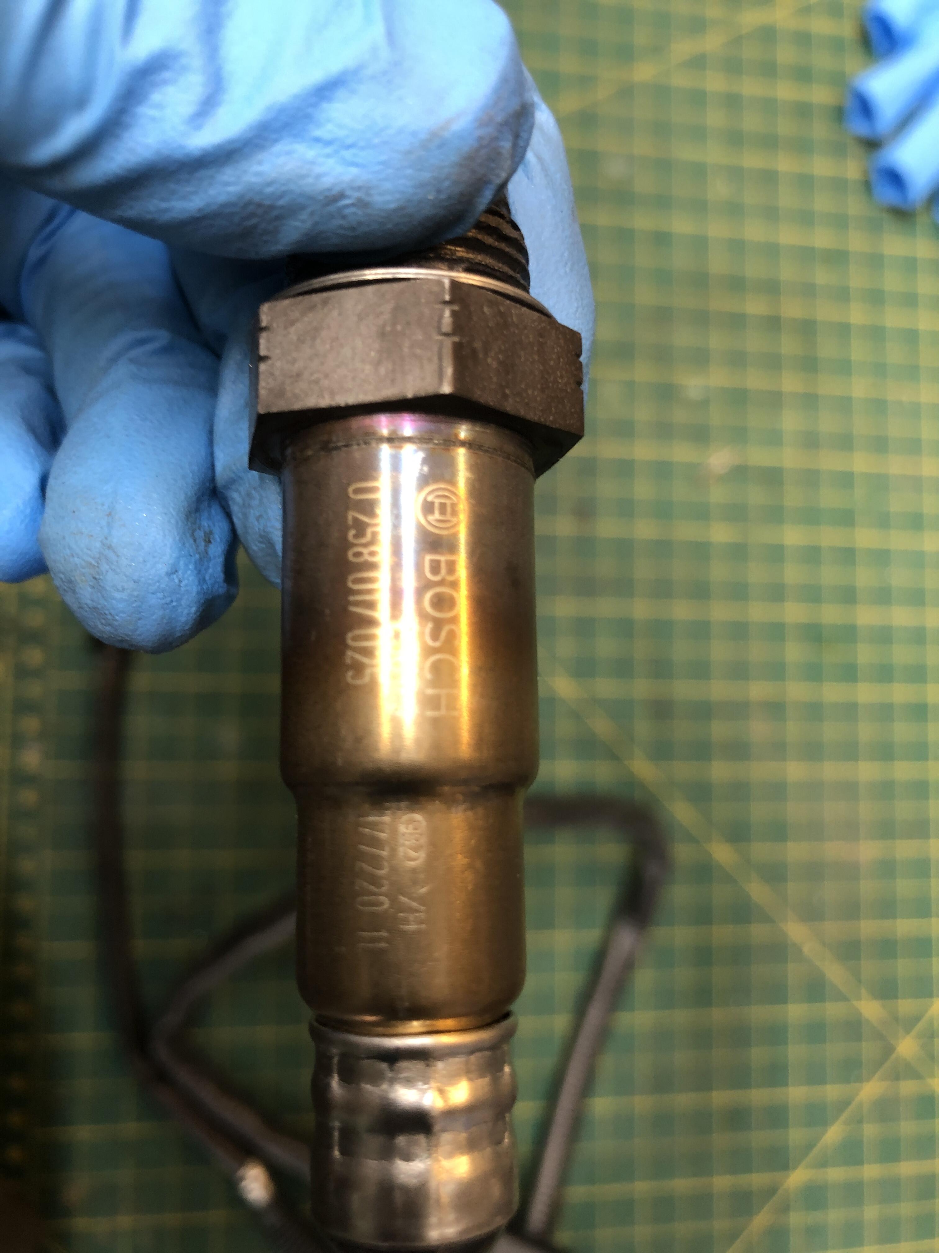

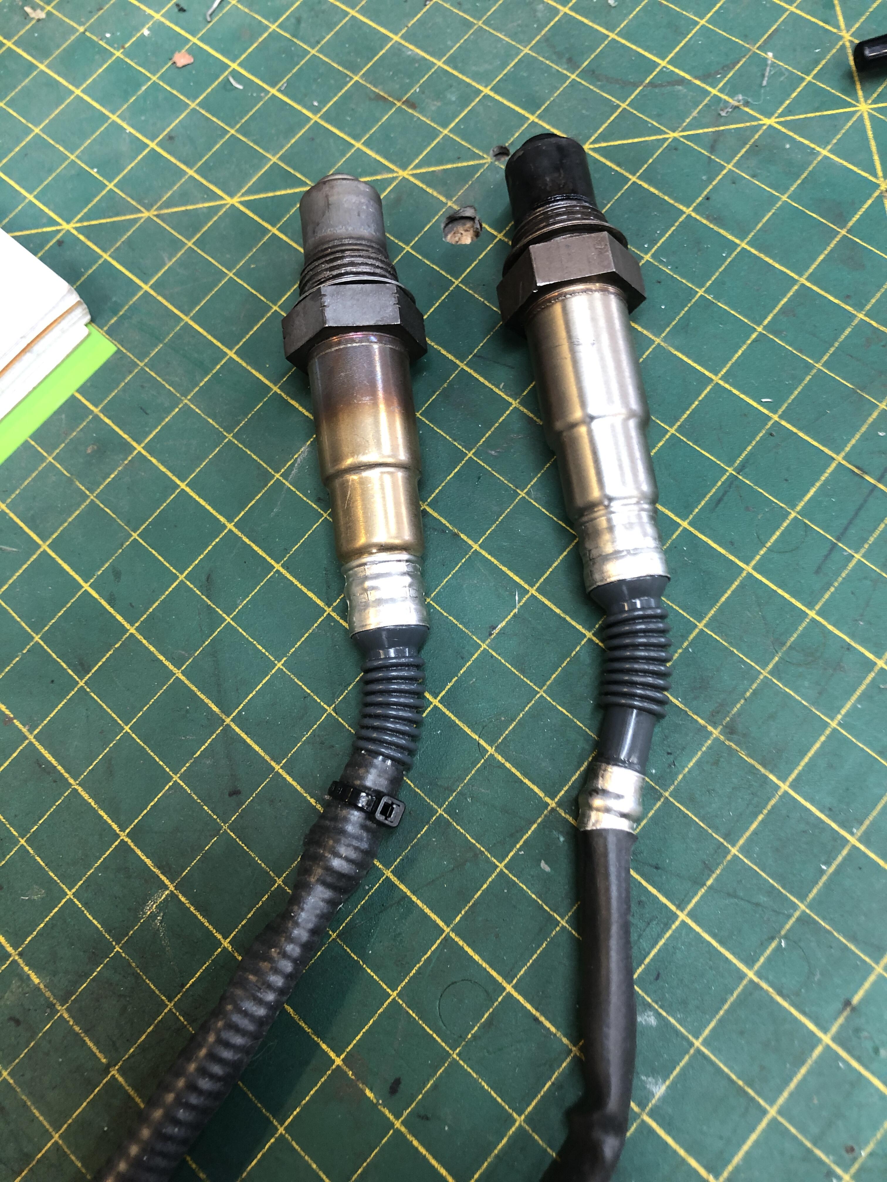

Here are the two business ends. Bosch on the left, fake on the right.
The Bosch sensor has that graduated heat coloring, a zip tii holding the sheath material over the accordion boot.
The fake is shiny polished. And has no markings. The Bosch sensor has the markings you'd expect

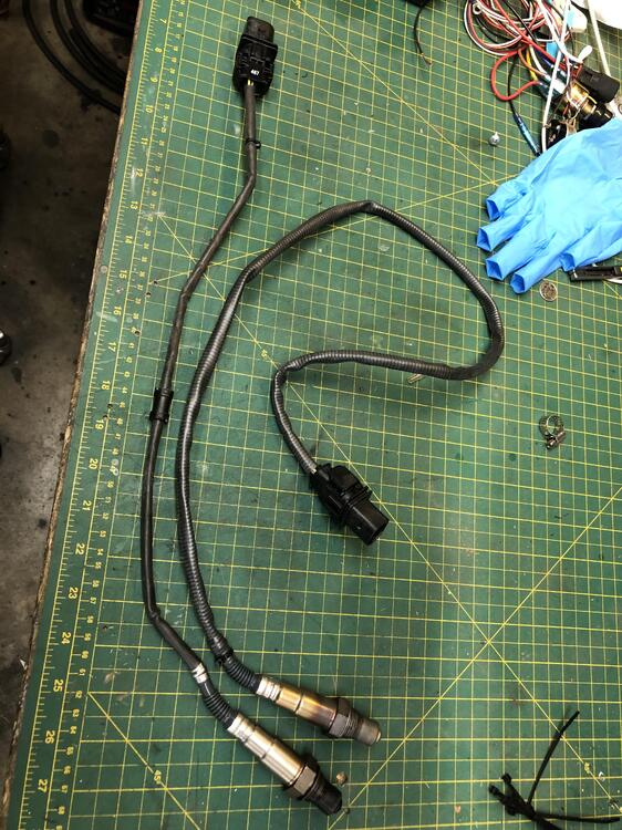

Lastly the wiring length of Bosch sensor is much longer.

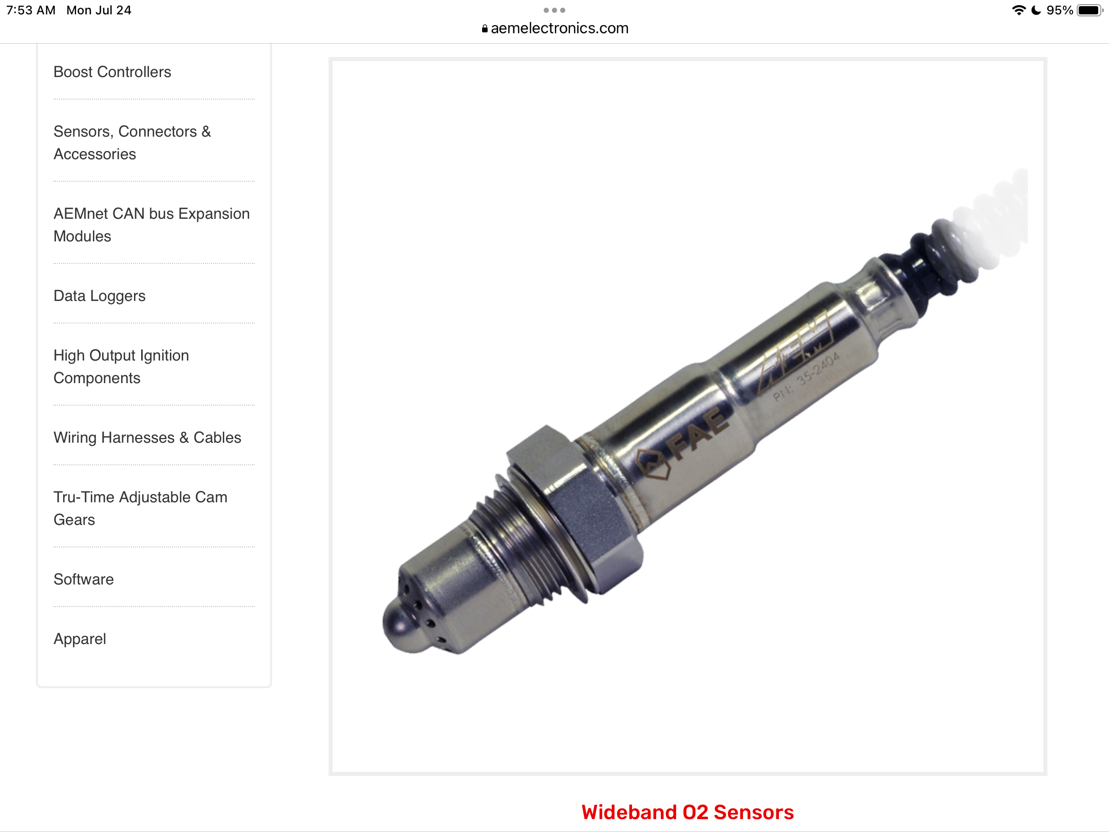

Even their pictures on the amazon page that show various shots of the equipment, shows one with the Bosch sensor, and one with the fake.
During one of my discussions with AEM, they said “whatever is shown on our website is exactly what you get” and they had inconsistent pictures then as well.
Just looking today they show a clearly non-bosch sensor FAE brand, and bosch depending on where you look.
