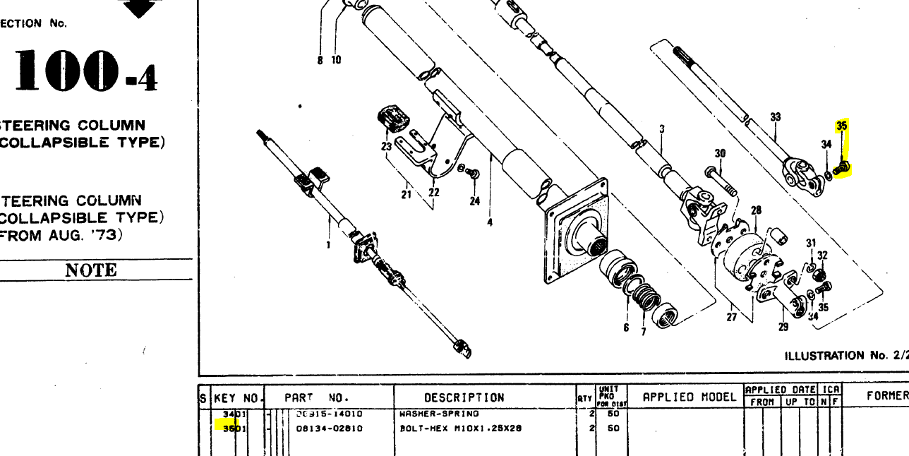

The Nissan parts book shows it as a M10x1.25 x 28mm long, metric fine pitch. To see if it is a shoulder bolt measure the ID of hole in the yoke, if it is10mm then it's not a shoulder bolt.

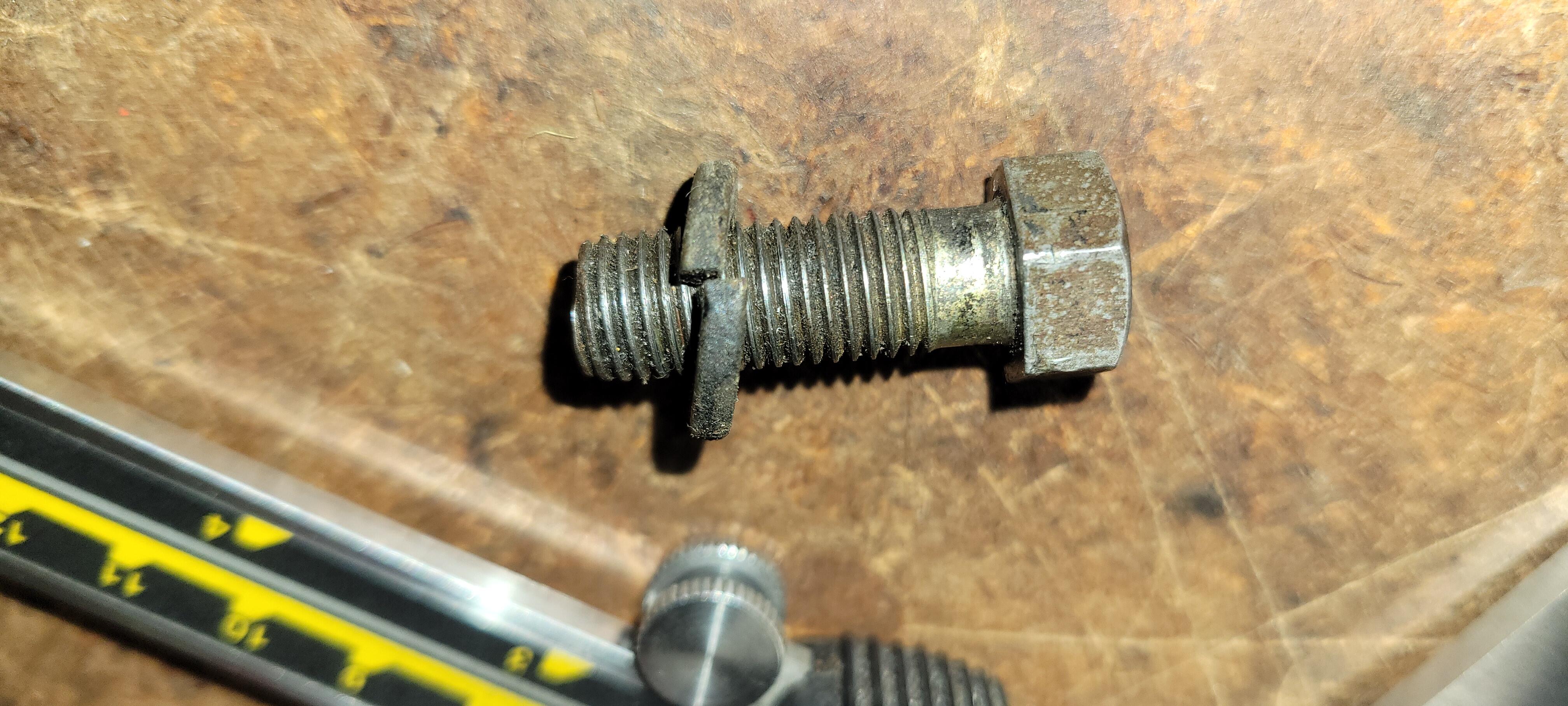

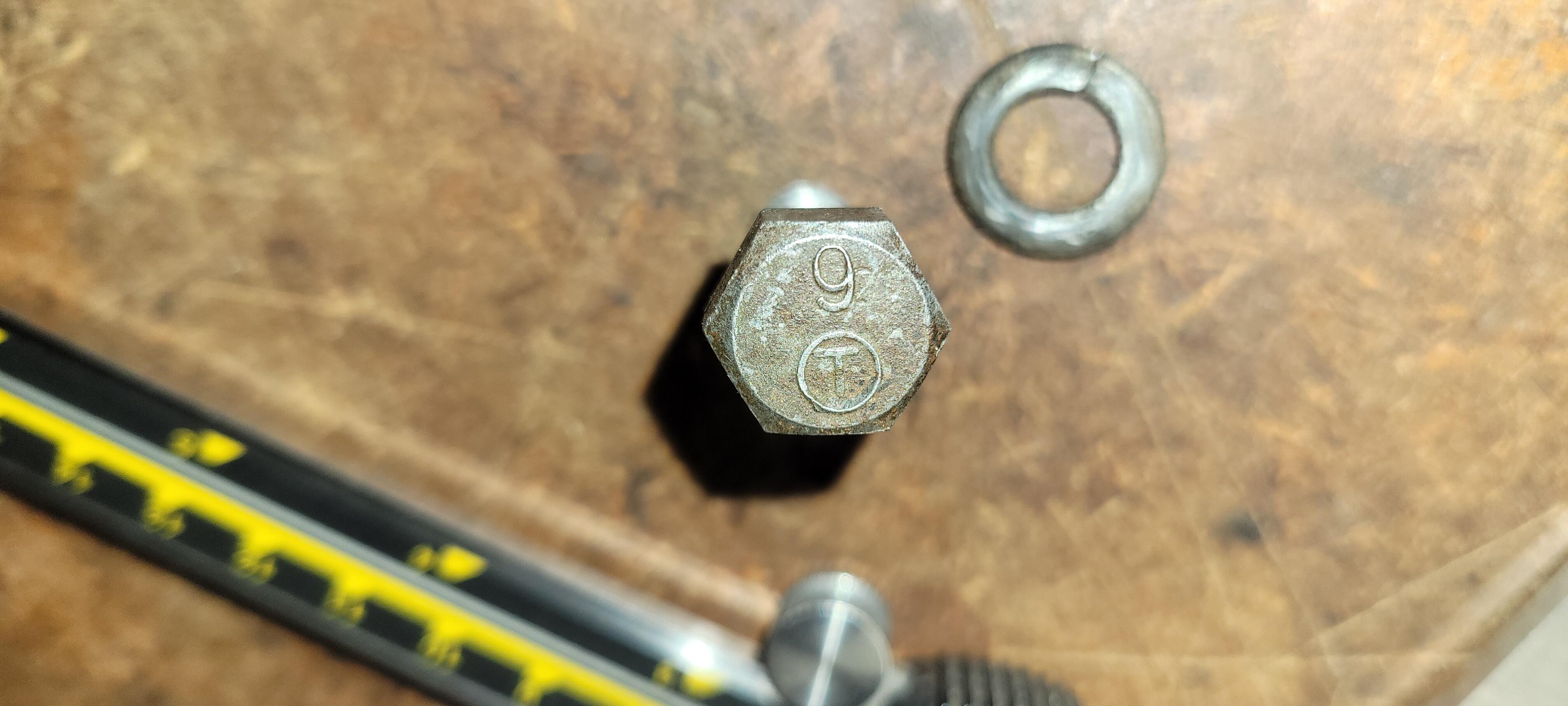

I thought my steering shaft was stored away but it was still under my car, here are a couple of pics. It is a M10x1.25 partially threaded, under head length is 28mm with 22mm thread length and has a number 9 marking on the JIS head, I believe that would cross over to metric DIN class 10.

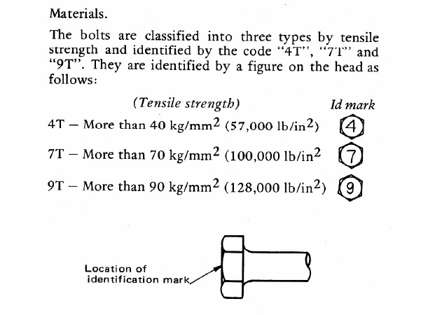

Here is some info about the grade markings on the head of the JIS bolts of that era from the Datsun/Nissan torque spec booklet.
General-Datsun Torque Specifications.pdf
Edited by CanTechZ
Added torque spec info
