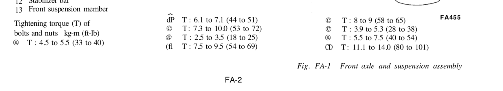

The only thing that I couldn't find a spec on is the torsion rod bushing end nut - I just made them 'snug' - about 4-5 exposed threads outside the nut. Does anyone have a spec for that? I didn't find it in the FSM/Front Suspension section .
Torque spec for the torsion rod end nut - Page FA-2 of the manual says 33 to 40 ft-lbs. Basically, you should compress the rubber to the point where you have bottomed out against the metal sleeve that runs through the center and then torque to hold it there.

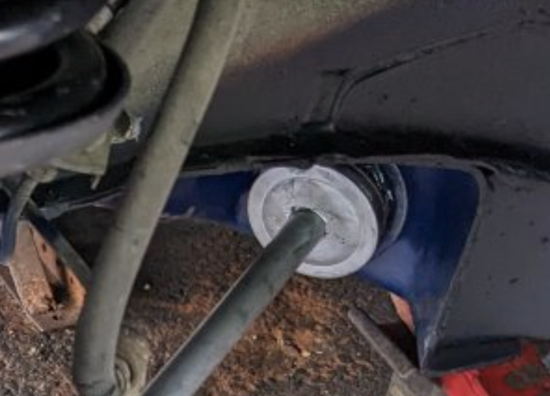

Oh, and not totally sure, but it looks to me like you have the big washers on the torsion rod bushing installed backwards. They should have the convex side towards the rubber. Counter-intuitive, but that's the way they want it.
Should be like this:
Many thanks for the clarification. I do indeed have the conical washers set to 'cup' the bushing, so I will take it apart & properly torque them. Makes sense the bottom it against the sleeve. Hopefully that accounts for my vibrations - I must have excess fore/aft movement as it is.
EDIT - putting it together with the suspension hanging at a pretty acute angle, the bushings don't seem nicely aligned with the seats, so I think I'll wait to torque them when it's on the ground, where the angle is in it's rest state. I think I'll also switch out the forward one for the poly, as you have in your pic.
I tested positive for COvid yesterday, symptoms are pretty harsh this time. Figured I better reply while I have a window of clarity.
Presumably the nut icon labelled A - H are the indicators of torque spec - I didn't get it as the legend at the bottom has gibberish inserted

The issue with the gibberish in the manual... The manuals were scanned to PDF on a flat bed scanner and OCRed (Optical Character Recognition). Not sure why, but the OCR process for the 75 manual (and only the 75 manual) didn't do so well. If you look at the same page FA-2 in the 76 manual everything makes sense.
One last thing I think I see on your pics is that there should be a smaller flat washer on both outside ends of the larger washers. Doesn't look like you have one of those on the forward side of your car. Looks like you have the big domed washer right up against the shoulder on the T/C rod.
