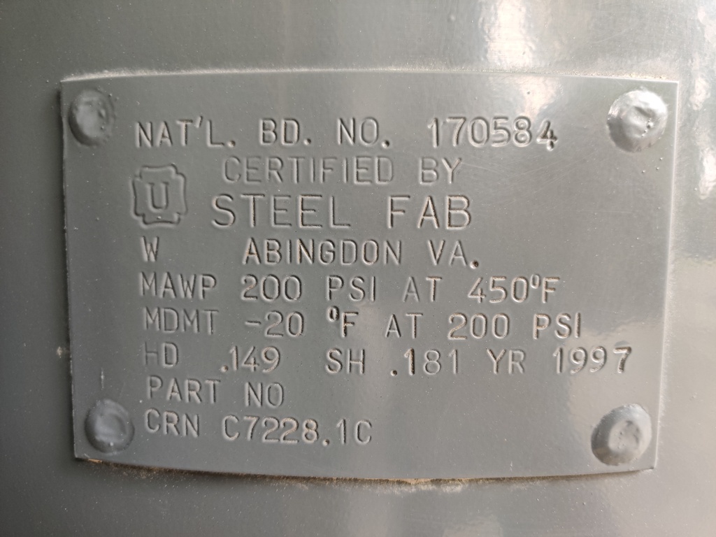

And i sure hope there is a Pres.Max sensor/outlet (of 150psi/10bar or so) on the tank.. as a explosion is not something you want in your workarea!
What's the limit of your tank?
I wouldn't run the higher set points. My first concern is the integrity of the tank. My tank gets drained but not like it should. A ruptured tank is a bomb that you don't want to be around. Also I would expect the higher pressures are harder to achieve. I suspect the compressor efficiency is not a linear function

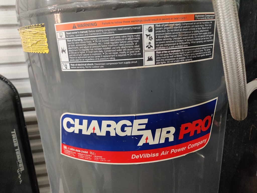

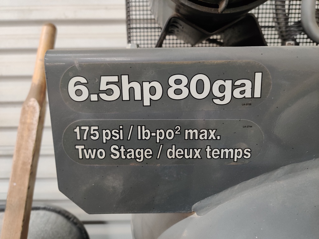

Pictures of my compressor:
IMG_20230407_113456.jpg  IMG_20230407_113518.jpg  IMG_20230407_121940.jpg55
I was able to adjust the new switch to kick in around 120 and turn of at about 155, just as before.
Nice big compressor!  Psi i do understand as it is pounds per square inch.. something like we have kg/cm2. But what is: lb-po2 ????  I googled it but i get some explanation about oxigen in blood?
So what does lb-po2 mean? anyone?
Another question would be, how can a compressor say it's a 2 stage, when it has only .. appears to have only 1 cylinder?  :ph34r:
Most 2 stage compressors have more cylinders yours could have 2 cylinders parallel i don't know.. here a example of a 2 stage compressor. 2 cyl. pump into a third and make some high compressed air..
5 HP TWO STAGE COMPRESSOR PUMP | Belt Driven Compressors | Air ...
The top and right cylinder pump into the left cylinder. Also.. to cool the compressed air the lines are ribbed to cool.
Good questions.  I see the label has "deux temps".  I think that is French.  A Google search seems to indicate the french use lb-po^2.  It is equivalent to psi.
My compressor pump is an "inline 2", with the cylinders side by side. One is smaller than the other.  The larger one is the low pressure part of the pump, and the smaller one is the high pressure part.  Looking at the paperwork I have for it, I see I bought it on 11/01/1997 for $709.77.  🙂  I bought my glass bead cabinet at the same time - just after I bought my first garage (with a house attached hahaha).  It was my first expensive tool purchase.  I was 28...
