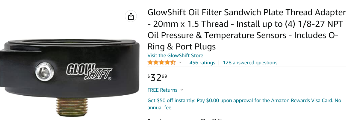

There's always a way to not get things done.  It was a concept idea.  You could poke around in the port hole too.  Ponder why the gauge needle would move so rapidly when it's just sitting there on the small channel to the oil filter, which is like a big buffer pool of oil.
Anyway, just offering ideas about what I would do.
I really hate how Google or eBay or whoever adds so much extra crap to eBay and Amazon links.  Probably contains all of my recent browsing history, in code.
Here's a picture instead.
