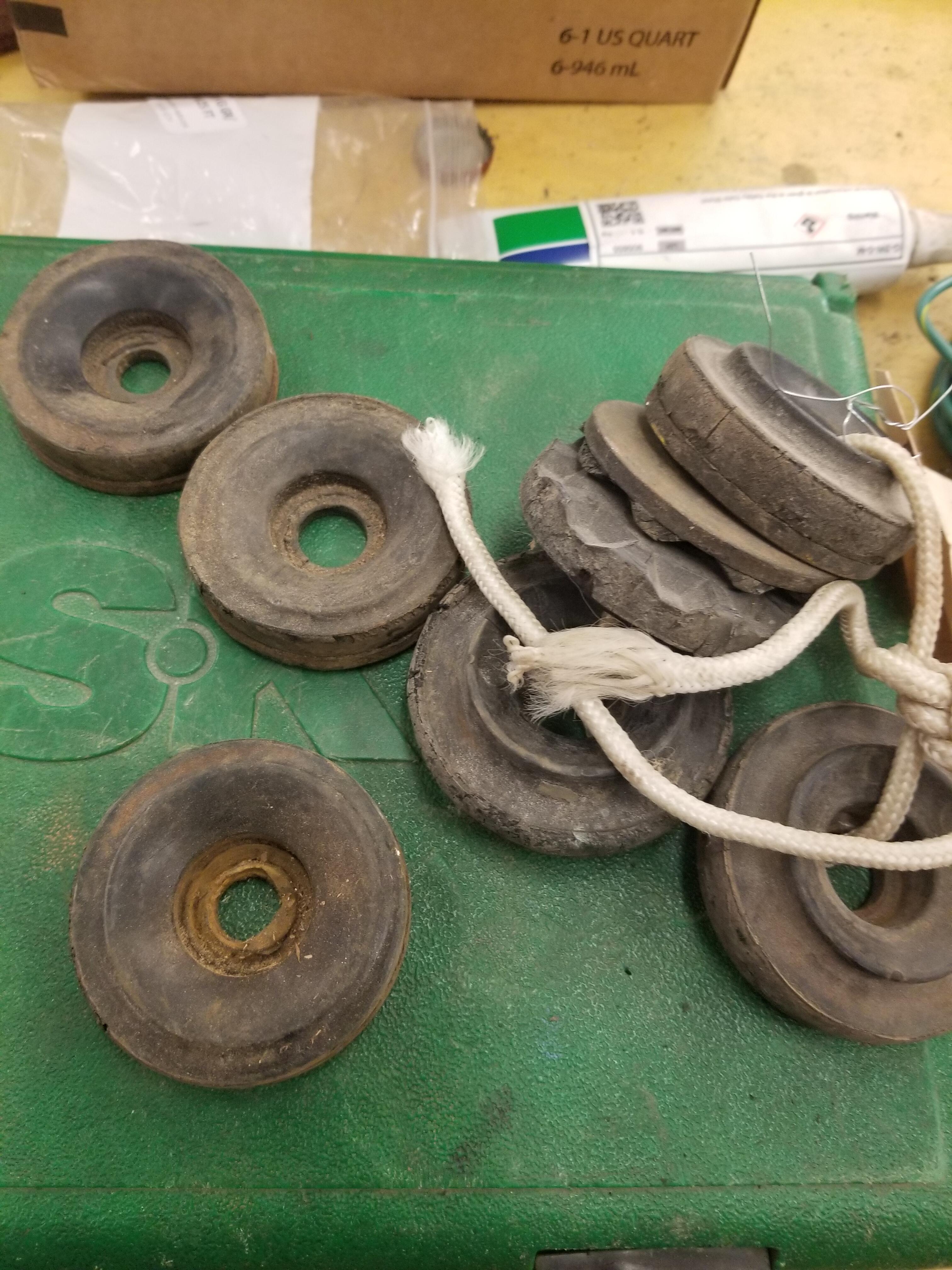

I have these. Are any of these correct? Some of them are pretty hard
I believe these two (blue arrows) are the right ones.  The upper ones have larger diameter holes than the lower ones.  The one in the top left corner of your pic clearly has a smaller diameter hole.  Can you measure the diameter of the hole in those 3?  If those two with the blue arrows have the large hole, they are what I need.  Doesn't matter if they are hard.
Here are the ones I currently have.  The third one I found with parts that came with my car is another lower one.  The ones in grey primer are the serrated ones.
