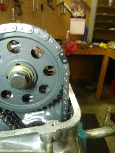

Shade "woody shrub" way is push the handle of a big screwdriver down between the chain. It should be hard to push down all the way if the tensioner is right. Another way is buy a cheap bore scope that works with your smartphone and have a look.
Sometimes an exhaust leak can sound mechanical.

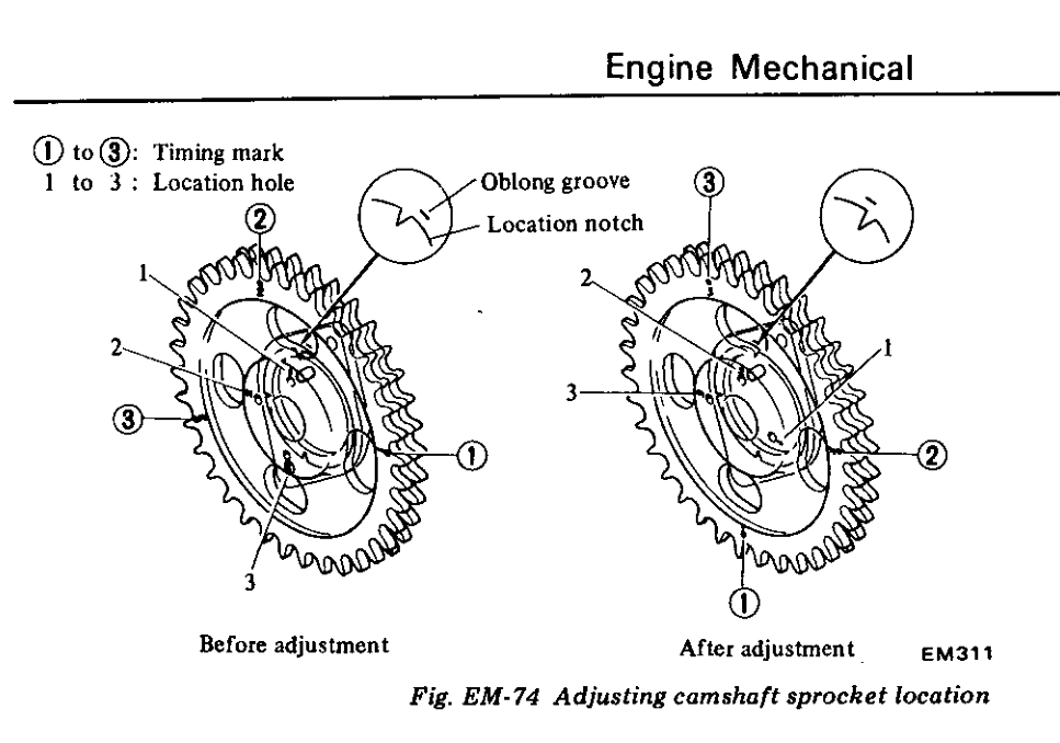

Nissan actually provided a way to monitor chain wear.  The notch and groove.  Some aftermarket sprockets don't have the notch though.
Edited by Zed Head

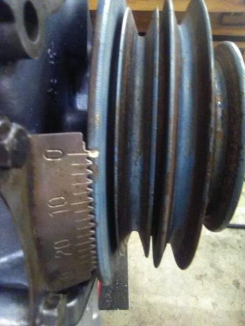

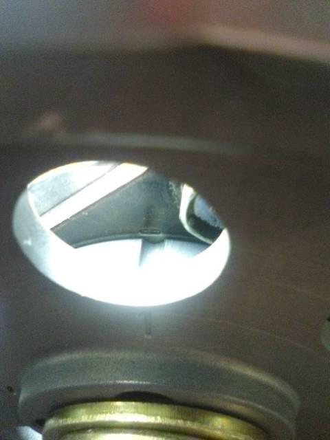

So I pulled the valve cover and all of the lash pads are in place, and I moved the camshaft both ways and there really wasn’t any play. As for the notch on the sprocket, I was looking at that but I’m having difficulty setting it to tdc. I can get both valves on cylinder 1 to be closed and have the bright link on #2, but I have an issue with my dampener. There are quite a few marks on the dampener and I can’t seem to get any of them set at 0° with the valves and bright link set correctly. Is there some other way to set tdc?
These dampeners are notorious for having the rubber portion deteriorate over time causing all sorts of issues observing timing.  You should be able to turn the engine over several times to get the zero mark on the dampener to line up with the cam sprocket markings and have the bright link set on whatever number(usually 1) and have the cam lobes pointing to the "bunny ear" position.  A screwdriver or the oil dip stick lightly inserted in cyl. no. 1 will also give you a visual about TDC, just make sure it's on the compression stroke.
Edited by Reptoid Overlords
@Reptoid Overlords The previous owner of my z put on an aftermarket harmonic dampener, so there are marks on it but not sure which one to use. It has 5 grooves I believe and two red paint marker marks. I can try and keep turning it over to see if it lines up but I was spinning it over quite a bit and couldn't get any of them to line up. The closest they got was the first mark or groove almost lined up with the bottom of the plate that has the degrees marked on it. I'll try and use a screw driver but how would I know if it's exactly tdc? If I'm a little off it can move the notch and not give a good representation of if I need to move my cam.
