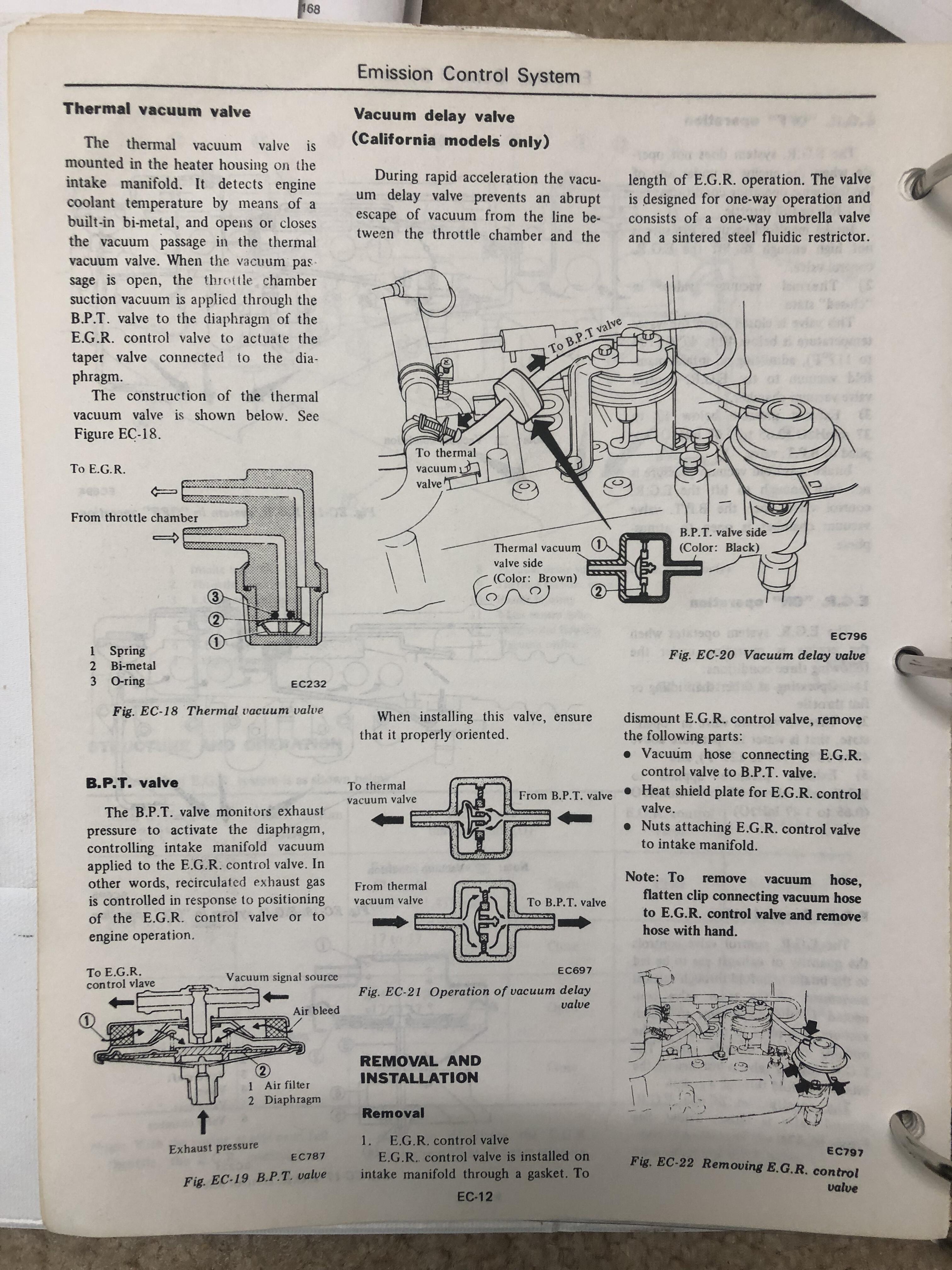

Has anyone tried this part? or any other alternative? I think there is a similar GM valve as well which I can share later (cannot find it at the moment...)

Not replacing anything yet but just inquiring if anyone has used this. There is a similar valve on the 280z correct?
21 minutes ago, SteveJ said:
What valve on the 280Z are you referring to?  Do you even know what a vacuum delay valve is for?
Here u go, CA models only. Most cars I have seen here has bypassed this. Goes between thermal vacuum valve and BPT valve.

My original do not hold pressure one way so I think it is bad. Seems like this is same part as the one u are referencing.
That sounds like it's working perfectly.
It's supposed to be easy to draw vacuum through in one direction, and possible (but not easy) to draw vacuum through in the other direction.
I meant it blows same amount of air both directions. It is supposed to be one-way and i did the water test as well.
OK, when you put it that way, it sounds like it's not working correctly. In that case, I don't have any concrete suggestions about what to use as a replacement, but I would like to talk some about the "end of the story" and what your end goal is.
So... I see you are in California, and are subject to heightened scrutiny of your emissions system. I'm assuming that's why you can't just remove that delay valve completely (as you've seen on most other cars). But your (malfunctioning) valve that passes air easily in both directions is functionally the same thing as removing it completely.
I'm not in CA and are therefore not that familiar with their emissions regulation details. Are you telling me that the guys at the inspection station actually TEST that valve for functionality? I mean, I could be easily convinced they compare your engine to a year appropriate picture and look for all applicable emissions equipment, but do they actually start taking tubes off and testing for functionality?
They do test EGR functionality according to what I read, though I didn't find the procedure in my quick search.
