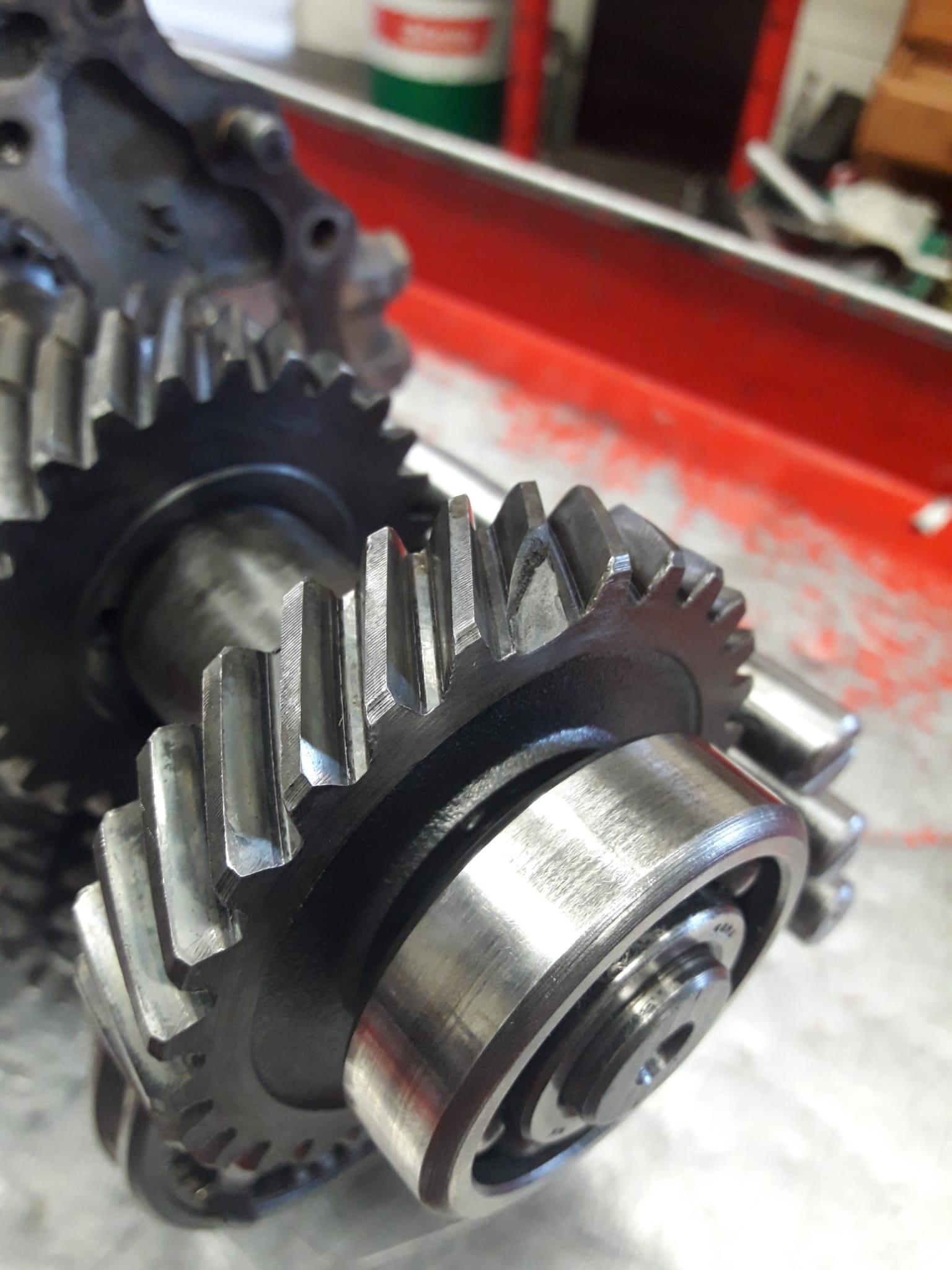

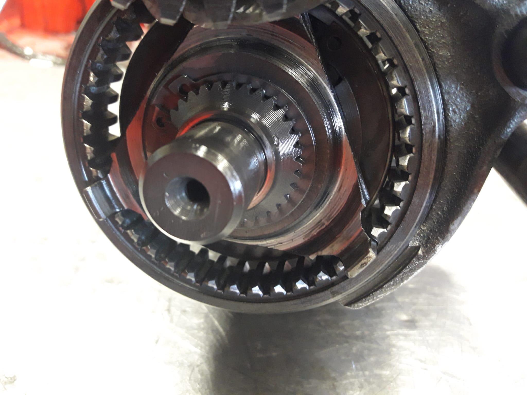

That's for the fs5w... Totally different gears and synchros. This one uses the Porsche type synchro if i am correct.
This is the non us market a type 5 speed... There is also the more common b type
I have a new second gear for a FS5C71B. Cheap.
What gearbox is yours?
As those gearboxes only came in early european and i guess asian models, there are just few.. Maybe @kats can help?
I've had a 1972 240z orig. Dutch import and that one already had the Fs5c71b  not the a..
I never opened a Z-car gearbox.. I'm not going in there haha.. why do you think i stocked up on gearboxes? 😉
